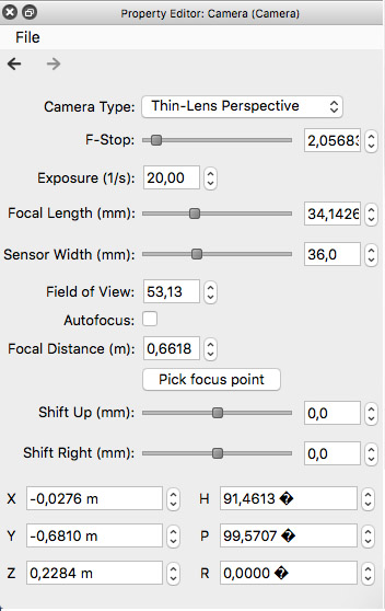

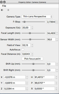

Hi
@Zalevskiy, Thank you
Depth of field with these parameters.

Good work contegufo!
You mind trying this settings on the marked areas?
F-stop: 2.1
Exp: 20
(ISO:200)
Focal distance: 0,10m or autofocus.
F-stop: 2.1
Exp: 20
(ISO:200)

With those parameters I have a very narrow field.
Try it yourself.
Try it yourself.

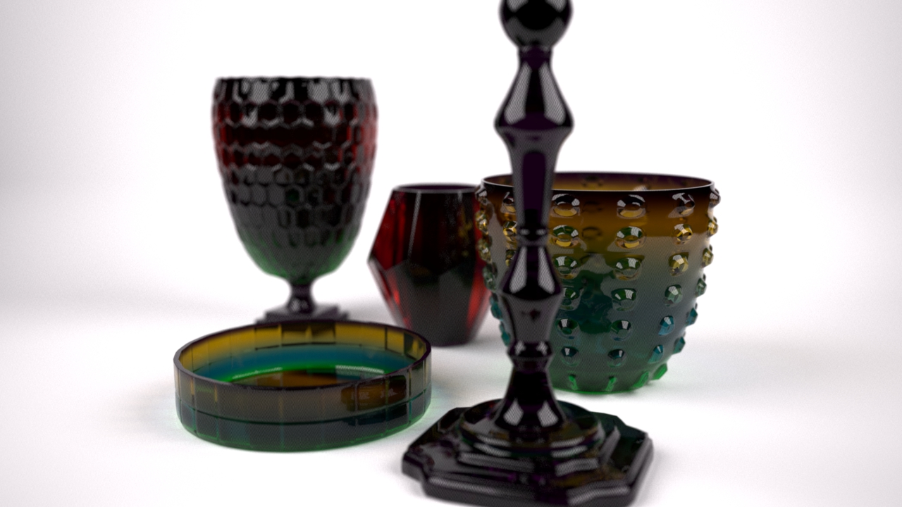

Hi
I redid the scene, now in centimeters, changing slightly the position of the models.
I changed the light areas now two large one on the right and a 45 ° angled left.

I think it's better contegufo, well done! Nice DOF too on the first image.
