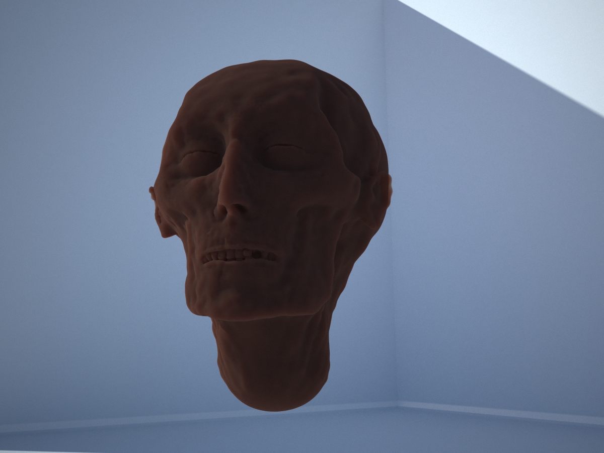

i rendered a new image, mainly to see the shader in detail.
now the absorption is somewhat higher.
(click to see "highres"-version)
now the ear problem is visible a lot better.
Post by OnoSendai » Thu Feb 15, 2007 1:51 am
The problem with the ear is that the scattering coefficients are not high enough, so light can pass straight thru without changing direction.
So increase the scattering coefficients.
Unfortunately this slows down the convergence speed :P

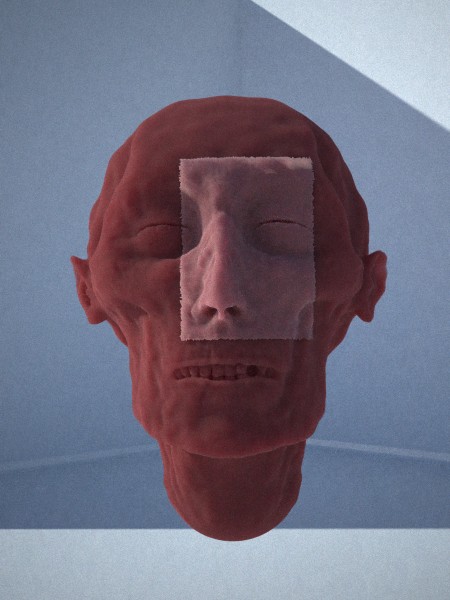

testing a two layer setup. cut out a small part of the face and used it as "testlayer".
will show a better render and the .xml tomorrow

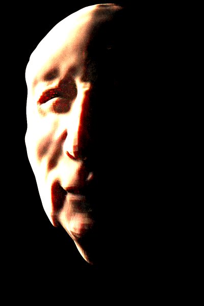

new test, this time a lightning test, to show the colors somehow better.
sorry, didn´t have much time, so i had to stop rendering after short time.
i think i am getting closer.
there is a question though:
when i activate glossy reflection and set ior to 1.4, the material tends to get very dark (even with bright surroundings) why is that? and is there a possibility to control the opacity of the speculars?

Isigrim wrote:when i activate glossy reflection and set ior to 1.4, the material tends to get very dark (even with bright surroundings) why is that?
same problem here. :P
