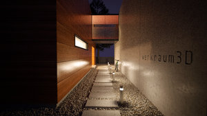

First try with SkIndigo
Don't use a glossy transparent transmitter for that situation. While that is probably the most intuitive selection as it matches the material most closely, it also slows down the render process.
Unless you want to make a close- up shot of the lamp I'd use a diffuse transmitter.

Re: First try with SkIndigo
Do you mean by "transmitter" the glass surrounding the bulb (which uses a diffuse material)? Or the emitter itself?
How thick is that sourrounding cylinder? It is not clear visible in that picture.lape wrote:attached is a picture of the lamp. Inside bulb with emitter (cylinder), outside cylinder with glass material.
This one, I think.lape wrote:Do you mean by "transmitter" the glass surrounding the bulb (which uses a diffuse material)?
thickness of glass is 5mm. I will try a different material for the glass.

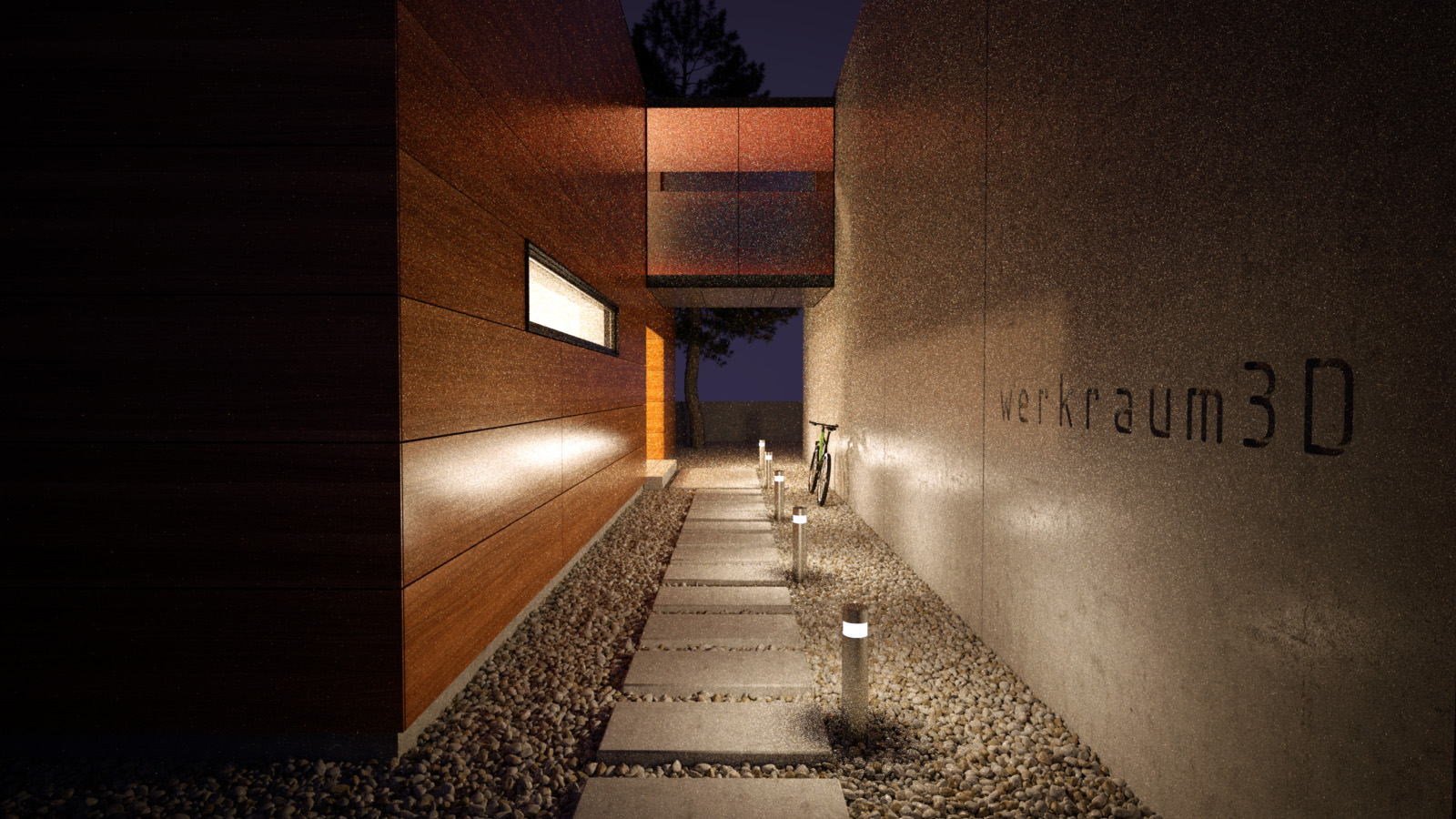

Here is my try for the nightscene after 11h of rendering, about 8000spp.
-path tracing
-glass acceleration
looks quite bad with all these fireflies...
-path tracing
-glass acceleration
Have you tried MLT ? Like Pibuz I would recommend bidirectional with MLT over single path tracing for this scene. It's different but quite an all-round in itself.
You can reduce fireflies by using an higher supersample factor, but again MLT will help a lot with that.
Ok, bidir with MLT started and I get 7k/s! this is so damn slow... after 30min 11spp. This will need days to get free of noise!
All I want to achieve is a nightscene with some warm light inside the building. Perhaps the material of then windows panes is the wrong one? I used the normal glass for the window (specular) by hitting assign preset. I saw the attached picture in the forum made by Jeff, how is this done? Glass material? Render method? Environment? question upon questions....

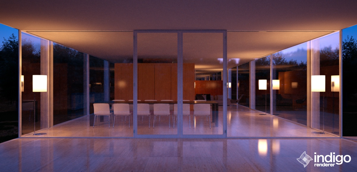

Moinsen Lape,
good old Farnsworth House
Regarding the render modes MLT has his strengths, but this scene should be best with BiDir Pathtracing with GlassAcceleration I think.
In most scenarios you'll end up using pure PT (mostly with GPU turned on) and BiDir PT.
Pure PT is best on Studio setups and outdoor scenarios where Light doesn't bounce trillions of times inside some buildings etc., BiDir PT helps connecting more complicated light Paths like Caustics.
In This case all the light from the inner of the house are caustics, not fancy, but light going through a medium and getting some directional changes...
To optimice this scene further, take care that your light emitters inside the lamps are as big as possible and have as few polygones as possible.
Avoide pure white colors (chairs) and keep RGB range at max of 204 (80%) also for colors since everything above is unrealistic and also reflects light so much that calculation needs longer.
Using BiDir mode, you raise its effectiveness by keeping the scene "small", by deactivating objects and areas not relevant to your rendering.
Its really nice to see somebody new here who is already advanced in 3D!
Welcome, keep showing your stuff and asking questions

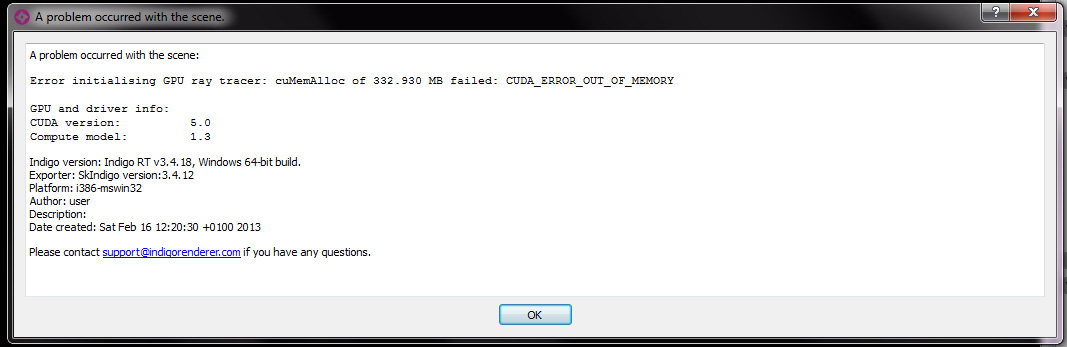

Hi Zoom-B,
thank you for your kind words
I will try to follow your advices. But regarding gpu acceleration, I get an error when I activate it, see attached. What happens here?
