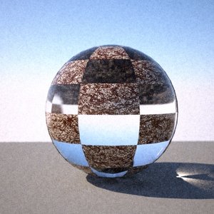

By the way, instead of duplicating the fractal texture you can plug it into various ramp textures as i described it to $oup by the end of the post.
That's to save the hassle to tweak n textures for consistency. Ramp textures will sort of act as instancers for the fractal texture. Once you've set one, you can save its presets in order to apply them to the further instancing ramps you'll need.

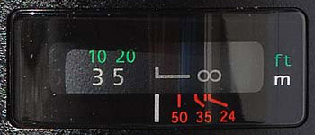

I'm trying to make a material for a little screen on the lens, and while it looks fine in the view, I'm not going anywhere in the render
As you can see in the reference, it's a piece of glass with black textured borders.
I tried a layered shader without much success, and with a transmittance layer on a specular I get the following:

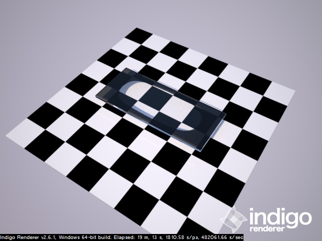

1. create a cube and size it accordingly.
2. plug the texture representing the frame alone as transmittance layer. Black would be opaque so you'll need a dark grey.
3. copy the place2dTexture AE sheet or freeze the AE on it, we'll need to do some tweaks while the cube will be selected.
4. In a row, select the mesh, open the UV Texture Editor for visual control and change the texture placement so that at the end, only the top face of the cube will be mapped. Here are the supposed settings to tweak in the place2dTexture on a default cube:
coverage UV: 0.25 0.25
translate frame: 0.375 0.250
The result should be similar to the linked image. The five other faces are mapless.
For the labels:
1. duplicate/extract the top face of the cube or create a plane from scratch
2. position it over the masked face.
Important note: the distance between the two surfaces must be above 0.2 millimeter. Let me know if that's not enough.
3. create a phong, a layeredShader.
4. plug the phong into the layeredShader. Assign the layeredShader to the plane.
Select the layeredShhader and open the Indigo Editor. The materials transparencies are listed there !
5. set the labels mask as transparency for the phong. As a consequence of clipping, the color map could be done by a kid
You can blur and noise the clip map for use as bump.
Here are the main lines, hope it helps.
For the labels:

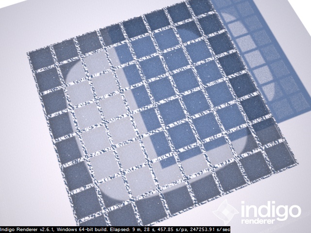

Alleluia!

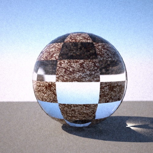

I dunno what I had wrong with my previous tests, but layered shader actually works
No need for transmittance for this one apparently, sorry for the wrong suggestion Btw is it just me or Indigo can't handle dof in refractions? I won't do horri-ball renders next time I promise

However this duplicate plane technique for the labels sounds quite biased for an unbiased renderer, and I think I'll try some other ways around till it works without altering the modeling
Seriously, using a similar technique than I described, you can put the frame in the down face of the cube, and a blend map on the top face. This way you should have a pane of glass with a frame below and paints over, like it is for real (crossing fingers on wood) !
Okay I tested this and it works, with reserves on transmitted light. Glass Acceleration looses its efficacity with blends it seems. Linked image uses bidir alone.

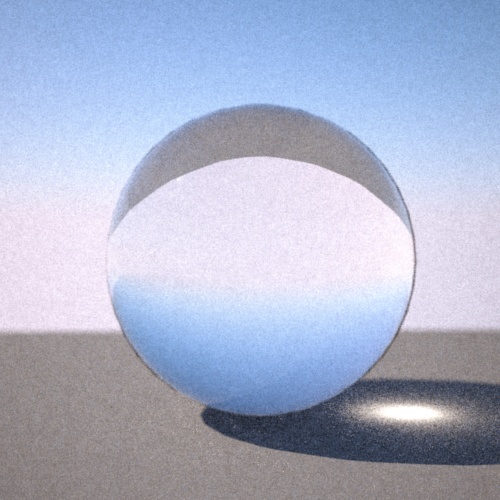

Glad you got blend to work ! Yes you need to use the transmittance layer for the frame or it will have to be opaque. It is semi transparent in my test render (though dark).
Horri-balls have this property to stretch the distances, I'm sure dof is here only that the ball has a much larger optical scope than the camera (if that's an explanation).

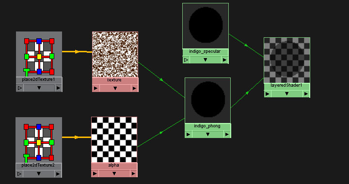

here's the shading network I used.

And with the layered shader I can have transparency as well with a white/grey checker apparently
Ah yeah you're right of course, the ball just act as a lens indeed stupid meCTZn wrote:Horri-balls have this property to stretch the distances
Interesting stuff on your shading network. If I don't use it for that screen, I'm saving these good ideas for later

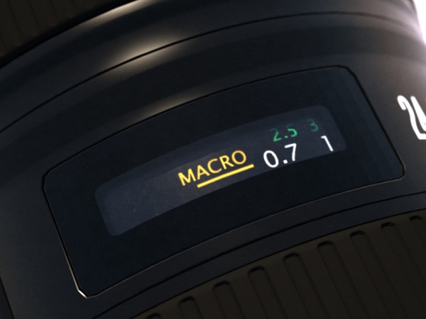

Re: Canon 5D Mk II - Maya to Indigo

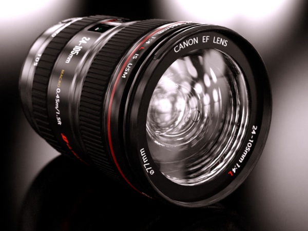

Ok first test with Hdr studio setup.
Now I need to start tweaking those glass materials
(And correct overlapping and labels reflections)

I am not sure that the exr map is making justice to your work, a more realistic studio setup could be more sexy don't you think ?

Yes I do
I just picked a random one with a bunch of highlights, to try to see clearly the glass reflections before setting some different indexes or colored coatings.
Final render shall be more "subtle" indeed
