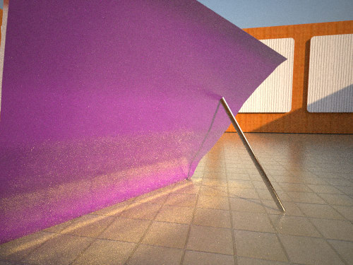

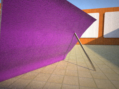

playing around with BbB's scratch map - cool
used it on both bump and exponent - looks hyper real!
Although I didn't let them render that long, so would look even better with more details and better shading if I let it cook for more
for some reason anytime you use a light like that to give a flash type look, it looks a lot like a real photo, but use normal lights or sunlight and it doesn't quite look as good...
nice - I might turn this into a proper final render image

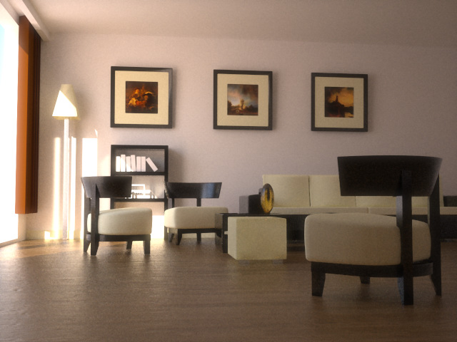

I rendered that room pic with exit portal in my Render modes thread a bit more and this is the Bidrectional MLT version after a few more hours, probably needs another 5 hours to really clean up on my slow PC
http://www.indigorenderer.com/joomla/fo ... 0407#28608
Tone mapped in Voilet, and added some bloom, also tried out median noise reduction filter which does an amazing job of killing those spots on and around the diffuse transmitter cushion - but sure kills the detail and sharpness ala Maxwell and Fry.....
Hopefully Ono can fix diffuse transmitters so they don't do this. You can see the legs of the cushion transmit through the material
Honestly I really think Maxwell does a filter like this when using it's main render mode, as the preview mode is sharper and has some spots...

YES this image deserves to be rendered to the end of noise, really beautyfull !
Now I have a question: is that really possible to have the same output using two different tonemapping methods, furthermore using one wich is linear and the other not ? I have no explication on what I'm seeing right now... lack of experience from my part for sure.
Should I repeat that ? Yeah: beautyfull images !
But, what I mean is that they are identical in color ranges, I wasn't expecting that at all !!! Are you sure that they are not both Reinhard ? At least that's what I'm wondering...
Edit: well, I've done some tests directly with Indigo (having doubts on Violet reliability), and indeed you can get pretty similar results. I didn't know that, I used linear the first time for that last wip I did recently.
No wonder why you couldn't choose one, apart noise removal I see no signicative difference !
well yeah they are kinda similar, but it's down to the settings this scene imposes on you, so there isn't much range to adjust anyway. The Reinhart version is a little lighter in the right side of the pic
I did set burn for Reinhart much lower than I usually would, 3 in this case which burns out part of the image, and makes it look similar Linear in that respect. I was gonna use a burn of 4 which would make it look less contrasty and more "grey"
Voilet should be the same as the tone mapping in Indigo and the Indigo Tonemapper anyway
Except you do have more options in Voilet. There are probably other software you can use to do tonemapping. I know there are a lot more tonemapper types than just Reinhart and some look much better.
Me again on tonemapping
Well I believe it's not exactly the same but close, for some reason, values are good enough but hue changes. I'm not using Violet much, unless for camera bloom when needed because of that. I set tonemp in Indigo and that's it !
Btw am I wrong when I assume that burn value is meaningfull only when prescale value is known (ie that the result when burn set to 3 or 4 depends on prescale) ? My understanding of reinhard TM is that, if prescale is lower or equal to burn, then no burn occurs (if postscale unchanged (1))... is that correct ?
what about the Indigo Tonemapper program that comes with Inidgo, that has the basic Reinhard tonemapping in it, and Gaussian bloom. No linear mapping though for some reason....
well I guess you need to get the tone mapping set up right from the start, which I find harder than expected, since the look changes after a few hours. So I only setup a basic look for rendering. And some exporters like SKindigo has hardwired Reinhard values. Although you can hand edit em in
You can turn on bloom in Indigo too I think
This is why I do tonemapping post render.
Well my approach is to leave everything at one and then set the Burn to where the brightest areas are just starting to white out as needed. Then use the pre-scale to brighten up the overall image like an exposure control as needed. It doesn't touch the brightest spot, more the average values.
I rarely touch post-scale because it cranks up all values towards white which will mean your already burn out areas get even more burnt etc
