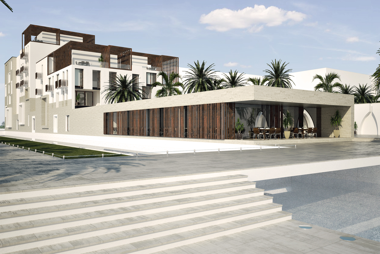

Post by Pibuz » Mon Nov 10, 2008 11:18 pm
Hi guys..
I try to post here a wip of mine, modeled entirely in Sketchy and rendered through SkIndigo. I'm sad to report that i was very excited about the 1.1.12 version of SkIndigo, but after an afternoon of trials i had to give up. It seems like all the features are supported, but few of them are actually working.. :cry:
This isn't absolutely supposed to be a critic to Whaat's work, which is actually fantastic (..i think it's really hard to follow the real time implementations of Ono :wink: ) and i thank him a lot for his sacrifices. I just wanted to report some bugs, that's all. Then we can work together to fix them. :D
First of all, I think the fact we can import an external texture without having to insert it into Sketch is actually a very important feature. I counted a lot on it, but it seems like i couldn't get it to work.. I tried to link basicallyexternal exponent and bump maps: in the preview they just looked great, but in the render their effects disappeared. It was just a plain texture with an exponent value..
I really have to say that i was in a hurry, so i didn't spent so much time on that: i preferred to switch back to the stable version wich works perfectly (though my sketch file is something about 46MB now :wink: ).
I mean, perhaps (and that's not so improbable) SkIndigo 1.1.12 works perfectly and i simply misunderstood how to use external mapping.. Could be! ..I think i really have to save some time to practice well..
So, for now i post my wip.
It's a wip, it means i want to improve it. Go with the tips!!!

Post by OnoSendai » Mon Nov 10, 2008 11:51 pm
Hi Pibuz,
nice render.
It looks a little blocky in parts though. What splat filter did you use? What supersample factor? And what downsize filter?

Post by OnoSendai » Tue Nov 11, 2008 12:06 am
Ah, no worries, it just means Whaat has done a good job hiding the rough edges of Indigo :)
Sharp filter would cause the boxy look in some places, I think.
Post by CTZn » Tue Nov 11, 2008 3:12 am
I agree that at this stage of the wip, some surfaces look flat, and some angles very sharp. I hope you will bevel or texture edges in the foreground; the left wall could have variations in shading, either by blocking or bouncing some light onto it. Generally I would avoid the even lighting on flat surfaces.
Great potential, eager to see more !

Post by eulgrand » Tue Nov 11, 2008 3:18 am
That's a fantastic model, Pibuz.
You could break the main (largest) and most visible angles with a bit of bevel, or make them a little less straight with displacement. That could make the render a little less "blocky" as Ono said.
I'd also add some tiny waves on the water on the right (SU's sandbox) - (it's water, isn't it ?!).
Nevertheless, great render already !

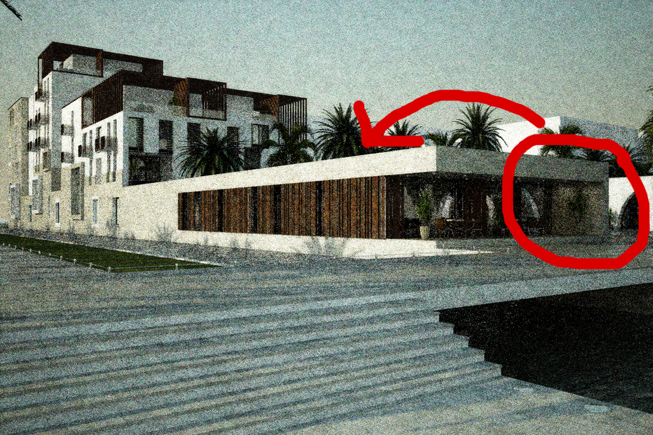

Quick but important question for you: i'm trying to render an evening shot of the scene. So i have to put in some emitters.
BIG problem: if i set emitters' properties in order to see some light and glowing, the rest of the image suddenly burns out! :?: :?: :?:
I tried a 50W efficiency 34 just to begin. I couldn't see any light. I stopped and raised the value, then it was too much. Then i tried lowering it down and okay i could see the light, but the stone and plaster actually burn out!
I first modeled a square inside the light component, and i thought it was this what caused the problem But, even if i take the emitting square out of the component, the problem shows up again..
Is there any reason? Whaat? Any ideas?
Post by CTZn » Tue Nov 11, 2008 4:49 am
You mean:
A: indoor lights are ok, but
B: when you add outdoor lights, everything goes wrong ?
If yes:
1 - don't use reinhard tonemapping !
2 - find the right setting for the indoor lights alone with camera or linear tm
3 - turn the indoor lights off, light outdoor, and with the same value of tm than 2, tune the outdoor lights.
4 - When the outdoor lights are tuned up, light the indoor lights on
5 - I think that at this stage you will need to divide tm value per 2, or reduce it somewhat at least. But at least lights will match.
I hope I get your trouble right, if not then maybe tell us in spanish Pibuz ^^

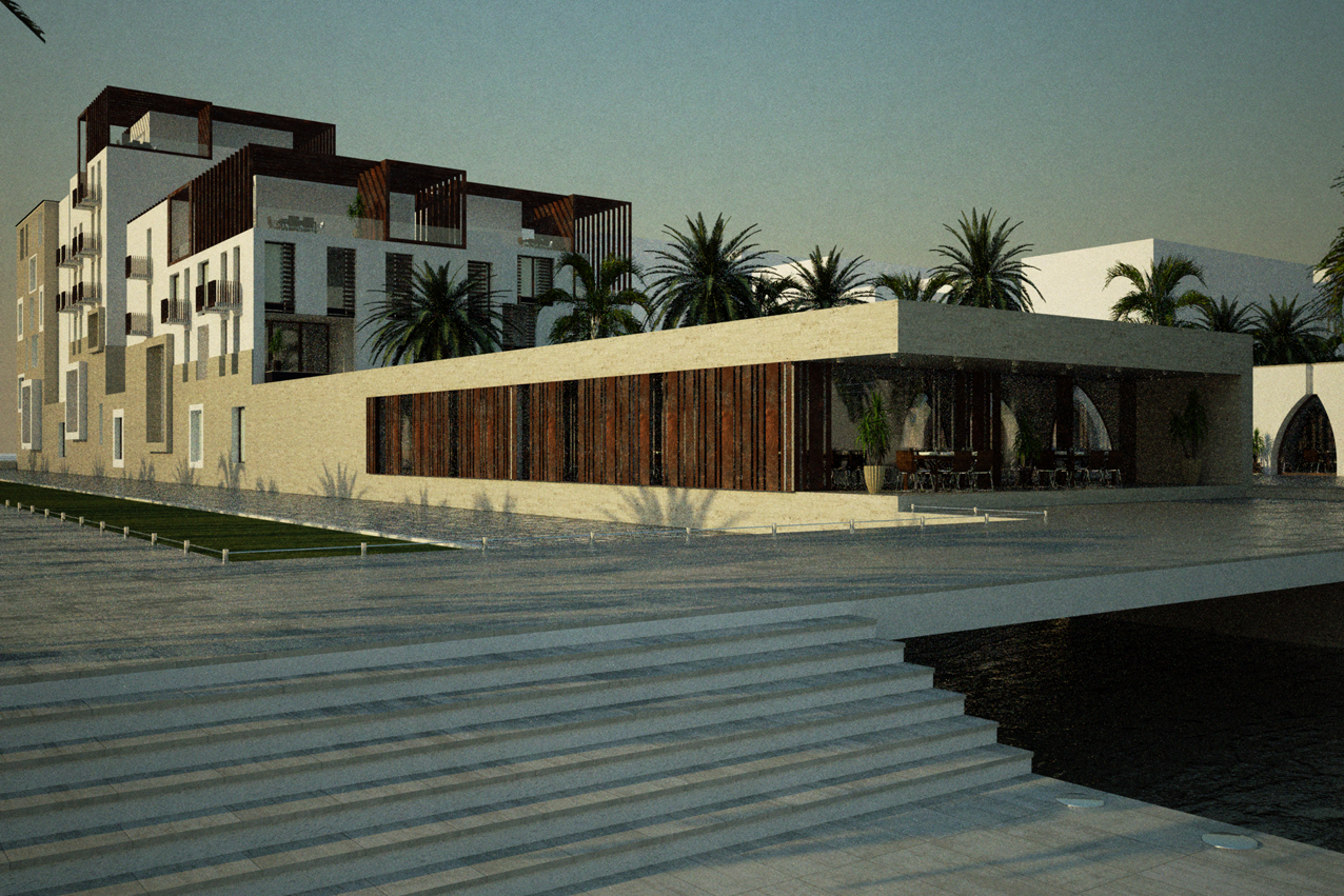

Post by Pibuz » Tue Nov 11, 2008 5:27 am
...uhm..
first of all thank you CTZn for your quick answer!
..and, to get back to my problem, i think the images can sometimes speak for themselves better than i can do.. So i'll attach the two of them. :wink:
Ok, now i have turned on emitters. You can barely see their effect in the circled area. I've pumped their power up just to have the possibility to see the light bleeding on the back stone wall. As a consequnce the stone wall indicated by the arrow comes o
added emitters.jpg (1.91 MiB) Viewed 21088 times
So, first image. I'm using camera tonemapping. There is no other kight source than the sun/sky. You see, the image is (almost) correctly eposed.
correctly exposed.jpg (1.3 MiB) Viewed 21089 times
Post by CTZn » Tue Nov 11, 2008 5:34 am
I'd pump their power even higher, and lower camera iso/ev... I'm referring to point 5, where in cam/linear tm, the power of lights sums up, therefore it claims for a less sensible film. I think sun is still too strong for an evening scene (pump lights up, lower iso).
If I'm wrong here I'll stop bothering you :)

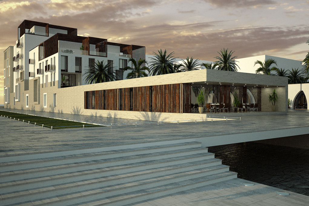

Hi Whaat! Yes, i had a diffuse texture applied, same original size as the bump and exponent textures. I know it sholud be useful to post a sample scene, but as i said i'm a little in a hurry, at the moment.. When i'll get to breathe again, i'll try with a VERY simple scene, so i can find if it was my problem or not. If not, i'll post it to you for sure..
Other thing: you have probably read the whole post. I have to report that the overexposure issue (only when using sun/sky and emitters at the same time) is present from the 1.0.9 version of SkIndigo. The following image has been rendered on a quad core machine Q6600 overnight using SkIndigo 1.0.8 and Indigo 1.0.9_3 (official release).
The workflow with emitters has been simple: i adjusted the overall exposure WITHOUT emitters, and then i made several attempts to pump their power so i could see them. No burnt out area at all.
Perhaps you've been forced to change something in the coding, i don't know..
So, here's a slightly postproduced image. Still WIP.
Eulgrand: no environment map. Just sun/sky!
by evening.jpg (690.99 KiB) Viewed 20964 times
Post by BbB » Tue Nov 11, 2008 10:28 pm
This is a pretty spectacular image. Well done. In general, I would avoid the sharpen filter like the plague. Nothing brings out the grain so much.
