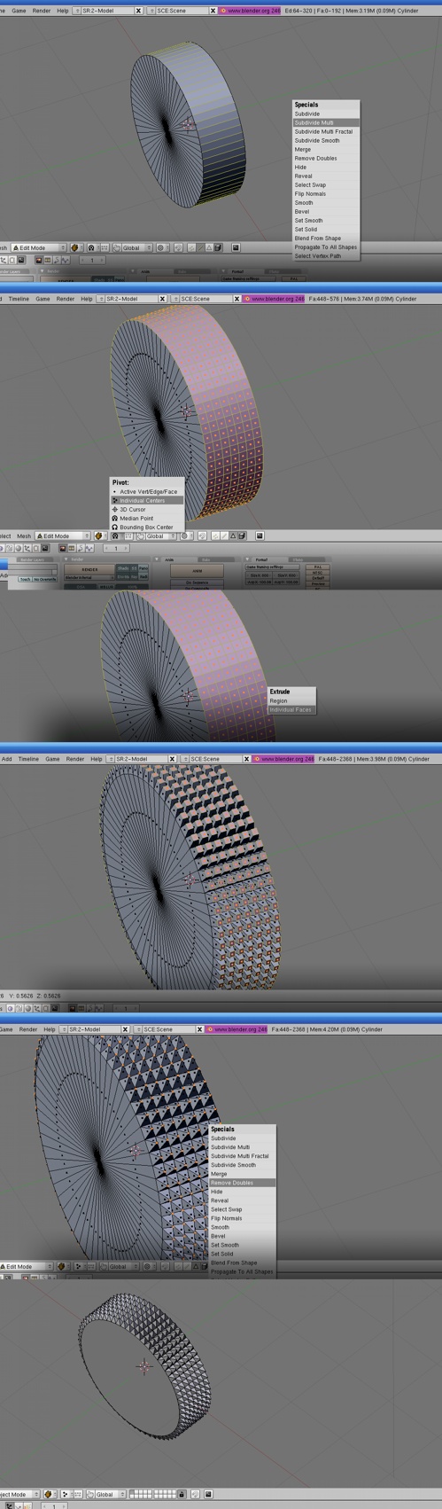

Post by StompinTom » Tue Jul 29, 2008 1:50 am
check this out.
simple cylinder, use more sides for smaller spikes, less sides for bigger, chunkier spikes.
subdivide the edges so that you end up with squares.
set the pivot to Individual Centers, that will make your faces scale independently of eachother.
extrude all the faces individually however much you want the spikes to protrude.
scale down to 0.
remove doubles.
repeat ad nauseum.
Post by PureSpider » Tue Jul 29, 2008 3:23 am
Looking @ my zippo I think it more looks like this...
Post by StompinTom » Tue Jul 29, 2008 5:10 am
just gotta bevel the edges between the pyramids then.
Post by PureSpider » Tue Jul 29, 2008 6:09 am
The "things" are actually "negative" pyramids as the go down instead of up ;)
But yes thats the way I've done it, beveled the edges between the pyramids.
