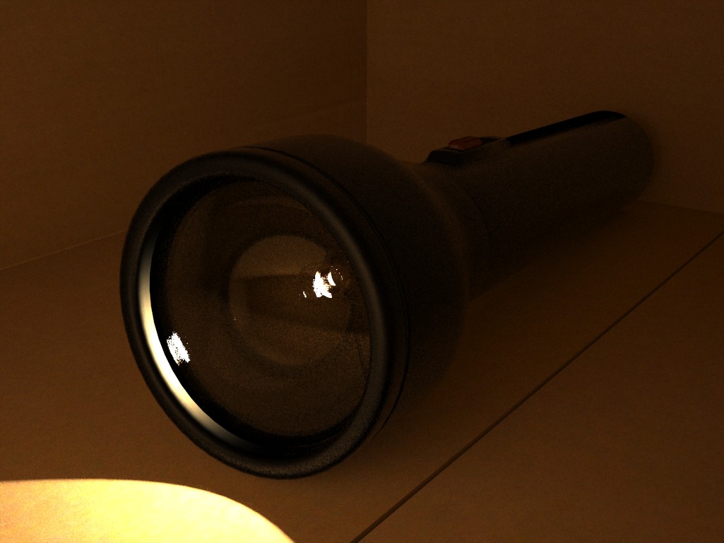

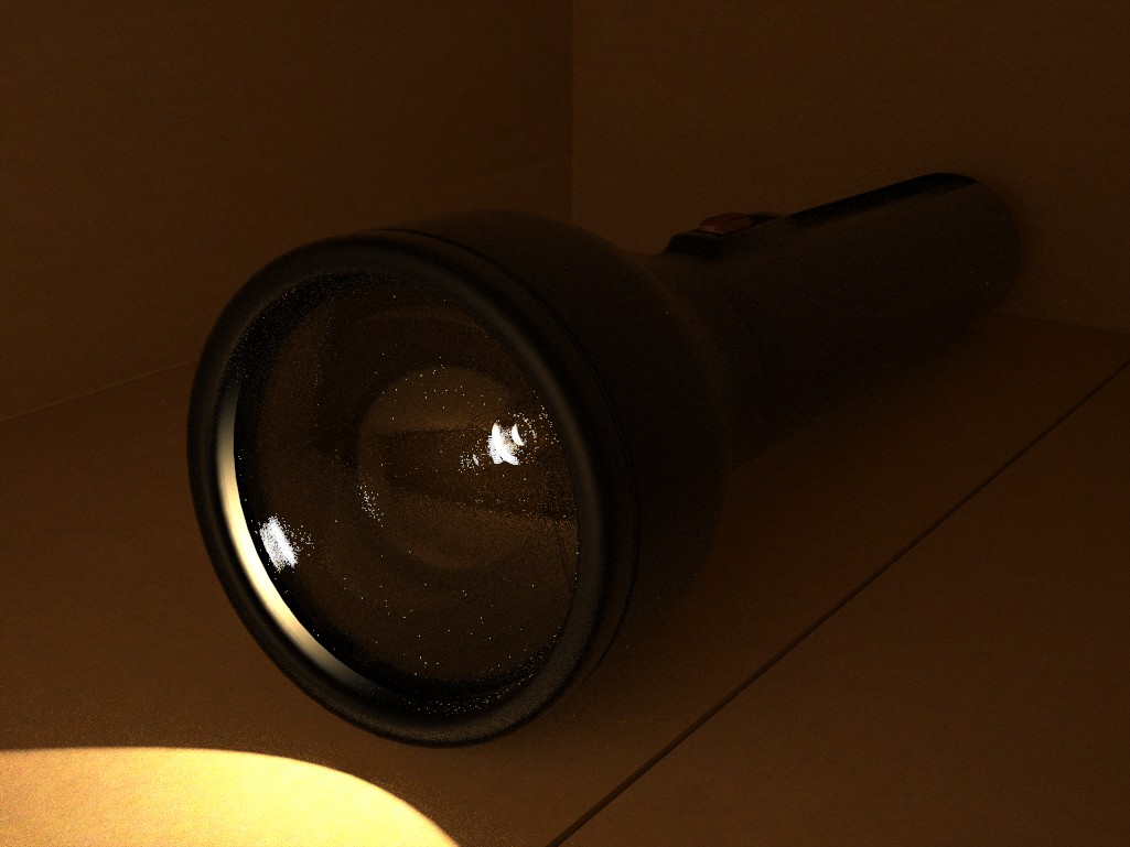

hi all,
here's a simple scene i made in 3ds max
expecting something marvelous! to happen, i modeled the emitter as a helix.
i think the image should be 'clearer' esp. the bulb and the mirror
what do you think the problem is?
a) inappropriate materials
b) i am not patient enough :? (4-5 hours on an e6300) (SPP 1571)
c) a higher super sampling size should be selected (4 was used)
d) any other?
thx. in advance
without noise reduction
out 2.jpg (112.37 KiB) Viewed 13513 times
median noise reduction
kernel size 5
a view from the model
Post by pixie » Tue Jul 01, 2008 6:55 am
Some thin fog perhaps...

Post by Borgleader » Tue Jul 01, 2008 7:46 am
m.f.t. wrote:no, there's no fog... :/
And that is why he suggested to add some?
Post by BbB » Tue Jul 01, 2008 7:51 am
Main emitter behind glass = looooooong render time. Let the rays roam freely.
zsouthboy
Posts: 1395
Post by zsouthboy » Tue Jul 01, 2008 7:53 am
Sampling through a bunch of media is a nightmare, it's going to be slow no matter what.
Simplify the emitter as much as possible (1 triangle) is pretty much all you can do to help.
EDIT: BbB beat me to it.

Post by suvakas » Tue Jul 01, 2008 9:30 am
Super sample factor 4 ? Why? It only controls the AA. Setting it to 4 renders your image 4x the size it actually is. Leave it to 2 as it is by default. Also for scene like this use MLT not Pathtrace.

:) That's what I meant. You could use nk materials for the metal and see if it improves...
Post by Kram1032 » Wed Jul 02, 2008 10:06 am
"non-Indigo" isn't quite informative. If you do a render in an other engine, you should post, which engine ;)
SSF 4 is quite unnecessary. go for 3 or even 2.
Also try to activate (will actually slow down the render but will make it look more realistic and maybe in this case better, earlier) aperture refraction... (bloom)

Post by Kram1032 » Thu Jul 03, 2008 7:33 am
Well, The sharpness of your render heavily depends on your AA settings. ;)
Which filters do you use for splat and for downsize and what are the values for them?
