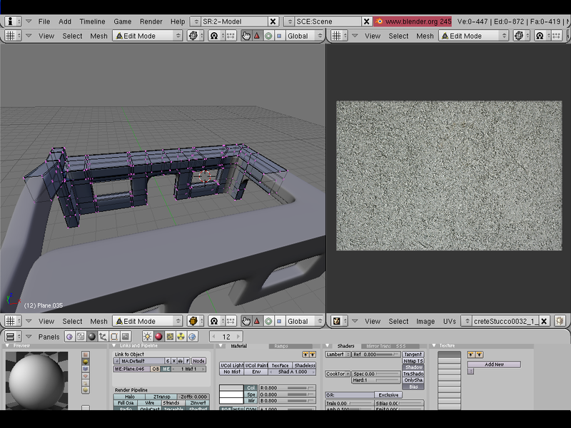

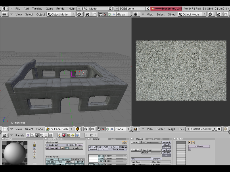

I've been trying out textures the last few days, but I'm not very good at unwrapping and need help with the main "house" object. How would you guys unwrap this?
Face Select Mode -
http://i125.photobucket.com/albums/p50/ ... nwrap1.png
Edit Mode -
http://i125.photobucket.com/albums/p50/ ... nwrap2.png
(if another pic is needed to see the object better just ask)
alex22
Posts: 171
Post by alex22 » Wed Feb 27, 2008 12:40 pm
You should first make seams at some positions. What you have to get rid of are loops, because thats where the unwrapper bugs most.
For example you take a ring. If you just unwrap it, it will make problems. If you make a seam in the ring, it will unwrap to a simple straight line.
Do them in positions where they aren't as visible. For example when you have a windowframe, then make seams to cut it out of the wall. Then cut the loop you made with a seam in one of the top corners.
Make seams in corners you mostly don't look at. For example if the corners are behind the camera or there is an object in front of it or whatever. Make seams between wall and ceiling and floor (they probably have different textures anyway).
