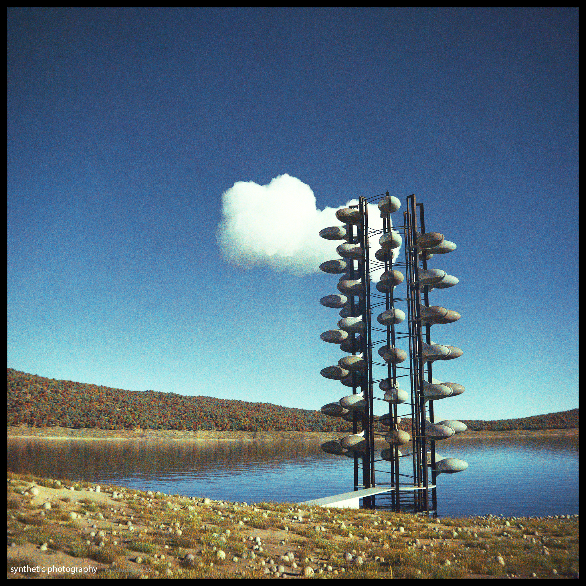

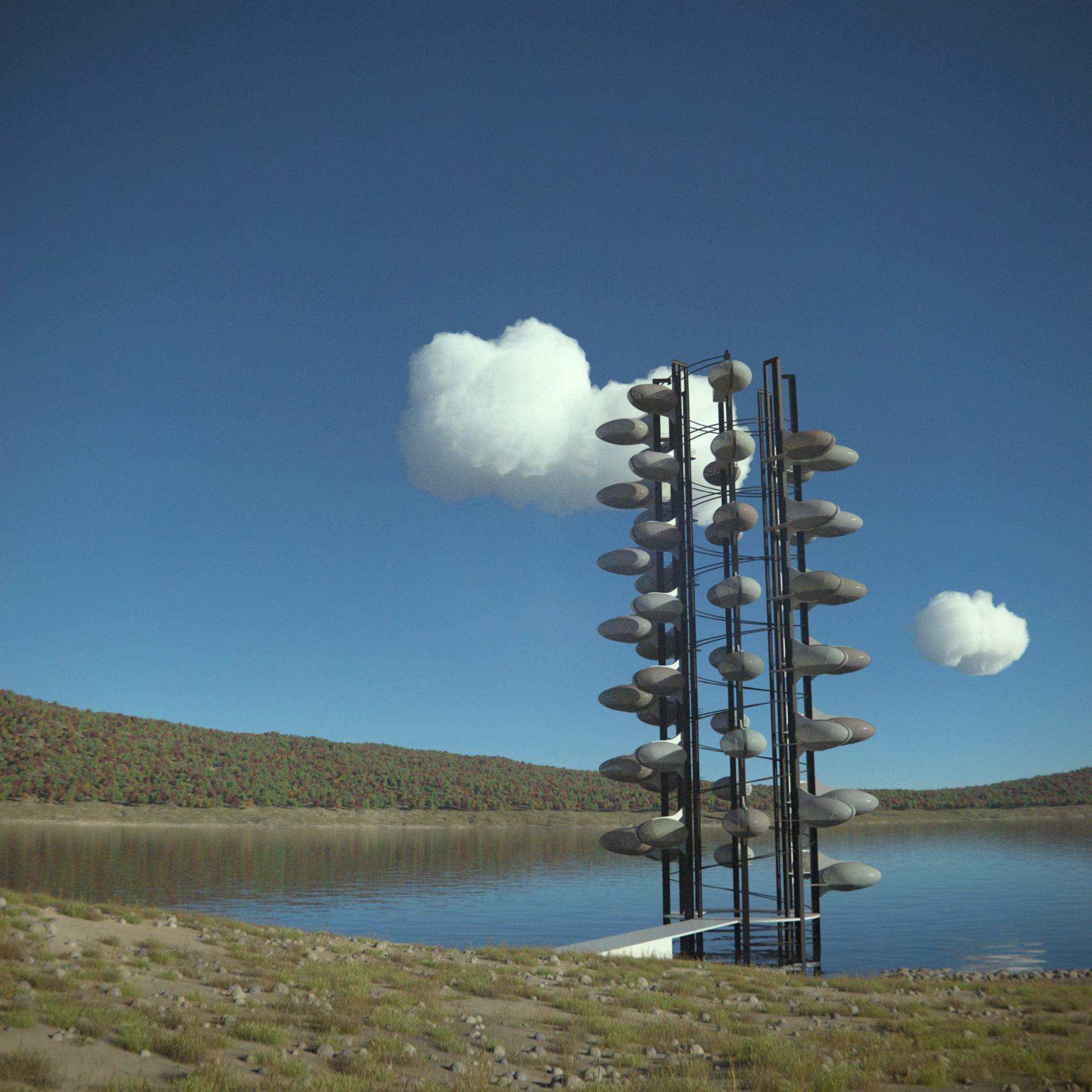

Some things solved.

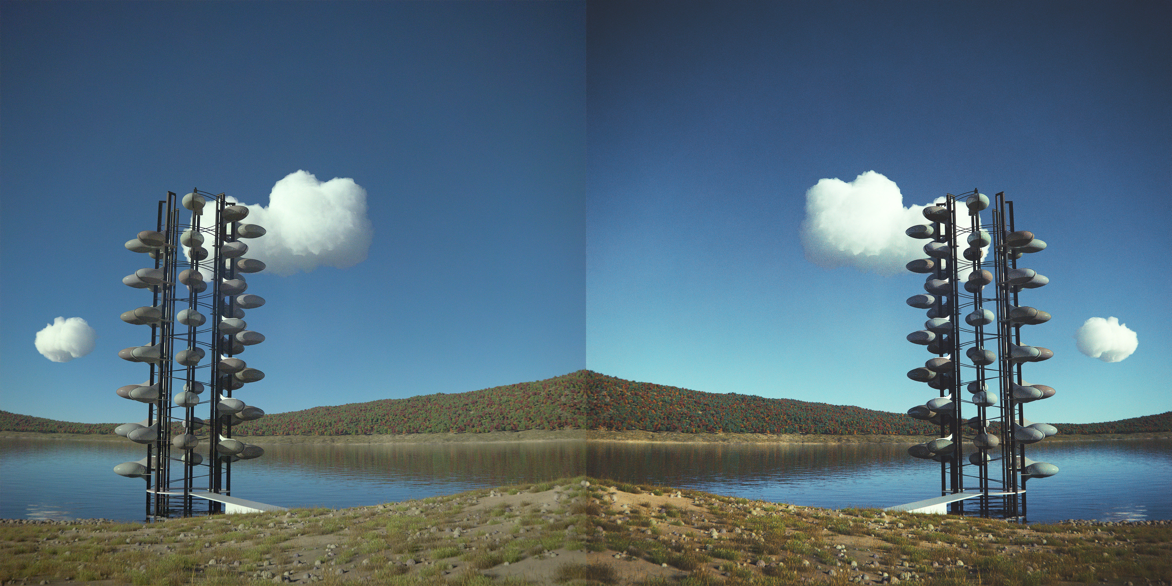

When the mesh to scatter has more than 3.3 millions of polygons and a subdivision is setted, the scatter goes wrong.
A clarify piece of code for the trees scattered (modulation).
The no-clouds space of the clouds box has a bit of absorption and scattering. Mie cumulus.
33 hours, harder... lets go to 60...

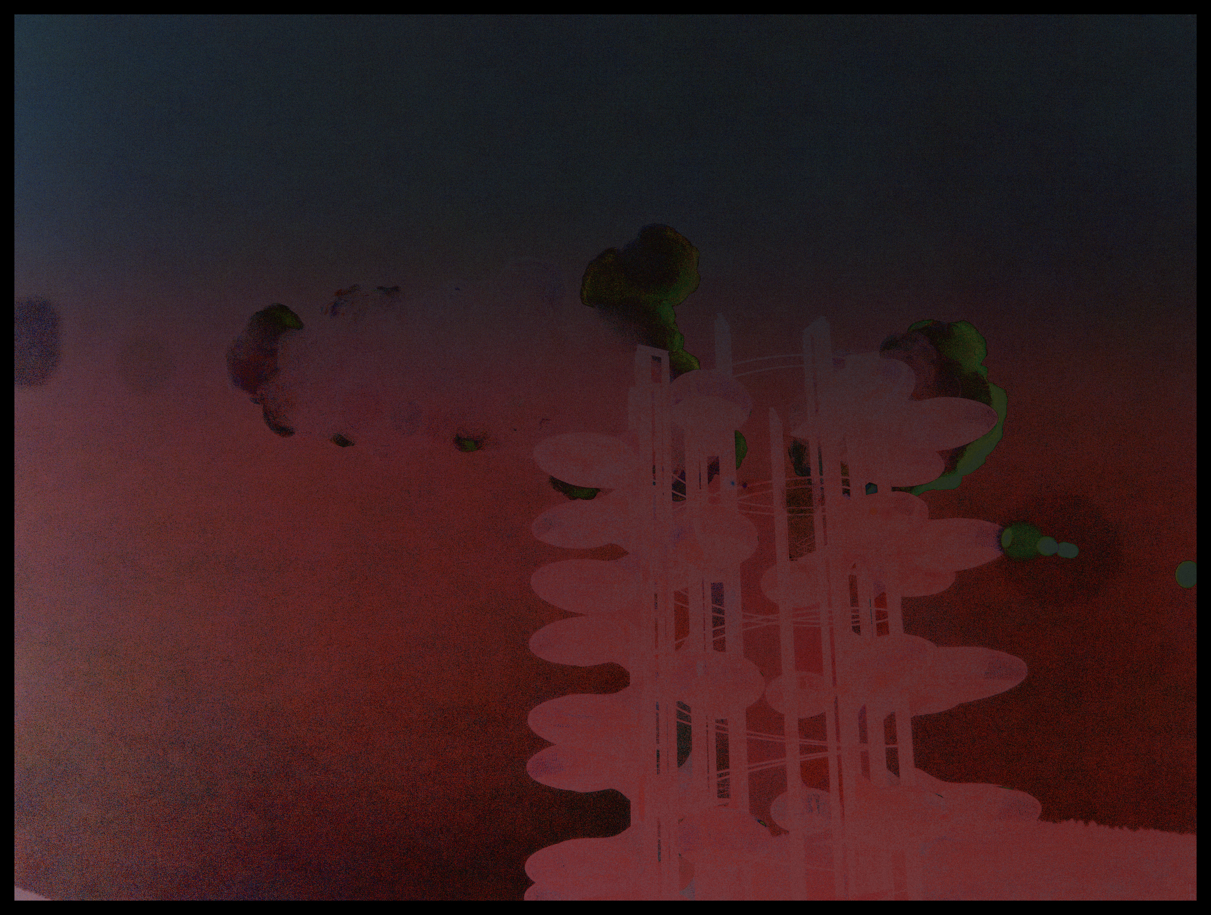

10 hours.

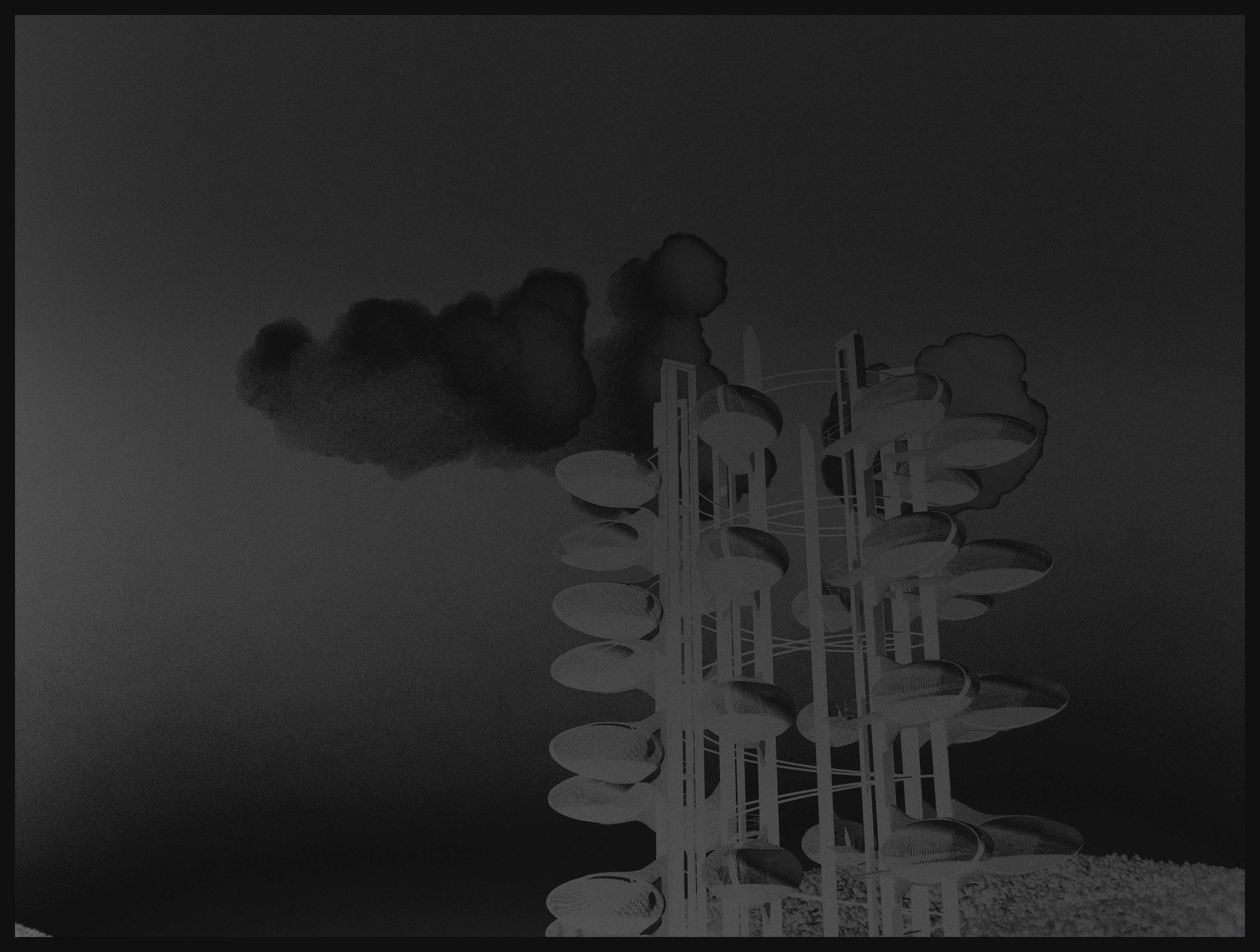

There are some problems with singular clouds (dark borders).
Here you can see what happens with an IOR 1.0, 0 absorption and 0 scattering.
For a null material seems OK. Is a bug. Now I understand why the light is sometimes modify with a cloudsbox...
Solved, a normal(phong) tag gives problem with specular materials of IOR = 1.0... Remove normals from mesh and shading normals in indigo.
Partially solved for this take, but seems not easy to work...

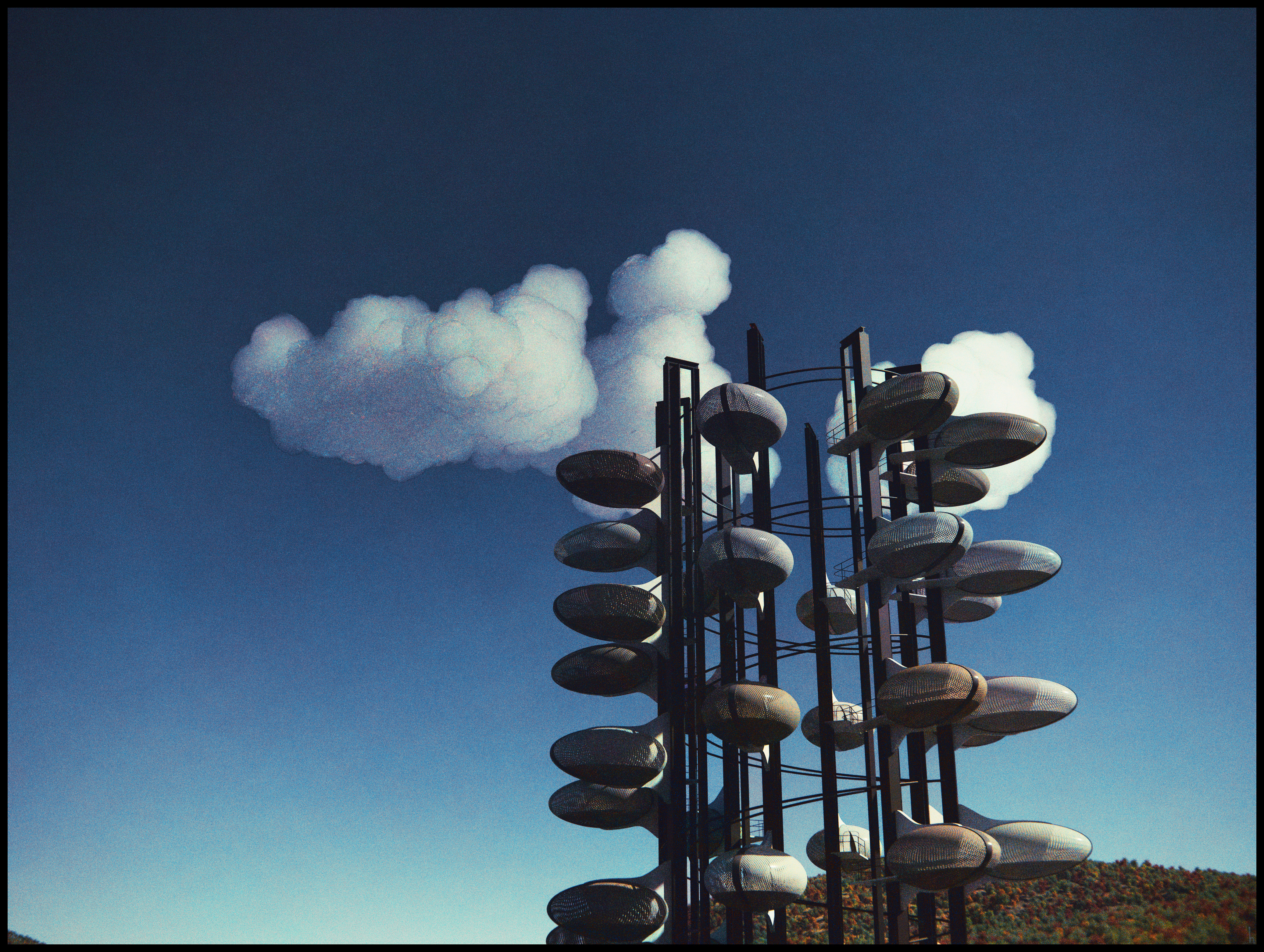

Is fast and clean. Uniform phase function in this one.

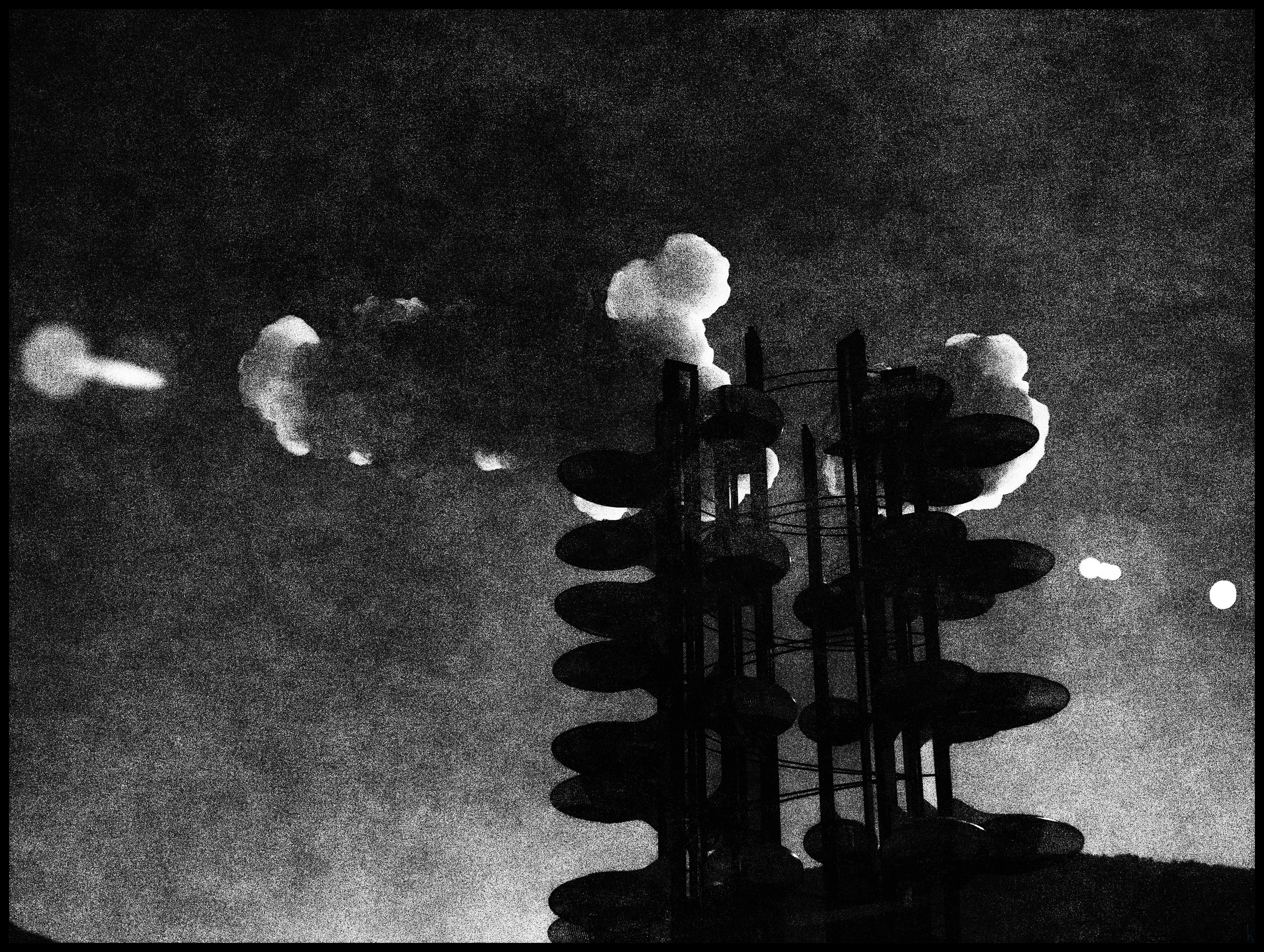

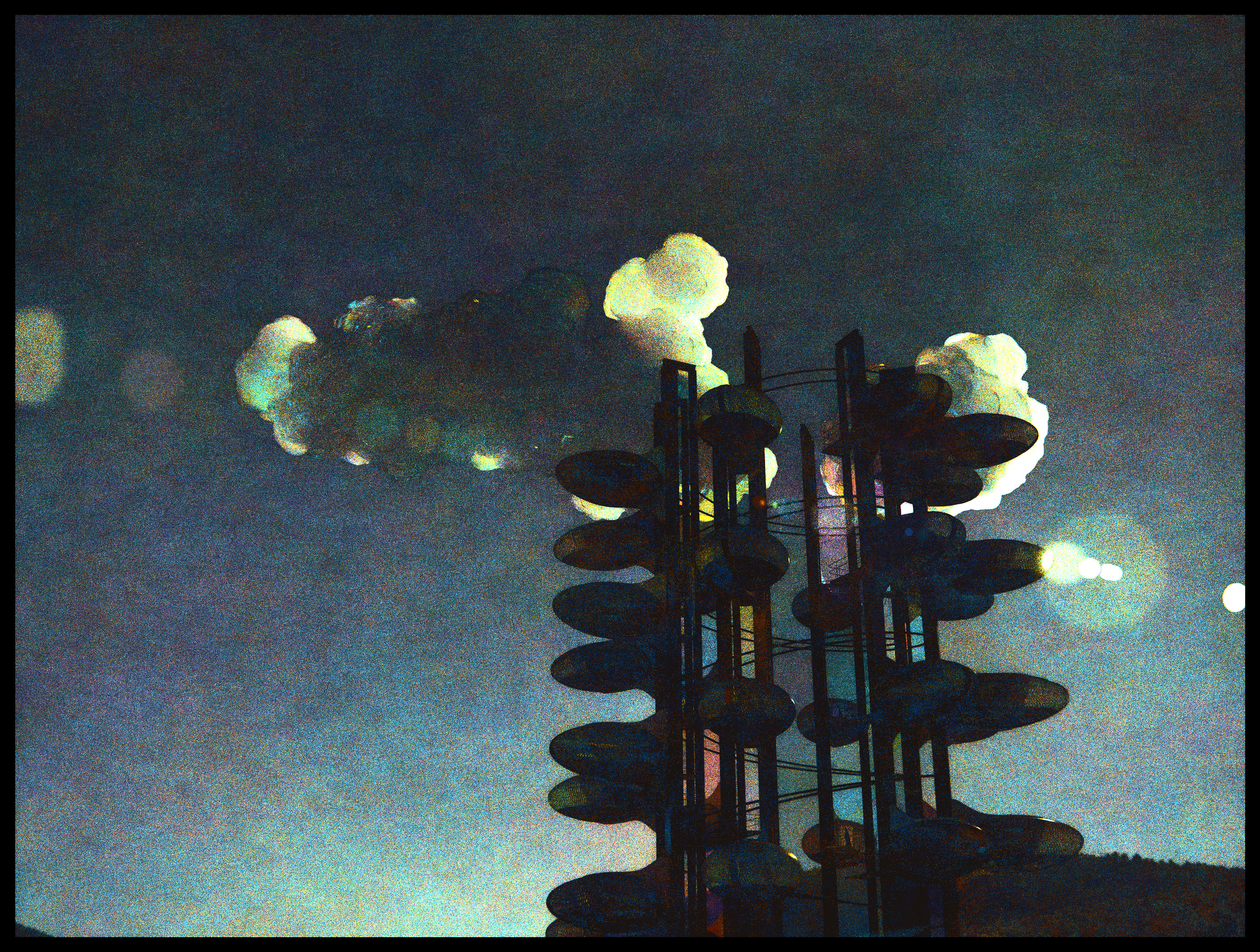

Post by yonosoy » Wed Feb 14, 2024 1:47 pm
At last I´m learning to develop the linear tonemapped EXR...
1 Correction of distortion in Darktable. Profile: Canon full frame 35 mm camera (?), objective Canon EF 24 mm II USM.
Horizontal flip.
Output in png 16 bit (I can´t find another format that export the tones correctly).
2 Process in photoshop in 16 bit color mode.
Two instances of the darktable output like smart objects.
Bottom, Silver Efex filter.
Up, the instance with the layer mix in color mode.
The Lut (50 % opacity). Is an AGFA film.
Finally (and very important), a displacement of +0.01 in the exposure.

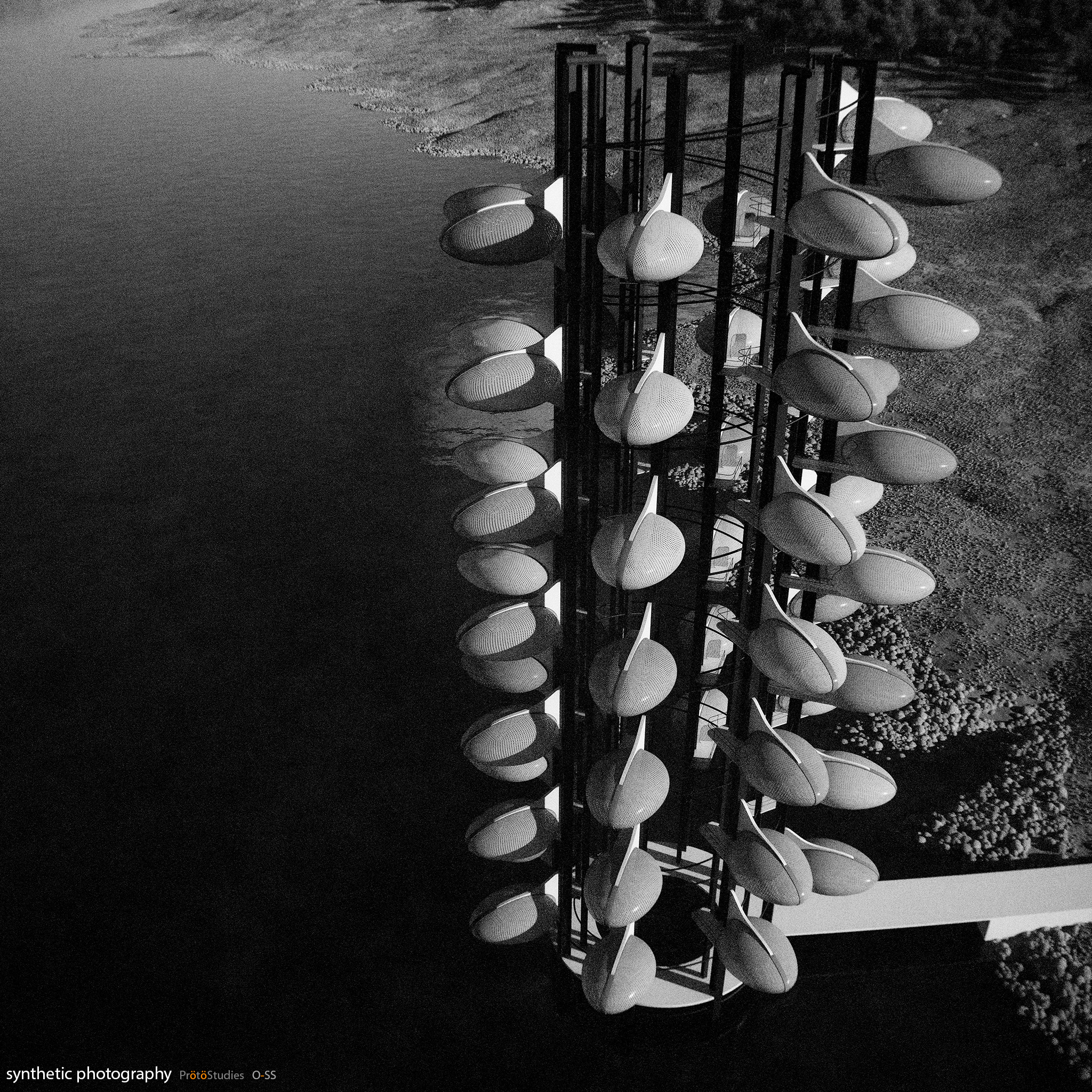

Second view over O-SS, seems that the difficulty to change the perspective is not so high...
Some scatters more. Must rectify some things for a more organic look...

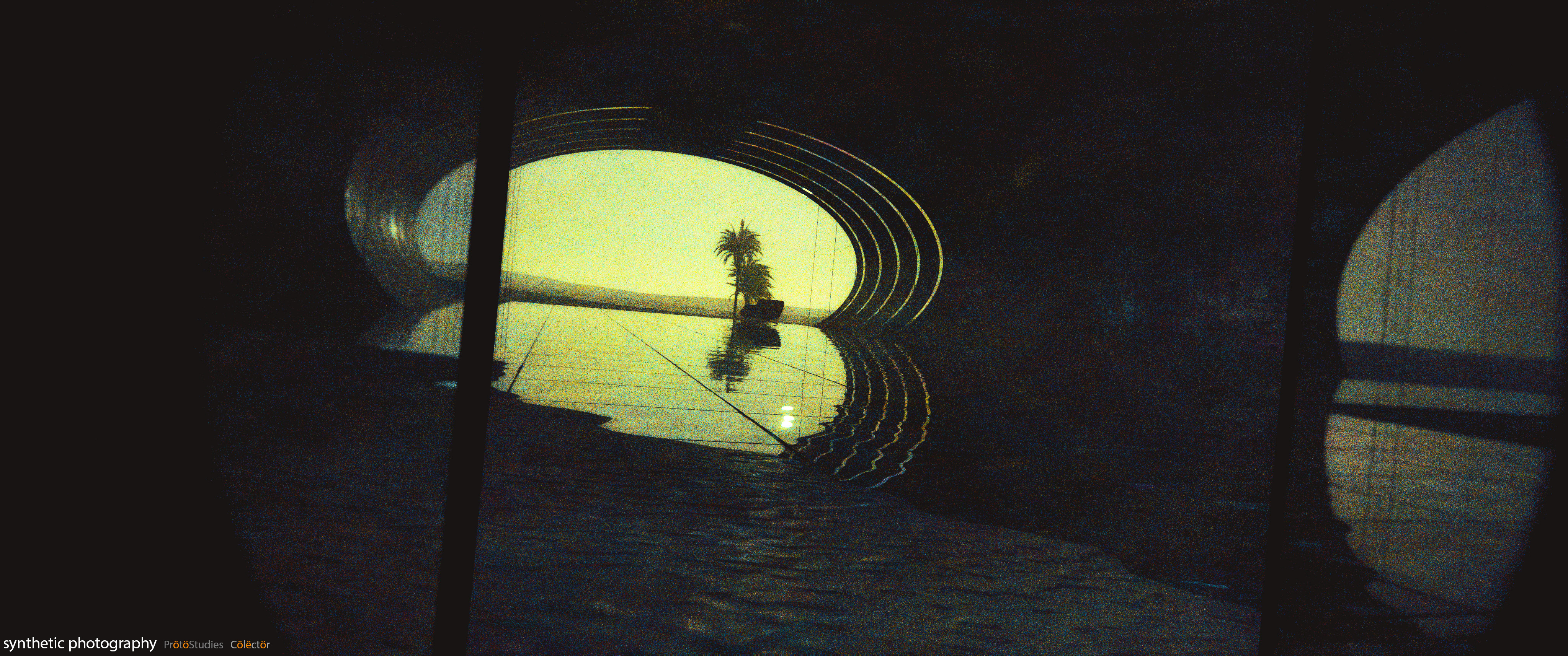

Post by yonosoy » Wed Feb 21, 2024 4:24 pm
Sometimes, aperture is present...
In this case, in a half of hour process, seems to "homogenized with the incoming light to the image"...
Is a non ortogonal ortographic view of a photographic perspective...
Yes, aperture diffraction present but a little weak.

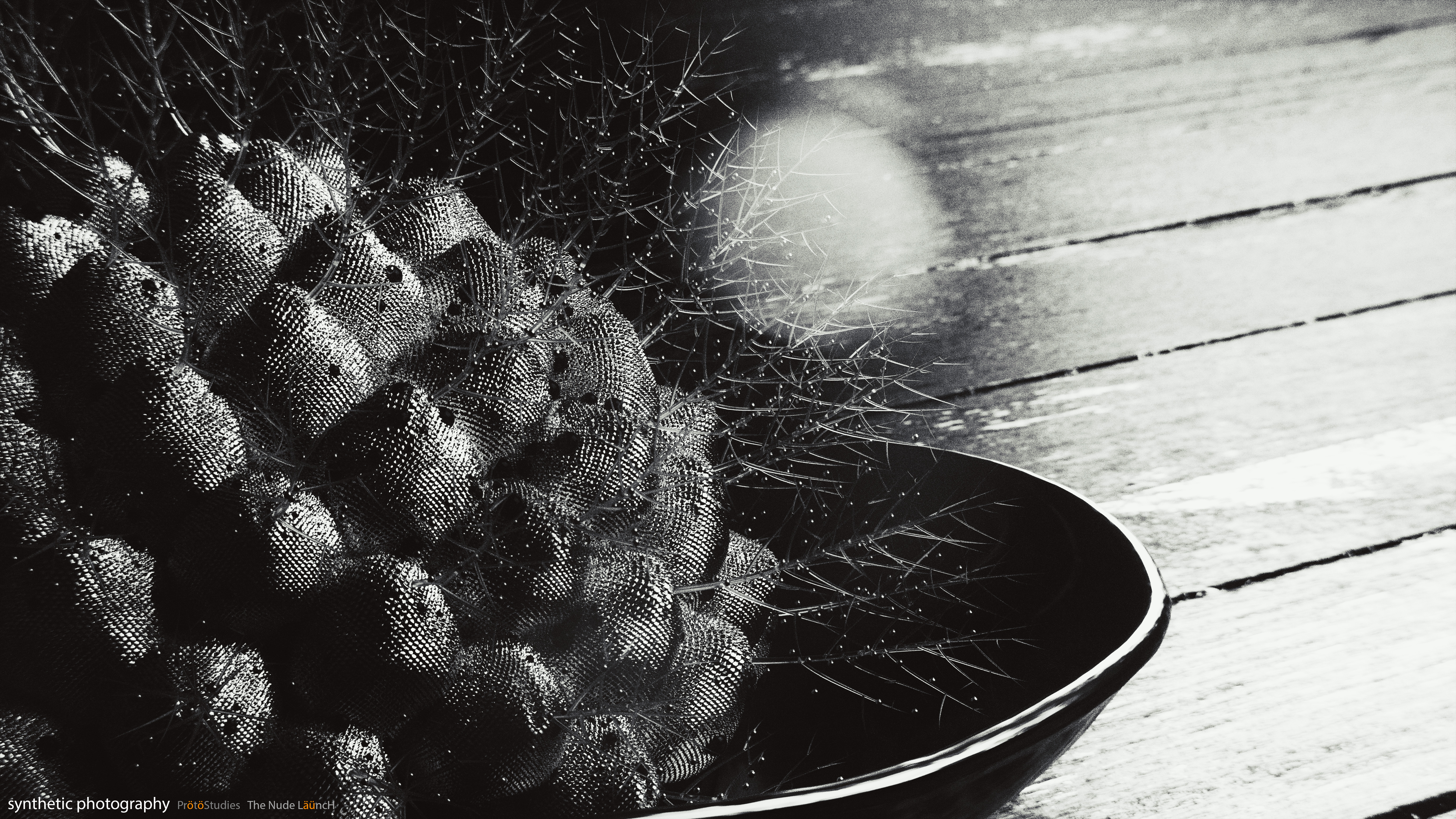

Post by yonosoy » Mon Feb 26, 2024 10:39 am
Pse, pse...
I lost the position and setup of the lights...
30 hours.

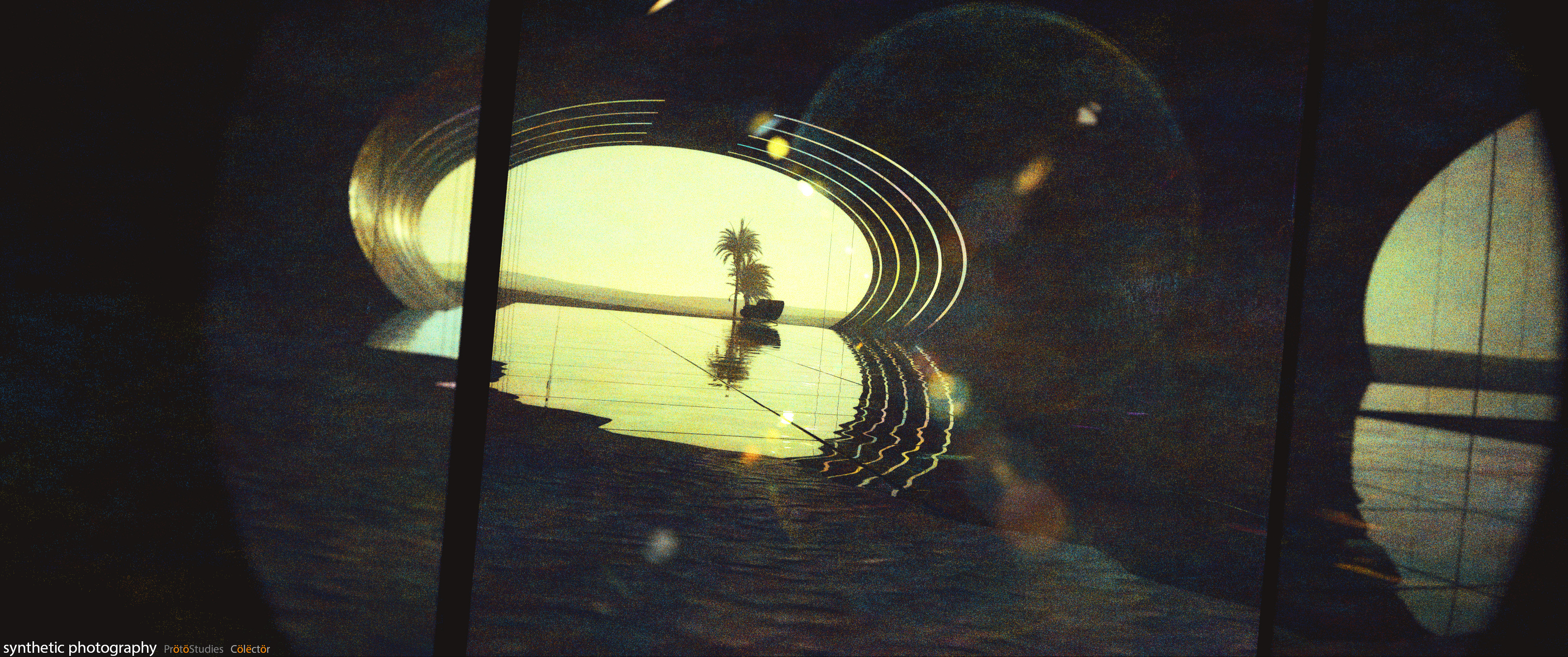

Post by yonosoy » Thu Feb 29, 2024 11:08 am
A bit "buggy".
Seems that the best practice with metropolis and optics is to leave the standadrd parameters of the algorithm. Is fundamental a value of o.4 in the large mutation probability parameter. Is a lot noisy, but is the only way to acquire good lens flares.
Look at this disaster. Lens flares from a reflection of the sun... But is imposible at the moment to acquire the rays of the aperture. Very strange... I must investigate deeper the models. 12 hours.

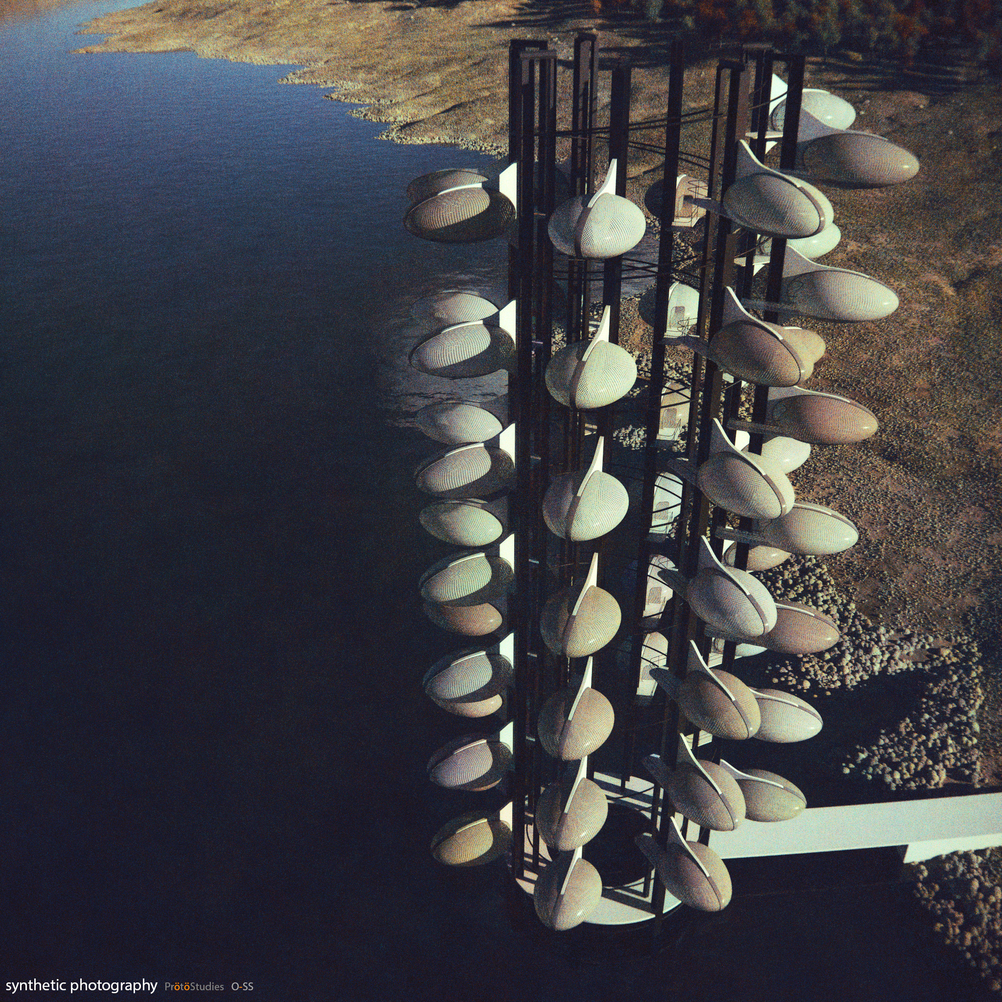

Post by yonosoy » Tue Mar 05, 2024 3:32 pm
Working in the cloud shader, without succes. Now it has an envelope dependet in normals of the mesh but i can´t organize it yet...
4 hours with the machine at 74%, and with the standard parametes of metropolis it get slow...
Beauty ... This kind of expression///impression is ... reminds me another times, at a beggining again ...
