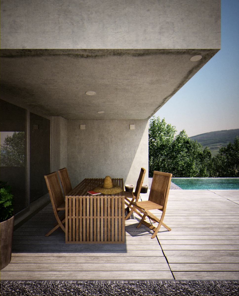

Post by slamdog » Wed Oct 31, 2007 8:17 am
maybe last update... :cry:
changed textures with higher resolution ones, some other minor changes.
must study for exams so maybe this will be the final version. i will render full resolution for 11-12h.
some last hints? :D
bye bye
Kosmokrator
Posts: 1141
Location: Greece-Athens
Post by Kosmokrator » Wed Oct 31, 2007 8:34 am
vere very nice results man.......give alast render about 20h.....and add more contrast to the table texture.....the roofs material-model is super....trees-water-env...super!!!
i like it!!!
p.s..... add some green leavs in the left as in the real photo...
ps 2....play a litle with the color of book...looks strange!!!
slamdog
Posts: 38
Joined: Fri Oct 26, 2007 5:31 am
Location: abruzzo, italy
Post by slamdog » Wed Oct 31, 2007 8:59 am
hehehe... :D many many thanks kosmokrator :wink:
i will begin the final rendering tomorrow
CoolColJ
Posts: 1738
Post by CoolColJ » Wed Oct 31, 2007 1:59 pm
slamdog wrote: some technical questions...
i'm using these settings:
LM prob=0.1
Max Change=0.03
Max num cons rej=2000
Max Depth=600
SuperSample=3
low values of Maxnumconsrej speeds up convergence? and can affect the "realism" of the scene?
Other question: there's a way to reduce the render time per sample?
bye bye
don't use a LM that low, try 0.4 to 0.5!
don't use a max change that high, it will smooth faster with 0.005 or 0.003
or you can try default of 0.01
Post by BbB » Wed Oct 31, 2007 7:33 pm
Great work. I agree with Kosmo, you really need to give it some time. 20h would be nice, maybe more. It will make all the difference and bring details out you never thought you would see. If you have the memory, you should even try rendering it at twice the resolution and downsample when it's done. That way you can get a super-clean final image even if the original render is not completely clear.

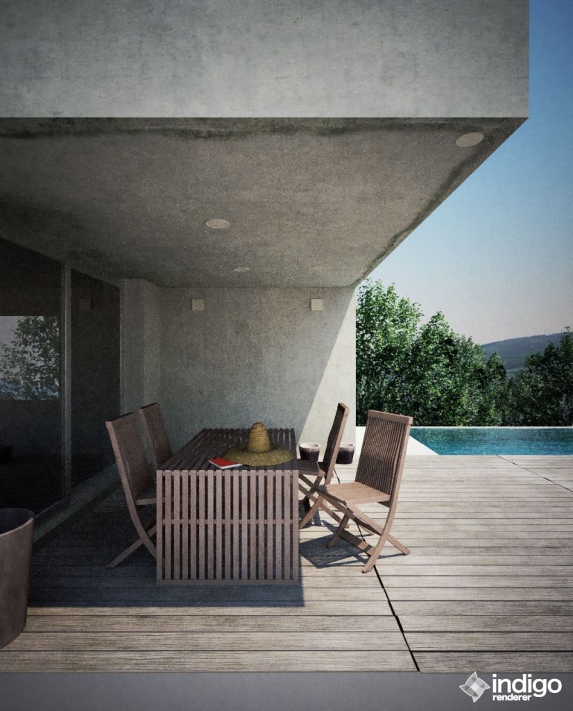

slamdog
Posts: 38
Post by slamdog » Wed Oct 31, 2007 9:31 pm
Hi all :D
Here's a VERY little preview of how the final version will look like.
Rendering full resolution at 1536x1904 (the preview is after 6h of rendering)
Some details already came out, but water seems to take a looong time to clear. I'll give 20h like you said (if my laptop doesn't burn :P , for now it's emitting strange sounds :shock: )
bye bye
PS: i'm planning to re-tonemap the hdri with reinhard05 and do some postpro with the gimp.
Post by Kram1032 » Thu Nov 01, 2007 12:08 am
uhm... how do you want to extract the hdri?
Igis aren't supported by any tonemapping prog, afaik...
you'll need to export multiple pngs with different post-scale settings: post-scale is like Exposure stops :)
slamdog
Posts: 38
Post by slamdog » Thu Nov 01, 2007 12:25 am
in the blendigo exporter i've checked the option that saves the untonemapped exr, then i will edit with qtpfsgui.
bye bye

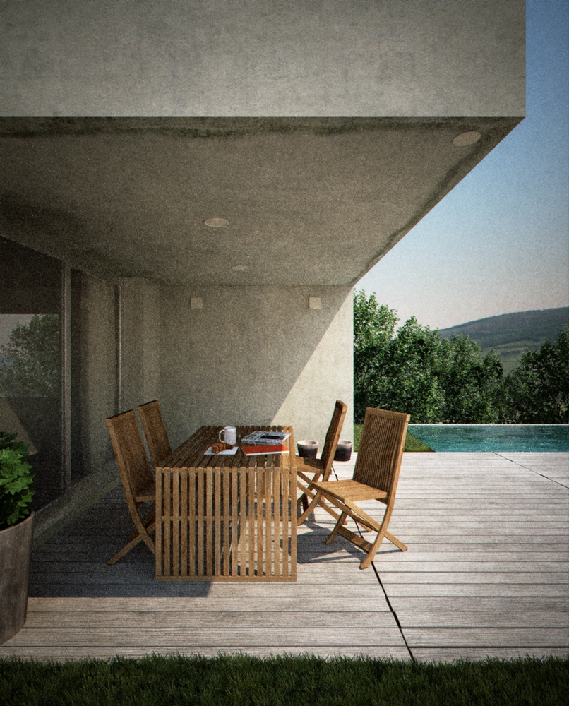

slamdog
Posts: 38
Post by slamdog » Thu Nov 01, 2007 3:02 am
this is the re-tonemapped hdr... :D
no problem...only seems that the dynamic range isn't so extended...
however it does a nice job: the reinhard05 tonemapping is quite good... maybe better than the indigo camera (I know... they have completely different approaches... :roll: )
slamdog
Posts: 38
Post by slamdog » Thu Nov 01, 2007 10:53 am
New update...
