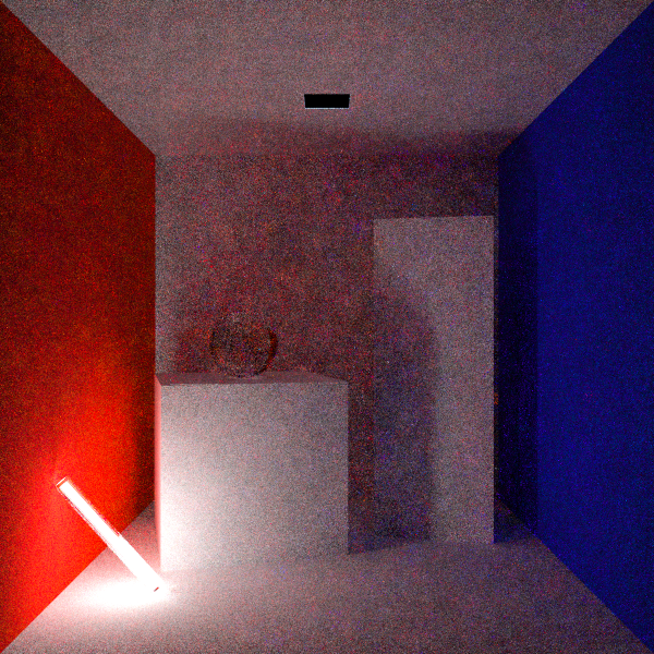

Here's a little test i did with rendering the Light-passes in different "Frames".
For that I used the Blendigo Export-Script and the Export animation Feature for automatic rendering.
Multilight is a intresting Feature for Lightsetupping, because if you've rendert your Lightpasses, it's very handy to configure the Lights if you want to and you haven't to render everytime a new test to see if the Lightconfiguration is okay !

Can you explain to all more details...
my first question is how many time to render all aminamtion?
Is the same time for make one frame?

Well done! This looks pretty useful... I guess the only drawback is the extra time waiting for the separate renders.
One question: How did you combine the separate images? Was it some sort of "screen" or "add" or what ..?

Post by Sebastian » Wed Aug 15, 2007 2:25 am
You can combine the images with "Sceen", I used Gimp for that.
A good explenation of the method could seen here:
Indigo and Multilights

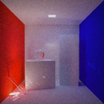

Post by OnoSendai » Wed Aug 15, 2007 2:29 am
Cute.. but physically incorrect, as I've written about before.
Post by Kram1032 » Wed Aug 15, 2007 2:37 am
Any way to make it correct, then?

Post by walter » Wed Aug 15, 2007 3:03 am
Ono,
Could you explain again (or link to your previous explanation) of why this is physically incorrect? I've been looking through the forums, trying to find this but couldn't :(
I thought, that, as light properties are additive, and light waves don't interfere (at least, not on the scale we're talking about), doing a simple "add" function would be physically correct. Is the problem mainly re: tonemapping before/after the add?
Posts: 6243
Post by OnoSendai » Wed Aug 15, 2007 3:08 am
walter wrote:Ono,
Yup.
The correct approach is to form a linear combination of the *un tone-mapped* image buffers, *then* apply the non-linear tonemapping operation.
Applying the non-linear tonemapping operation first (i.e. mixing the PNGs) is incorrect.
walter
Posts: 12
Joined: Tue Aug 07, 2007 6:52 pm
Post by walter » Wed Aug 15, 2007 3:13 am
But, Indigo can save un-tonemapped images .. so, that's not too hard at all ..!
Posts: 6243
Post by OnoSendai » Wed Aug 15, 2007 3:15 am
walter wrote:But, Indigo can save un-tonemapped images .. so, that's not too hard at all ..!
Sure... if your image editor can mix EXRs :)

Post by walter » Wed Aug 15, 2007 3:22 am
Right :D
I might be wrong, because I've never used it before, but it looks like Cinepaint can do this...
[edit] This might also be nice functionality to have in violet.
Posts: 6243
Post by OnoSendai » Wed Aug 15, 2007 3:33 am
Yup, would be awesome to have in Violet.
Unfortunately, the required GUI code is non-trivial :)

Post by Sebastian » Wed Aug 15, 2007 5:06 am
Unfortunately, the required GUI code is non-trivial Smile
Yes !!
that would be awesome. Hope one Day Violett support that feature, then we'll catch Maxwell with his "magic" :lol: Multilight function.
Here is a Gimp file with several lightsetups to try the IndigoMultilight-Mixing feature.
Water.rar
(2.03 MiB) Downloaded 209 times
