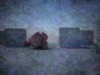

dougal2
Posts: 2532
Location: South London
Post by dougal2 » Fri Mar 30, 2007 4:29 am
the aperture!
the image is getting clearer now that I've put in an aperture!
I have a feeling though that the hole size will have to be infinitessimally small in order to get sharp focus - which would also mean very very very long render times.
It's looking good though, just wish I had doen it properly form the start... :oops:
Post by OnoSendai » Fri Mar 30, 2007 4:38 am
The whole point of lenses is that you don't need an infinitely small aperture (pinhole camera) to get a focused image.

Post by dougal2 » Fri Mar 30, 2007 4:44 am
OnoSendai wrote:The whole point of lenses is that you don't need an infinitely small aperture (pinhole camera) to get a focused image.
this did cross my mind... so why then does it not work?

Kyokutan
Posts: 17
Joined: Tue Oct 17, 2006 2:56 am
Post by Kyokutan » Fri Mar 30, 2007 7:44 am
I made a pinhole test. (Someone made one some time ago)
The image is projected on a screen, like ono suggested. (look Pinhole.blend)
(Normal.jpg mirrored for better comparison)
Rendered 3 minutes
(Mirrored for better comparison)
Rendered 3 hours
Pinhole.zip
(42.19 KiB) Downloaded 220 times
