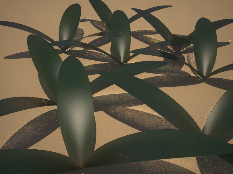

Post by Kram1032 » Tue Mar 13, 2007 5:19 am
This should be a testscene for leaves... It's not that good, now :(
I know, it needs bumpmap and stuff...
it's lit by a sun!
Atm reinhard 1/1/6...
More DoF is required, I guess, but my real problem atm is the mat.
Here is the code:

any ideas?

I don't have any leaves on hand at the moment to compare but I think bump mapping and a thin waxy surface layer would help sell it better. :)

Sorry, as I'm new I have no idea for your mat. However, the shadows look strange, as if the leaves were generating caustics.
Post by Kram1032 » Tue Mar 13, 2007 8:48 am
yes... bumpmap would be great...
I didn't find a good one, yet...
yes the caustics are looking strange too, but I guess, if I'd render it longer, they'd mostly disappear.
ATM I'm testing blend-mats:
one with green absorption, orange SSS and 500 exponent
and one with green absorption, greenblue SSS and 50 exponent.
both IOR 1.5 and precedence 20...
Maybe, I could solve the problem with the thinner edge, where light goes through more, if I had an alpha-map, that graduently changes from one mat to the other...
I have problems with DoF: it's suposed to be very high DoF, but I can't see any at all..
Maybe this is a matter of time too...
How to set f-stop?

The material in itslef seems ok, but I think the shape of the leaves needs more work.
Add somes details, and make them look less "perfect".
Maybe a bump map will be enought, but I suggest you subdivide all that stuff and add details, like slight random noise and spots, make it more thin on the edges than in the middle etc...
Btw do they have thickness or are they flat ?
I noticed that differences in thickness make wonders with sss, when lite by behind.
This comes at a price : high polycount, but it could make the difference I think.
Keep going !
Post by Kram1032 » Tue Mar 13, 2007 10:13 am
If I didn't have thickness, they'd appear black with anything aove IOR 1 wouldn't they :P
yes, that should be the main work on it... but it should have been a test...
Maybe, better clorophyl would require SSS-colmaps...

This looks good, but what about SSS.
Some Subsurface scattering would be great.
You need bumpmaps....every organic stuff, like leaves or skin or what ever, are rough, not that even.

Post by Kram1032 » Sun Mar 18, 2007 7:20 am
:shock:
Read the material code...
It actually IS SSS ;)
That's why I've started this! I wanted to make leaves.
Yes, I know, bumps wont be bad...
I did a highpoly leave with a displacement modifier (blender's new tools are great :D) but it was TOO high poly -> Indigo crashes :(
At least, I found out, what was wrong with DoF :D
I just forgot that the mainly common sight of DoF is wrong -> DoF /=\ Blur

Now i know what i don't like on this image: all the leaves have the same size, same bending, same look.:D i know this is a material-test.
but here is what i mean:
