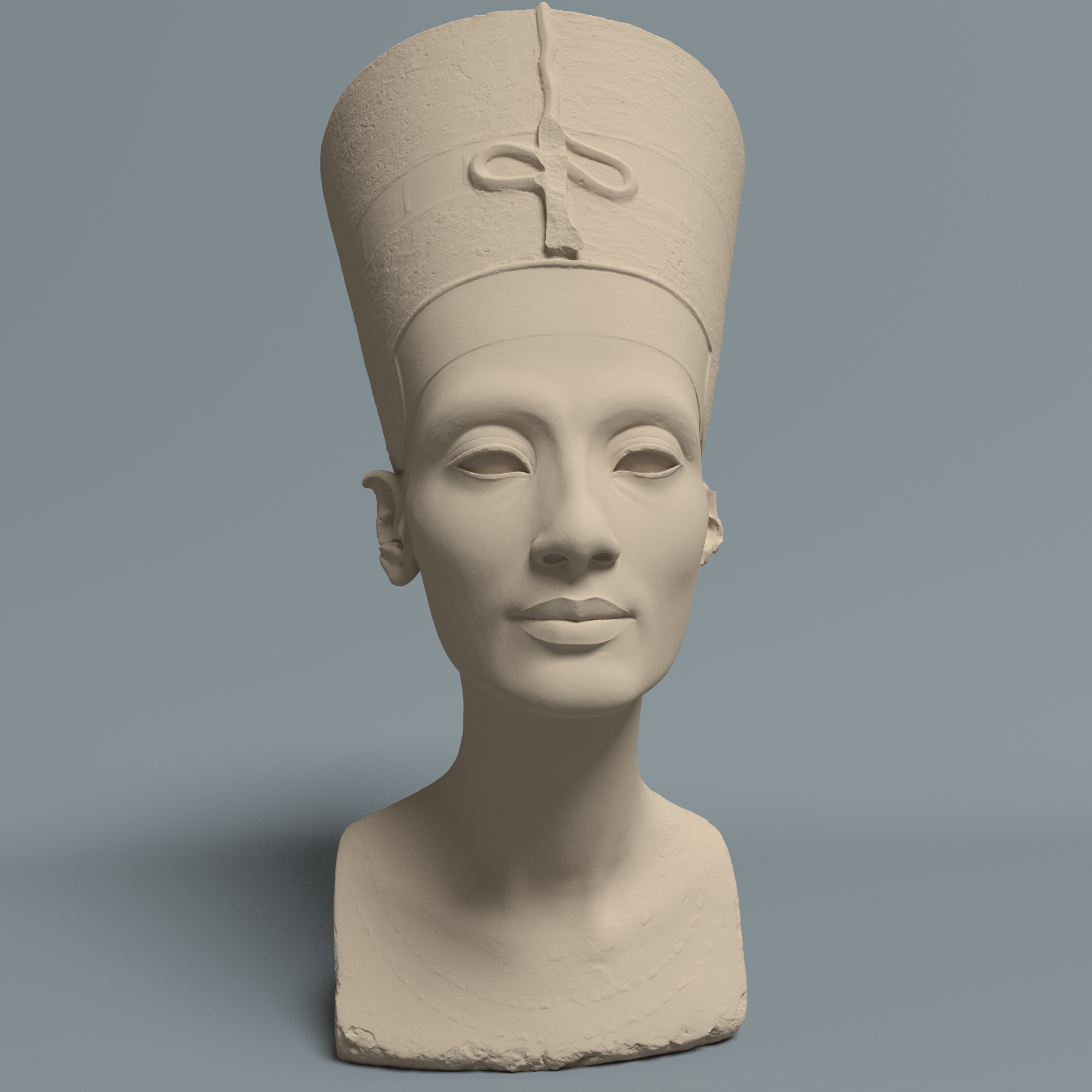

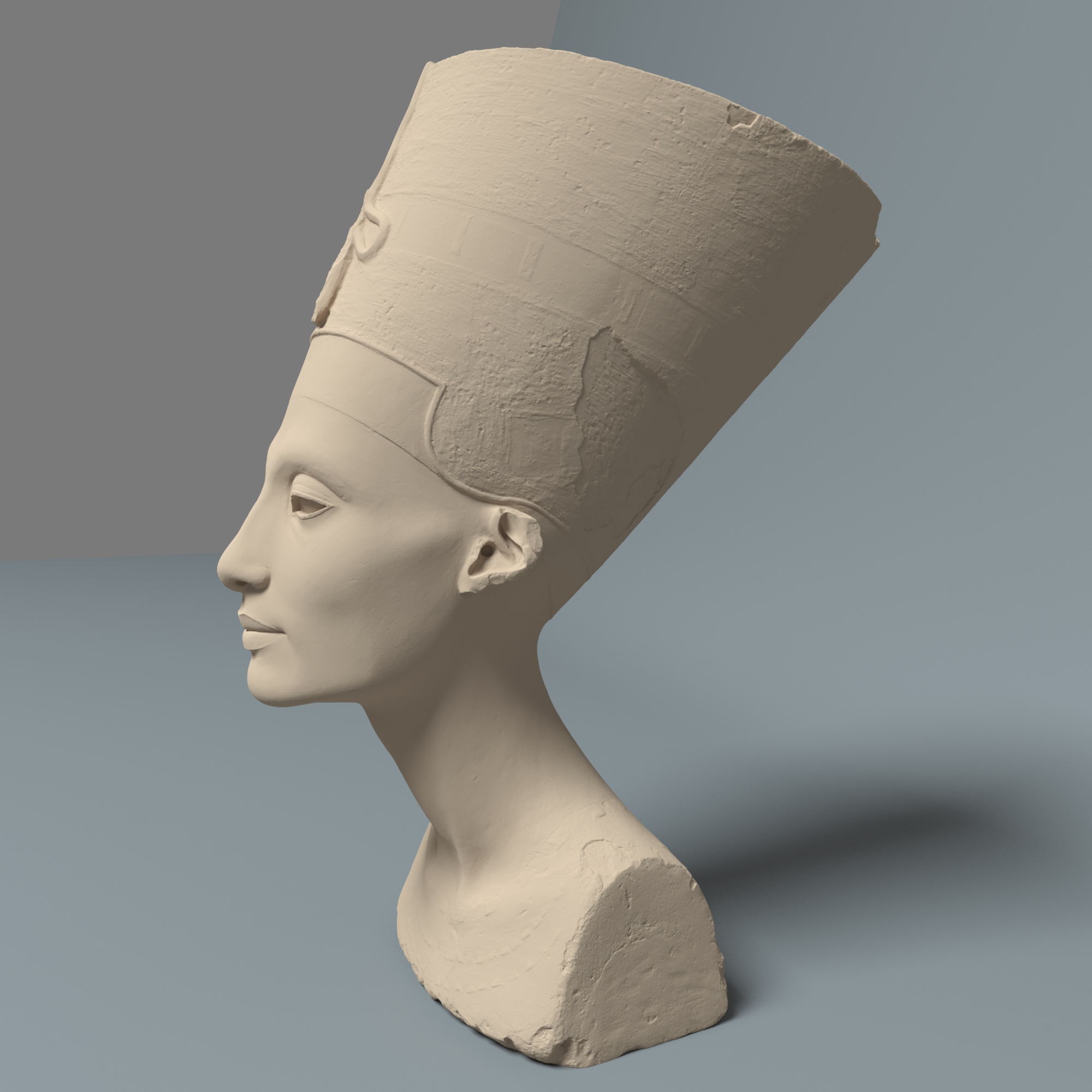

Nefertiti bust:
See http://nefertitihack.alloversky.com/
I added STL support so I can read the file.

Post by OnoSendai » Mon Feb 22, 2016 10:33 am
Oscar J wrote:Very cool Nick. Polycount? :shock:
Added STL to what? Skindigo?
Just over 2M tris I think. I wrote a little more about it here: http://www.indigorenderer.com/content/nefertiti-bust
I added STL support to Indigo, e.g. Indigo can now load STL files directly, much like it can load OBJ files.

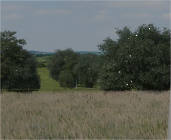

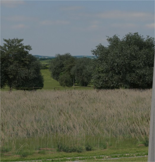

Hello guys,
I have a doubts about something, I have some flake artefacts in my scene only onto few leaves of trees.
I think this appear only on the leaves normal compared to the sun disk.
All leaves are in double sided thin material with diffuse material as sub mat (same in front and back)
I think it is because of the value of the roughness (front) I put 0.004.
It means any sens for you?
(5000 spp close-up)
errare humanum est
Post by OnoSendai » Sat Apr 09, 2016 2:34 am
Roughness of 0.004 is way too low. That's like a mirror.
Post by PureSpider » Sat Apr 09, 2016 3:51 am
In indigo, roughness doesn't go from 0 to 1 unlike in other renderers.
Roughness of 0 means it's a mirror, while higher values mean increasing roughness, getting closer to diffuse.
Post by OnoSendai » Sat Apr 09, 2016 5:09 am
PureSpider wrote:In indigo, roughness doesn't go from 0 to 1 unlike in other renderers.
Actually it does for double-sided thin.
Jay-ko
Posts: 138
Location: Paris

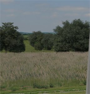

Post by Jay-ko » Tue Apr 12, 2016 5:12 am
Thank you, of course it is better like that :)

Post by Oscar J » Tue Apr 12, 2016 5:25 am
Looks quite photorealistic actually, but could use more contrast IMO. :) Or maybe this is just the look you're going for?

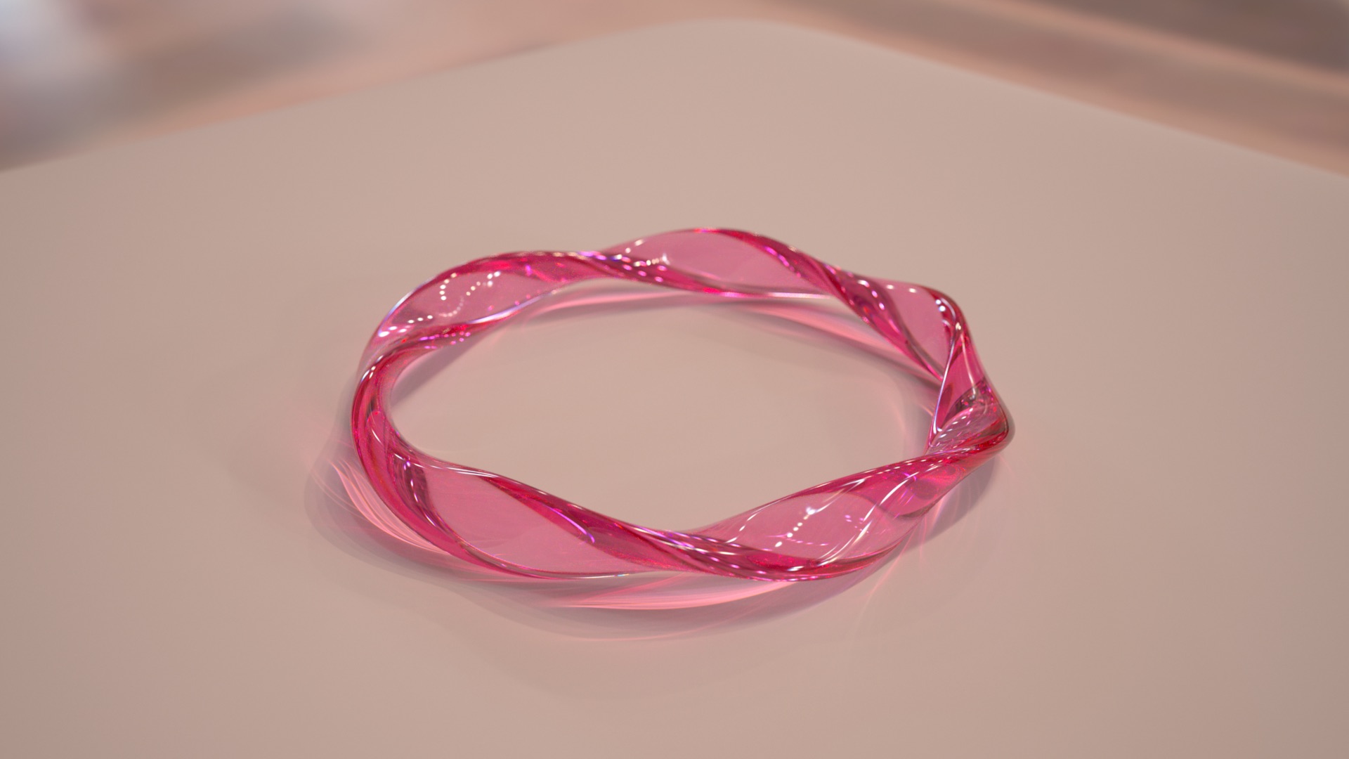

Post by Headroom » Tue Apr 12, 2016 10:24 am
Just a very simple exercise to see how V4 would perform compared to the latest V3. about 15% more samples per second with BIDIR MLT.
The caustics turned out nice enough to hopefully qualify for a simple rendering ;-)
Post by Oscar J » Tue Apr 12, 2016 10:29 am
The caustics are super pretty! :shock:
Post by Headroom » Tue Apr 12, 2016 10:34 am
Thanks! The trick to nice caustic are many small light sources. As I was too lazy to set all that up myself I used the St.Peters dome light probe from here :
http://www.pauldebevec.com/Probes/
For the ring I used the ruby material from the mat db.The rest was done by Indigo.

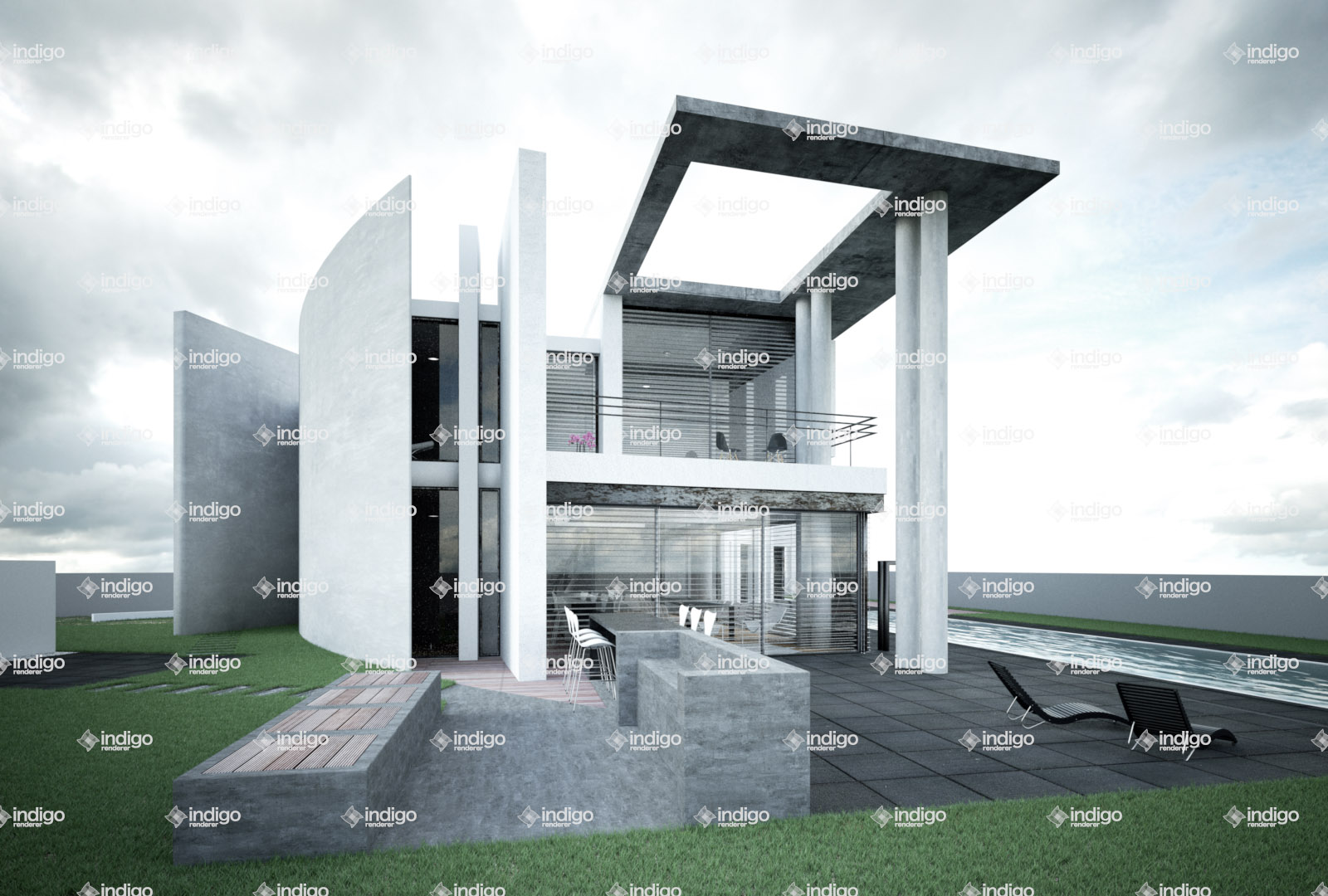

Post by Oscar J » Thu Apr 14, 2016 9:00 am
Nice! When do we get to see this without watermarks? :)
