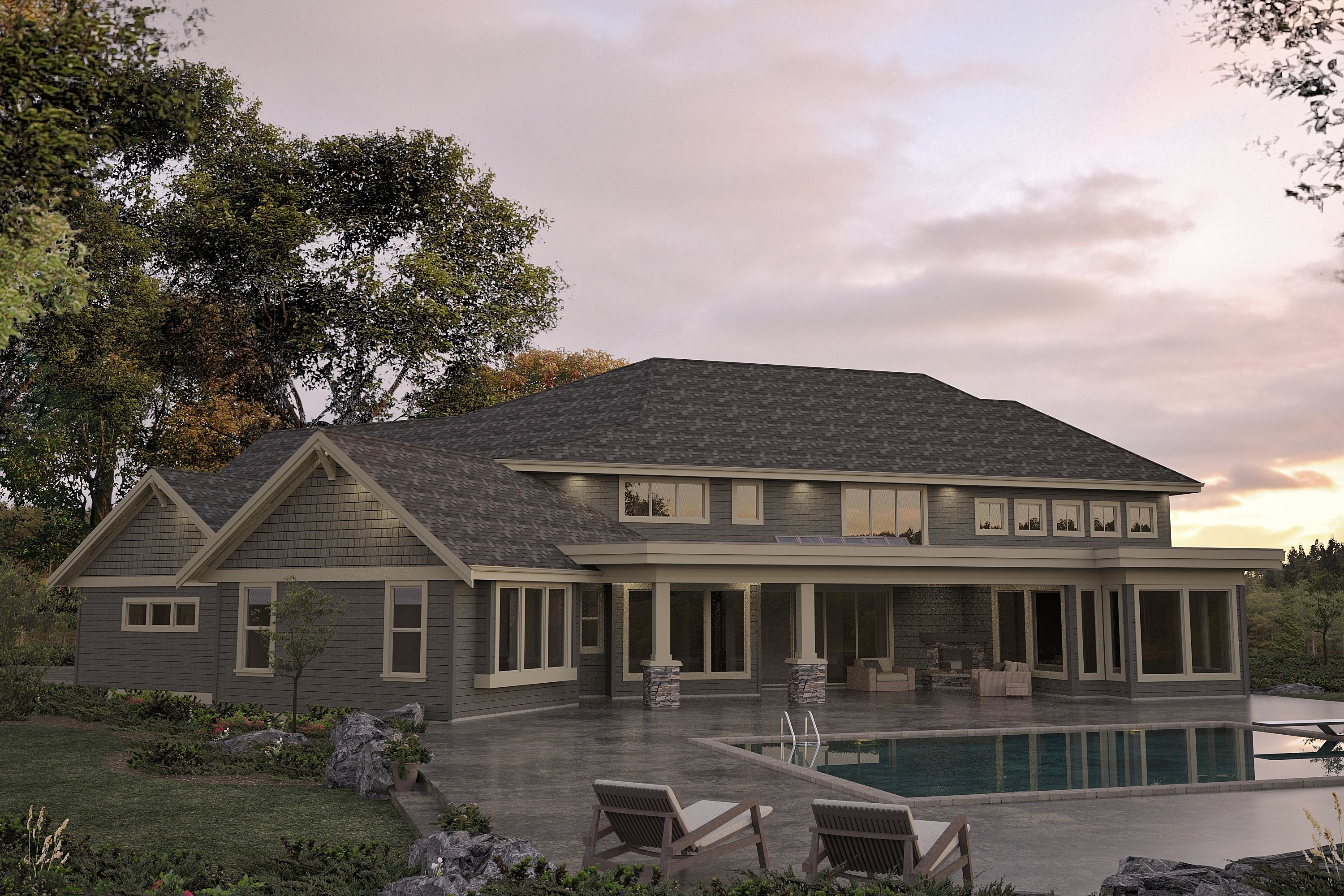

Hello, was wondering what software you guys use for touching up fireflies and what not. Any feed back on the attached image would also be appreciated. Thanks

Not all that much can be done about it in post except manually repairing it. Raise the SS factor or try BiDir MLT while the developers are working on their photon mapping.
Edit: You don't really seem to be suffering from fireflies. What you have there is just noise. Let it render for longer or alternatively, seeing as the noise mostly seems to be coming from your artificial lights, crank up the emitting power of your lamps and then lower them in the light layers panel to retain the balance. Higher emitting power means that Indigo gives your lamps a bigger share of the total rendering power.

I see, I'll add a couple of 0's to the emission scale and let it grind. Thanks for the tip!
