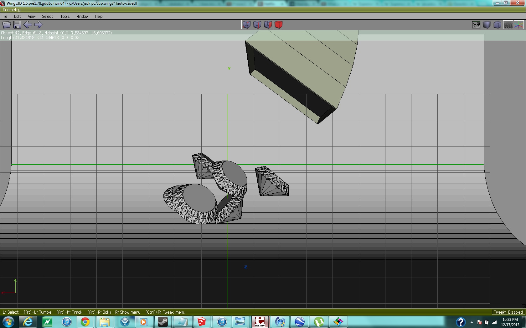

Hehe, very simply actually.Godzilla wrote:Cool looking diamonds
How did you model them?

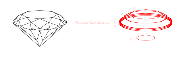

Interesting, though if you ever want to try modeling them realistically, I've found that creating circles with various numbers of vertexes, spacing them vertically, then bridging between vertices to be an effective method. To make the process even quicker, you really need only model about 1/8 or 1/6 of the diamond, then rotate that section around the center.
I made a little diagram, because I realize this isn't a very clear process description. Numbers correspond to # of vertices in each circle.

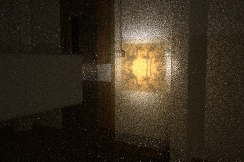

Been a while since I've posted here ^^
Trying to re-create an effect I saw much earlier in the thread...
http://indigorenderer.com/forum/viewtop ... 07#p123007
I'm getting a bit of an effect, but not exactly what is being produced there. At first I modeled it as closely as he could in his design here http://indigorenderer.com/forum/viewtop ... 93#p122993 but the first lens before where the image plane is blocked all light from coming out when I had it in.
The Image Plane part I couldn't figure out, and at first I tried a transmitter blend material but this only cast a shadow on the wall - it didn't show the texture.
I then set the material to be a specular material with the Absorption Map set to be my jpeg.
Now I was getting the texture projected onto the wall (And a very faint volumetric light effect that hopefully will get stronger over time), but it's... Kinda messed up. The image looks to be duplicated and flipped over, overlayed on top of the other one.
http://sylxeriaguardian.deviantart.com/ ... -422363451 Is the image I'm using - a drawing I did a few days ago ^^
I'm a bit at a loss as to what to do. I'd really like to recreate the projector effect vl_dm made in the previous links, but this is as far as I've been able to get.

Try a specular glass pane with the outer face using an absorbtion layer (or whatever it is called in your application). This is the purpose of the feature.
You can achieve this by editing UVs so only that face is bearing the texture, or by using two specular materials applied at the face component level sharing one medium.
Try it with glass acceleration on.

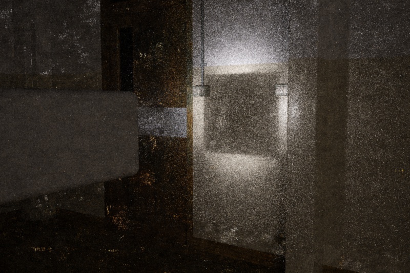

Tried that earlier and all I got was a shadow being cast.
(Glass material applied to the cube, except for the polygon facing the lens and wall which has the bitmap absorption material applied)
Putting the image-based one on both faces - the one facing inward and the one facing outward - was the only thing that produced results for me, but they're incorrect results =/
Is what I get when I have the UV set to have all faces except one be regular glass, and the last face being the material with absorption (Is otherwise a duplicate of the standard specular)

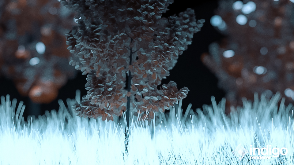

Hey guys,
Here's a quick render I did with the Double-sided Thin material (for the tree). I know it's kinda noisy, but right now I only have a Macbook and it takes forever to render.
Nice one JonasWe!
