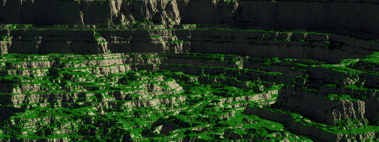

More room this time, a total of 116 mill.
Re: WIPs: CTZn
Awesome stuff yonosoy!
Re: WIPs: CTZn
Impressive, my rig can barely provide the quarter of this definition ! High enough so I have witnessed these artifacts with view-dependent subdivisions already. What were supersampling level and max triangle length in pixels for this render ?
Now this is crying for shading, do you have plans for this, or instancing yonosoy ?

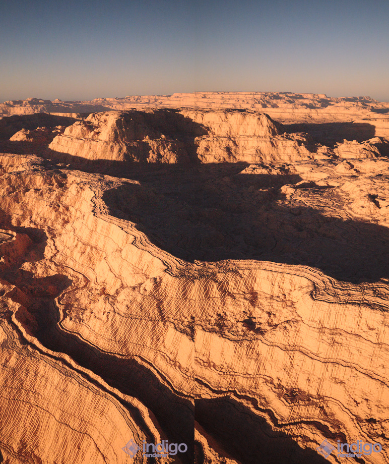

Let me some days to put this in order. For the next try the solar spectrum must be express as real tabulated.
(It depends on your amount of ram at the moment, and by hand), five geosun in five light layers gives as result five photographs for the same time in atmospheric simulation, a way to study in exteriors. Maybe for indigo fits the possibility of more than one extra atmospheric sun. Some positives test whit perfect spheres.
Yes, Cindigo from windows gives here a range of 40-60 millions of instances (?) maybe. Flocks are not ready yet. Basic shapes for vegetation and birds to start, but in a procedural way, taking some advantages from houdini... then clouds of points and channels of movements aplied for each specimen must be collect. In fact there are single animated bird.
It`s an embraceble start point. Thankfully to this little team with more effort than "giants" and for the posibilities to grow up even without license in this open forum.

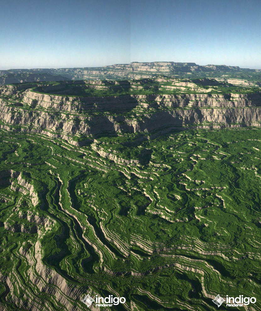

Re: WIPs: CTZn
<super_sample_factor>1</super_sample_factor>
<max_num_subdivisions>22</max_num_subdivisions>
<subdivide_pixel_threshold>2</subdivide_pixel_threshold>
A hundred of mill. tri. for better result and so much RAM saved !!! Thanks a lot.

Re: WIPs: CTZn
Well the albedo was initially meant to illustrate the point but it became messy further along, it's bicoloured really.
I'm keen to blend the mossy rock material from Fakeshamus in after all.
edit: nice update ! I'm suspecting that the stairing artifact can be reduced by playing with the pixel threshold further, introducing more decimals
<super_sample_factor>2</super_sample_factor>
<subdivide_pixel_threshold>1.324</subdivide_pixel_threshold>
or
<subdivide_pixel_threshold>0.6</subdivide_pixel_threshold>
Blind shots, and ignoring the tuning for max_num_subdivisions. Thanks for the clarification Zom-B, I came to doubt about it.

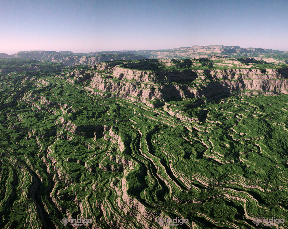

Re: WIPs: CTZn
possibly the displacement artifact is in fact a shading artifact (pretty sure, I seem to remember).
Also this set would require a setting twice as big for the least; 1Km width is too small for this shader scale.

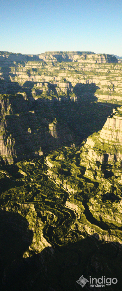

Blind shots yes, an adventure. Needs a lot of work... Scale 33 (more than 1000 km. square).
This is the last for first impressions.
Could voxels play a role in synthetic vegetation for this scale?
EDIT:
Subdivision algorhytm do necessary n/2 - 1 (aprox) global subdivisions before start the partial ones? Is not possible to try to displace a global mesh in this way ...
Artifacts more over 23 subdivisions.
And seems to not be the same SS 1 pix. thres. 2 than SS 2 pix. thres. 4, ... (so confuse now).
Nonetheless will try to work around this.

Re: WIPs: CTZn
Instances are better than voxels. Even voxel engines use instancing !Could voxels play a role in synthetic vegetation for this scale?
In the context of this thread it is possible but tedious because voxels are a Maya feature and ISL for the terrain is Indigo's. Getting the displacement data for correct object positioning back in Maya requires to extract a map by rendering it with indigo (normalised base emission, displacement shader as emission, linear tonemapping, ortho camera).
Indigo does n-1 subdivisions if I'm correct.EDIT:
You want to input the final pixel threshold multiplied per the number of super-sampling levels.
For instance if you want a triangle size of one pixel and that your ssl is 3 you want to input 3.0 as the pixel threshold. This would come down to 1.0 after the framebuffer's reduction to the final output.
Oh and by the way thanks for sharing back yonosoy. A veces mejor que lo digas en español al mejor porque con la traduccion se pierde hasta el sentido a veces

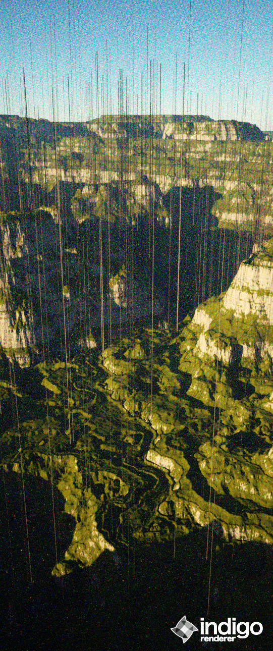

Re: WIPs: CTZn
Yay at artifacts. No wonder, the canyon shader is one twisted simple hack really.
You love the atmosphere model and ISL, good on you
Search for implicit surface in the forum.
