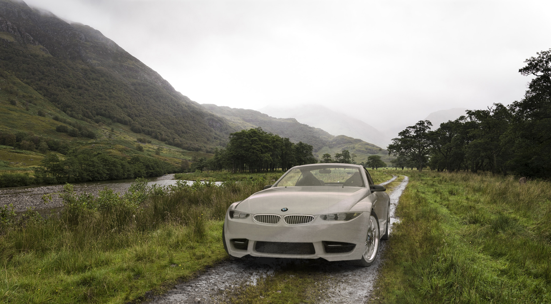

Post by Antonis777 » Wed Oct 09, 2013 12:08 pm
Just testing Indigo's new shadow catcher feature. Hdri and backplate from Moofe. Sketchup model made by Irmantenis.

Post by CTZn » Wed Oct 09, 2013 4:06 pm
Very much a nice feature !

Post by Zom-B » Fri Oct 11, 2013 12:31 am
Seems somebody stolen the engine of that car :D
Using alpha renders you need to double the layer of the car in your 2D app, since the car is still a little transparent (longer render times, lower SuperSampling (!) and radial splatting help here!)

Post by Oscar J » Fri Oct 11, 2013 2:38 am
Perspective looks good, but the car looks a bit pale and flat for some reason. Would need some more reflections and contrast to go with the backplate I think.

Post by Antonis777 » Fri Oct 11, 2013 4:49 am
Zom-B wrote:Seems somebody stolen the engine of that car :D
Did duplicate car layer. Hope this seems better and not flat.

Post by Oscar J » Fri Oct 11, 2013 6:47 am
That does look better, but now the problem is that the backplate is much sharper than the car.

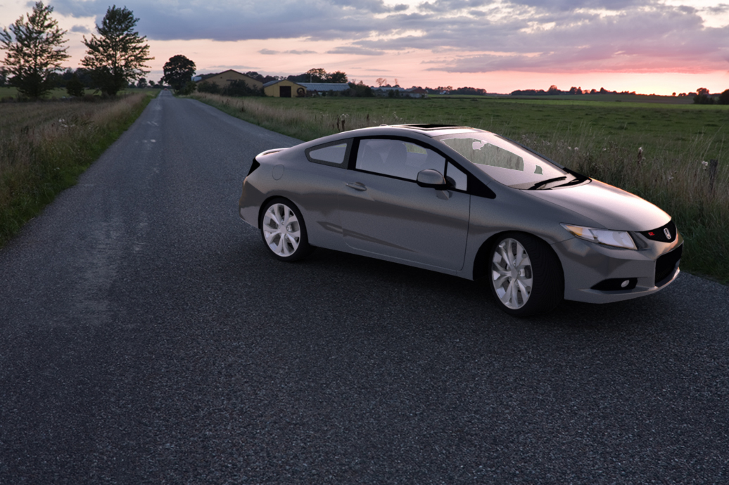

Post by Antonis777 » Fri Oct 11, 2013 6:56 am
That's correct. I increased car size in Photoshop to match nice with backplate, because I use demo indigo version (0.7 mpx output etc). Here's another angle. Don't know though how to scale (or zoom) model to have the right size according to the picture. How could I use a reference item?

Post by Pibuz » Fri Oct 11, 2013 7:25 pm
Oscar J wrote: That does look better, but now the problem is that the backplate is much sharper than the car.
The car is in movement SO it is a little blurrier :D
