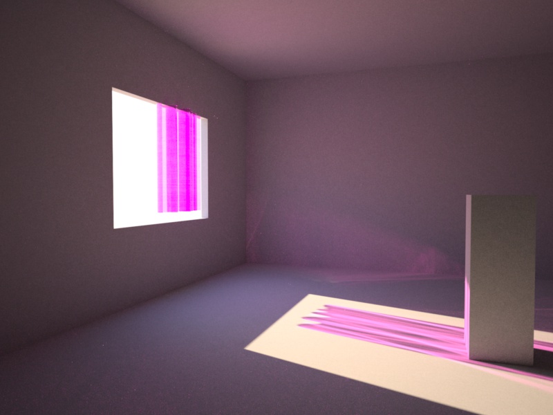

Just a minor update. I experienced something weird with the curtains. The curtain in the middle is all clear, which the one on the right, which is exactly the same, just copied, is full of noise? Any remote idea what could be the cause?
I've rendered with BiDir+MLT now, and the image seems a lot better, although I get maximum 21 samples/sec... I'll replace the other curtains with the one in the middle, and try to run the rendering again.
And of course, I'm interested in Pibuz' famous plant trick :D

Post by CTZn » Mon Jul 25, 2011 8:26 am
Very nice progresses here !
I made a blend of diffuse-difftrans, and then blended that with nullmaterial, using a bumpmap as blend texture. It takes ages and ages to get rid of the noise though, it seems..
Seems a good material setup, but you should activate step blend for the bump texture used for blending. That will make the map B&W by the 0.5 value and help a lot with noise.

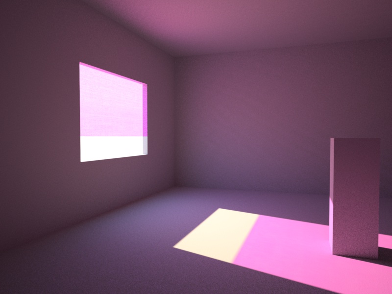

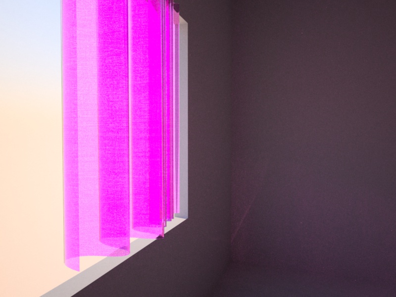

Hello, I was trying all day to make a curtain texture with no success, I was trying to do it blending two materials, as I read in some posts but it seems that the material editor in Skindigo 3.0.15 changed, so there is no more diffuse transmitter material (or I didn´t find a way to do It) so after a very frustrating day I decided to download a material and start from there. I downloaded colored glass (http://www.indigorenderer.com/materials/materials/967) and changed,
I just add another texture to surface color, I had another problem here because the size of the texture was too small so I click on position map and I changed ( I don't know how i did it but It worked :lol: ) and thats it. I put a red fabric texture so I can notice the curtain and the light reaction.
As I said, I tried to blend materials but the result was a black shiny surface, I can´t find the way to blend, and no diffuse transmitter either.
Im happy with the result, but frustrated at the same time because I don't even know how I did it. :?

Post by Jardar » Mon Sep 19, 2011 7:42 am
Hello alffrad!
I can try to explain, but I'm not quite sure I know how I did it myself :D
The material itself is a blend between two materials.
curtain_main (blends two other materials with this this linen texture; b=-1, c=1)
-→B: nullmaterial
-→A: curtain_blend blends two other materials by a constant value 0,300
---→A: curtain_transmitter diffuse transmitter, constant albedo 0,9686; 0,9686; 0,9373
---→B: curtain_diffuse diffuse material, constant albedo 0,9686; 0,9686; 0,9373
The material is then applied to a single plane
Hope this helps? :D
