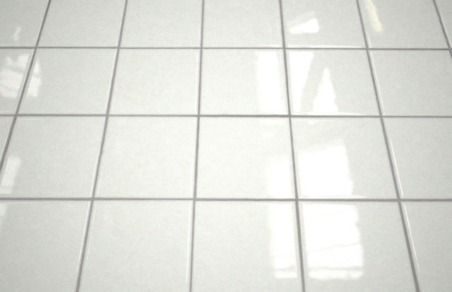

I have just uploaded my first ceramic tile material. It's a 100% procedural one (absolutely no texture used). I wanted to realistically reproduce the tiles of my kitchen & bathroom, which are not perfectly aligned.
Main features:
- Each tiles is positionned with "jerkyness" : random shift & tilt, to give a realistic feel
- Corner roundness and edge shape are fully configurable by tweaking the shader
- The joint plaster is quite simple, it's a blend of two diffuse concrete-like materials, so that at certain places the looks more "dirty". The plaster is slightly bumped with random craters.
- The ceramic itself is a simple phong, easily customizable for more tile colors. I added slight wavy bump to reproduce the reflections of my bathroom's tiles (I stayed a long time in my bath yesterday to analyze that)
- The final blend between ceramic & plaster is a shader taking into account the 3d profile of the ceramic, and the 3d profile of the plaster to provide a wavy "flood fill" effect of the trenches.
This is a 100% bump, no deplacement material. I will update soon with another version using displacement, to allow nice close-ups.
Look at the testrenders below:

- The same exact material as uploaded. Tiles are 10cm x 10cm
- ceramic-test-5.jpg (39.94 KiB) Viewed 20397 times

WOW
even better than the first version. Looking forward to using it, thanks for sharing!
galinette, you think you could add some short comments to the code, to give a better understanding of what each segment is doing?
It is looking much better than my textures!

Niiice. I hope you enter in the material competition!
