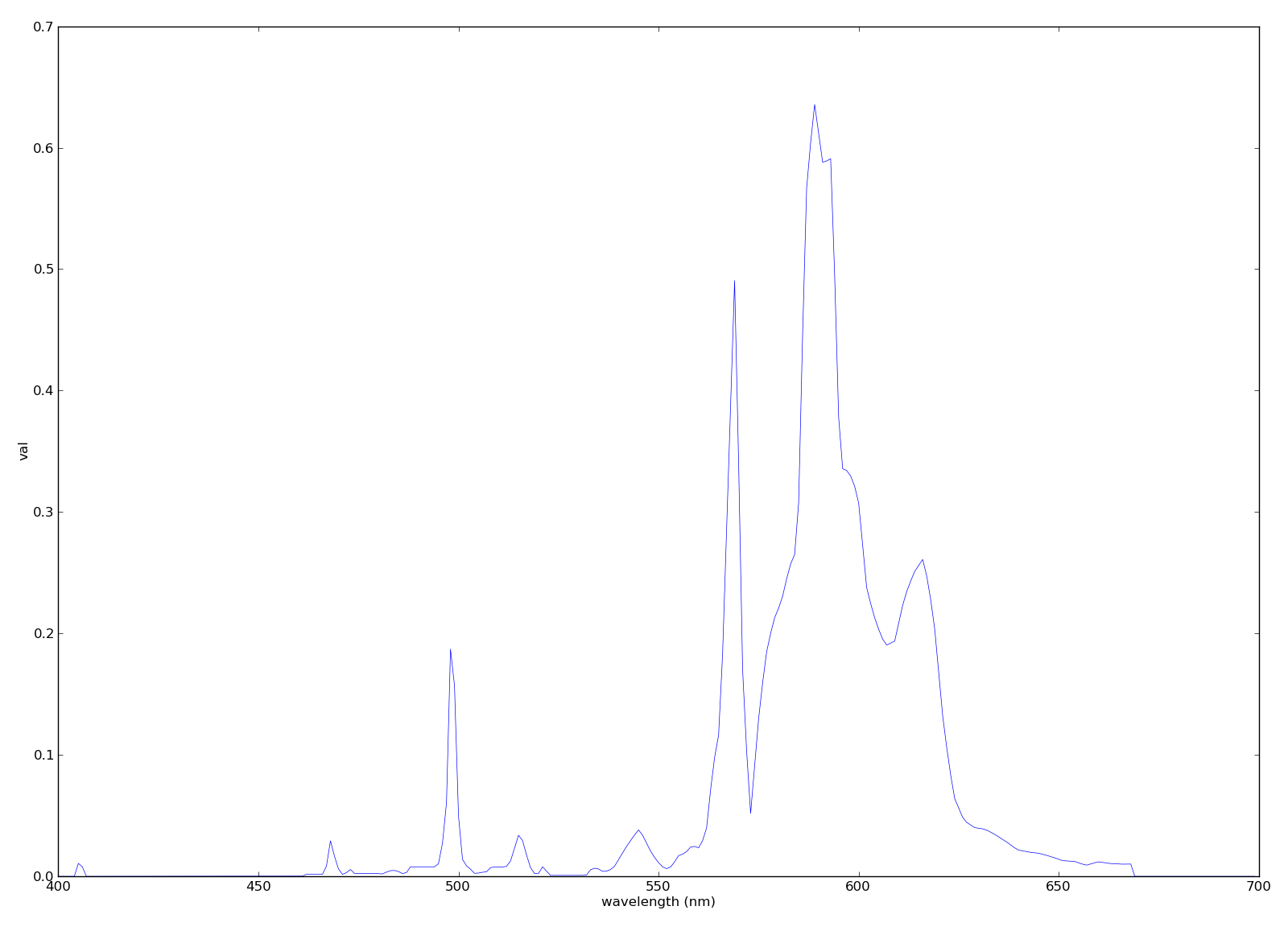

Post by dougal2 » Sun Jan 31, 2010 2:20 am
Here's one you can directly compare with your own data:
Mercury Lamp - Osram HQA 80W (HPM2)

Post by galinette » Sun Jan 31, 2010 2:39 am
Hard to see on a chart.
Here is a close up on the leftmost peaks of the HQA80W.
Interpolation is not linear or cubic interpolation, but equal to the local average of the source spectrum, so that we keep the same peak area (and hence the area ratios of the peaks, which fix the color).
