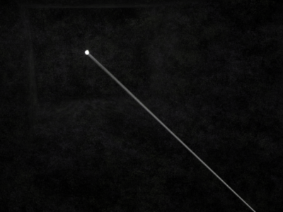

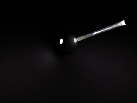

Post by pixie » Wed Aug 06, 2008 11:21 am
Parabolic mirror set-up
Site regarding mathematical functions
How to get focus out of a parable
Well, it works more or less... I added a cylinder with ss on the right light on the left it's au naturel :) Still you will find that the light is parallel although not like in a laser perhaps... most, not to say all, of the light in the floor is indirect lighting from the ball.

Post by alex22 » Wed Aug 06, 2008 2:29 pm
Nice, how do you do the parable?
I tried it with an special IES and an squashed halfsphere as mirror, but I can't get it parallel, its always diverging a bit.
The IES is a light which sends out max between zero and one degrees and null above that.
20 Blender units from source to wall. At the wall the ray is about 0.2 BU in diameter.
