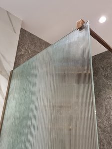

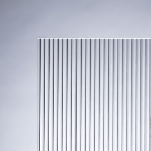

I'm a hobbyist with this render, I use it in conjunction with SketchUp 2017
As in the subject, please provide instructions on how to make such glass.
Colorless, not completely transparent.
Smooth on one side, visible groove on the other (photos attached)
I really want this similar glass.
Best regards

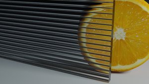

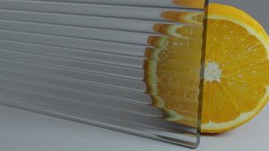

I started by doing displacement but ended modelling the glass. I did it in cinema 4d, but I can send you the model if you give me the dimensions you're planning to use

Sometimes I forget that real life also gives the same type of pictures as that of indigo xD
Posts: 2345
Re: Visiosun Classic glass / flutes glass
Post by pixie » Fri Mar 28, 2025 11:44 pm
bidir test
vs
path tracing on gpu diffuse depth 12

Aha... I thought you could get this effect using a texture?
For testing, I'd like a model measuring 817x2017mm and 8mm thick.

Indigo is the renderer, I used Cinema4D for modelling. I tried texture, but modelling gave me not only a better result, but smaller memory usage in the end. Once I got the desired effect on 3D, one might create a displacement texture out of it.

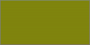

This time I baked the geometry into a normal map, what you see is just a normal map applied to a box. It might be all that you want.
