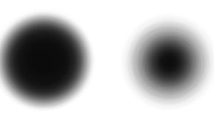

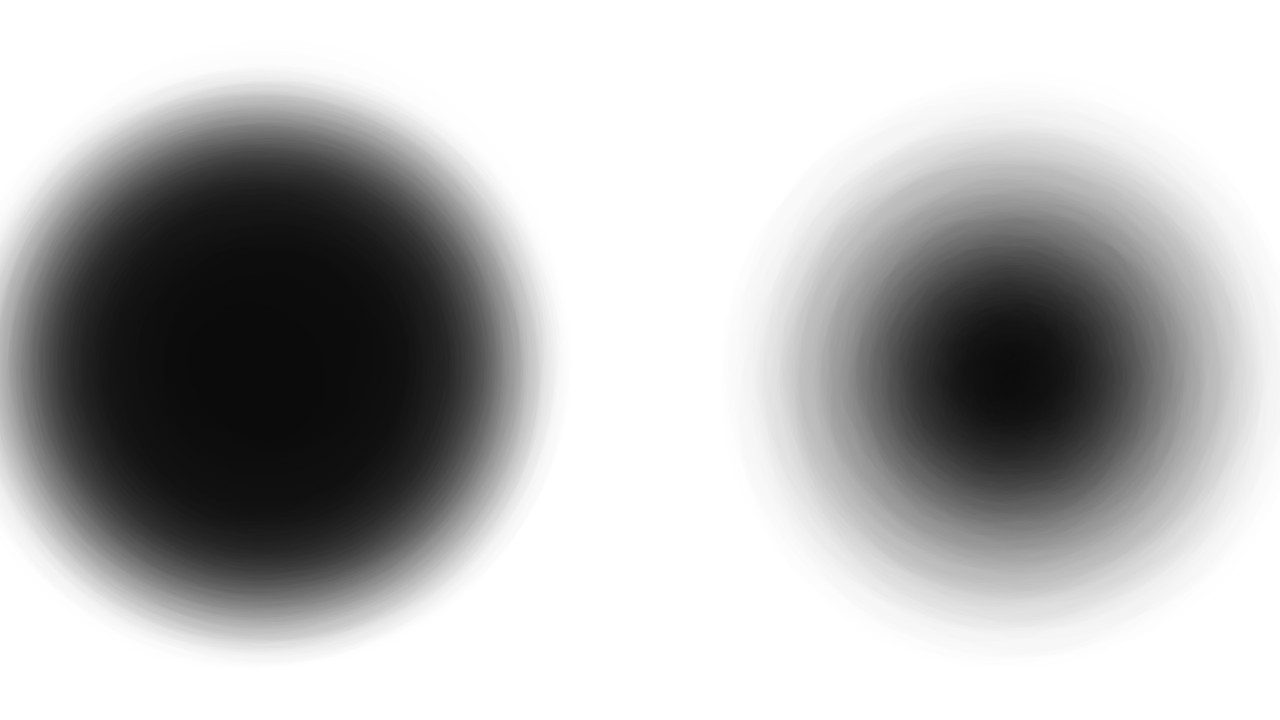

Hi,
I need to create a fog material but the actual medium system is not accurate enough for the purpose.
What I need is that the sphere, or the box containing the fog material/medium becomes less delimitate. that the shape of the box disapears completely.
I mean that the density of the fog should be more progressive, like a much less at the entering of the box, and more and more dense as you aproach the center of the box ( no matter its shape), especially on very large scales ( millions or thousands of millions of kilometers ).
I'm not sure if I explain correctly so I I join an image illustrating what I mean: Imagining both spheres are the same diameter, the sphere on the left is more like the actual model of absorption for the fog, and the sphere on the right would be more like what I need.
Is there a parameter or another way to modify this please ?

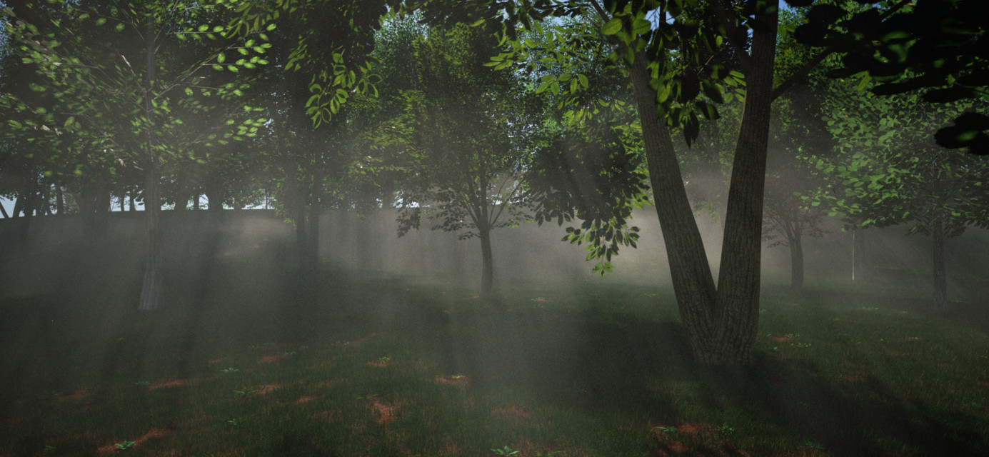

Eneen : Try to put the middle of the height of the fog box at the ground level, and adjust its height, and the values to get the result your looking for ?
That's my little test here : By the way if yonosoy comes around, this is officially my first success with visible god rays on a simple render

Boom!
like this a lot!
Re: Progressive Fog Density
Congratulations Onizuka and thank you the squirrel, more code to play...
Thank you guys
