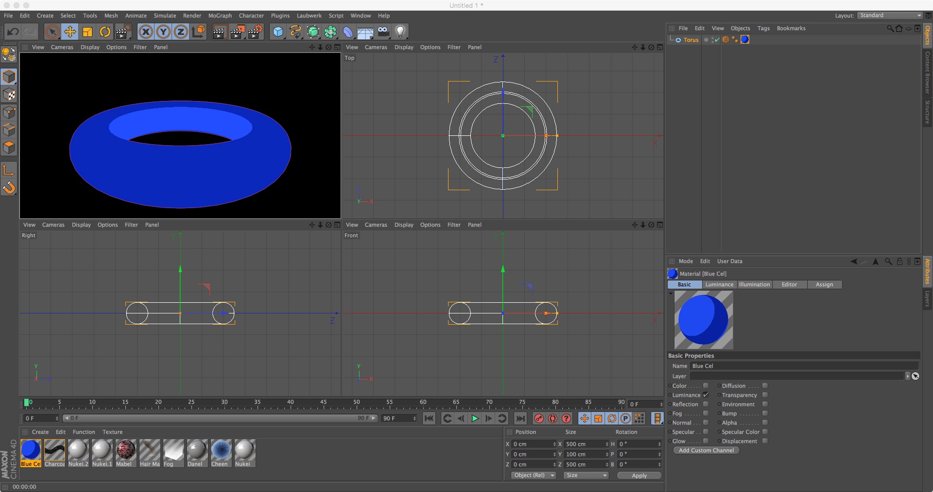

Luminance slot?

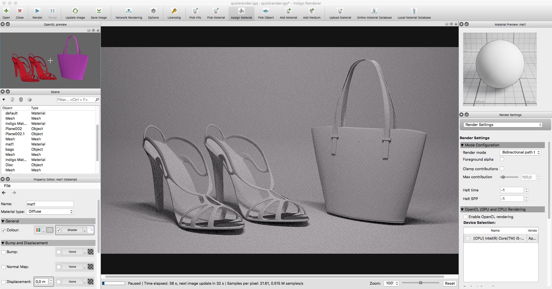

To me it seems not work.
Re: Material that imits Vray's Toon effect.
Post by CTZn » Mon Aug 08, 2016 6:53 am
The shader is working but it is not fit for your scene, contegufo. It works best with smooth surfaces. Subdividing geometries may produce better results too.
