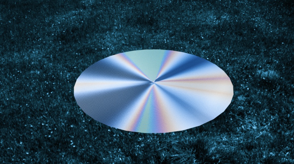

Post by Oscar J » Thu Mar 03, 2016 7:18 am
... actually one can sort of make it look like a CD. This is not accurate though. :)

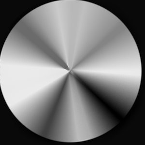

Post by Oscar J » Thu Mar 03, 2016 8:05 am
Try using this map I made as coating thickness with interference on. You need to play around with the values inside Indigo a bit though.

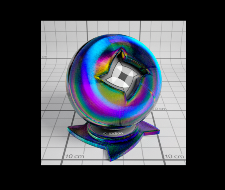

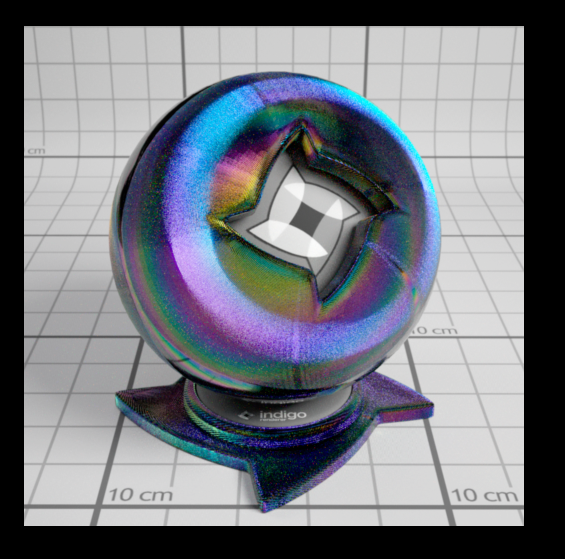

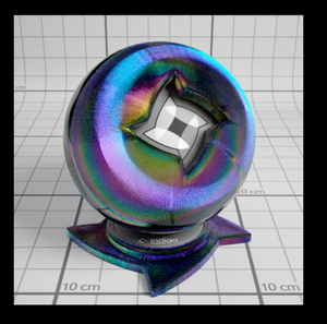

Post by Originalplan® » Thu Mar 03, 2016 10:36 pm
Thanks Oscar, i did a little test i think its kinda a good fake CD.
@galinette i used your ISL script from one of your materials and tweaked a bit.
Has a plastic top
No plastic
