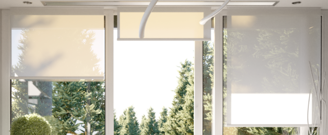

I'v yet to understand how to create materials… I think in the mean time i've better with using pre-made materials but i haven't found what i search for. I'm searching Polycarbonat material to use in an architectural context.
I'va attached an example. It's that kind of milky PC (polycarbonat) or semi-transparent white plastic if you prefer i'm searching for. I thought it would deb pretty easy to find for or even to create but it seems very difficult for a newly even with watching the videos i found. Any tips or links to material that could render similar ?

A diffuse transmitter material should work or at least should get you started.

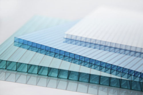

Hi Lexington! Architect here
The material you're referring is NOT polycarbonate, but U-glass (sort of an industrial prefabricated glass, with a L or U section extruded). The frosty look you see comes from the surface treatment, there are many but the most common are little vertical lines, and superficial frosting or speckle.
To represent the polycarbonate material you basically have to MODEL it: each panel is sort of a series of long vertical cells, so the vibrance of the final architectural effect derives from the light being fragmented by the cells.

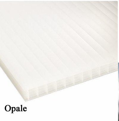

Thanks for your answers.
I get it. Thing is there are lots of different PC. The one i'm tryin to render is called Opale and i got the texture from the manufacturer. But not talking about the texture (i can design it as you said in SU or maybe tryin to emulate it with bumap from the file i got from the manufacturer)… I'm not even close to emulate the material itself wish is something semi transparent AND white. When i apply frosted glass thing it's really 'not white'.
Exemple attached, it's not the real material (i'm searching right now) but it's close enough.

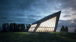

Though this was an interesting challenge, so I did a quick render to try some different methods.
This is a blend between a diffuse transmitter, a white reflective phong, and a null material, the latter just to make it a wee bit transparent. Turned out rather cool
Render time was like three minutes on my four year old laptop, so the material renders quickly.

Don't worry, material setup in Indigo is pretty straightforward.
I'm working in blender, so unfortunately I can't help you with the Sketchup setup. I have attached the material so you can check it out for yourself.
Keep in mind that this material is a bit of a cheat. It's not physically accurate, but on the plus side it's fast and it doesn't require modelled thickness. To get that bright, milky look, make sure you place a couple of lamps inside your building.

Oscar J wrote:Though this was an interesting challenge, so I did a quick render to try some different methods.
I just love the atmosphere in that pic! This type of blend system is exactly the one I used in several kitchen scenarios, such as this: For such need, the blend with the null material could be done using a texture to simulate fabric, or fibers in structure.
