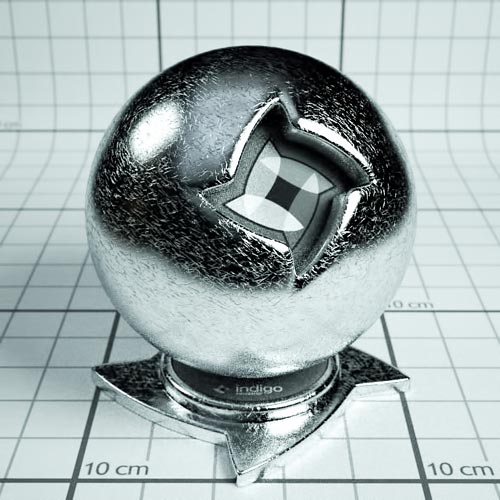

I like this material, but the size of the scratches is a litle too big
on my objects:
http://www.indigorenderer.com/materials/materials/340
How do i edit this??
Thank you in advance for any answers.
on my objects:

You could change the mapping/tiling options in your host 3D application or relplace it with a new bumpmap.

Can't It's a procedural map.

Sorry, didn't read it to the end.
I changed the vec.2 multiplier ("7") in the very second line:
to f.e.:
If you set higher values here, the scratches gonna be smaller.
Hope it helps!
def scratchcoords( vec2 pos ) vec2 :
vec2( 7. * ( doti ( pos ) + noise(pos*0.1)) , 200. * ( dotj ( pos ) + noise( pos*0.2) ) )Code: Select all
vec2( 30. * ( doti ( pos ) + noise(pos*0.1)) , 200. * ( dotj ( pos ) + noise( pos*0.2) ) )Hope it helps!

By doing so you are changing one dimension of the scratches, it's not an homogeneous change zeitmeister
That said scaling the UVs from within the host application should work too, being procedural this shader does use actual UVs. In this regard it is best to multiply them at their source in the shader, wich is getTexCoords(0). The multiplier can be greater or smaller than 1.0 but it must be a float (dot something), integers will cause an error.
Once you have multiplied the input UVs like so, the depth must be changed proportionally. Divide the depth by the new multiplier and you should be done.where mult is the float you choosed as multiplier for getTexCoords(0).
This way the shader will effectively be scaled proportionally.
(0.0005 / mult) * etcThis way the shader will effectively be scaled proportionally.

In fact both approaches are correct... But produce different results
CTZn approach, UV scaling, will change the overall scaling of the texture over the material, in a classical way. Do not forget to change the overall bump (height) factor : shrinking UV at constant bump height will make the scratches profiles too steep.
Zeitmaster's is proposing a more subtle change. The scratch centers are not changed, but they are shortened. Changing the "200" would have changed the scratch width.
I will try to convert this to a parametric shader as soon as I have time, since it is possible now
Etienne
