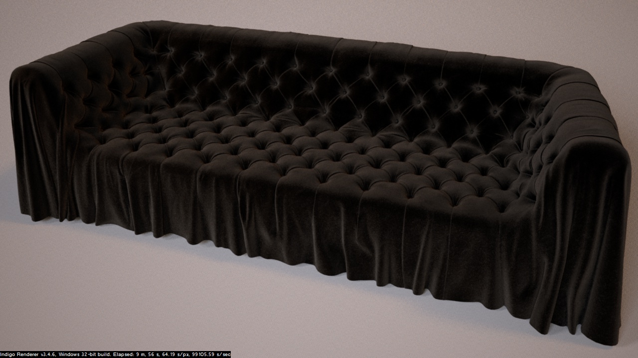

Galinette, sensational material!!!!
Carpaint!!!!!
Carpaint!!!!!

I want to make love to that material

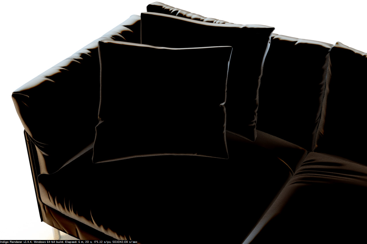

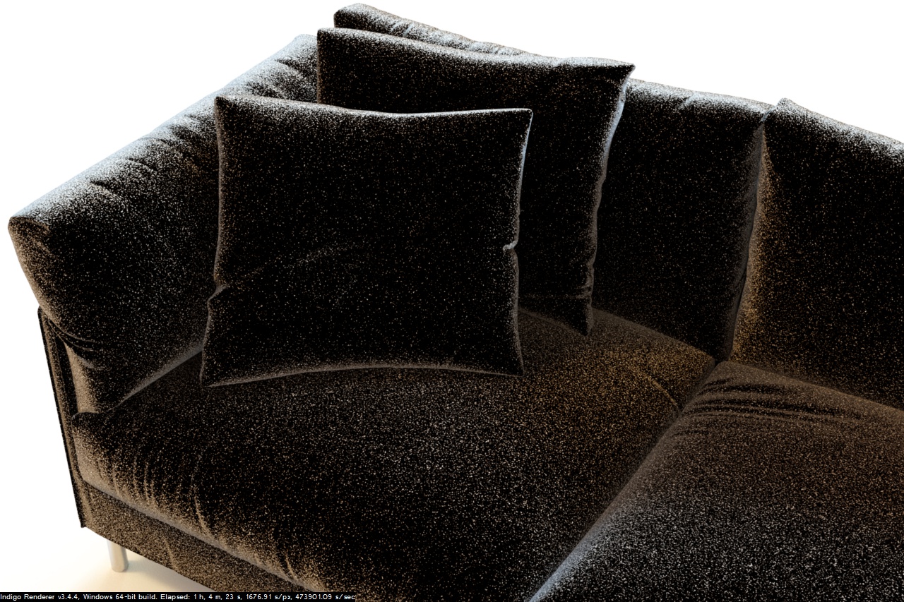

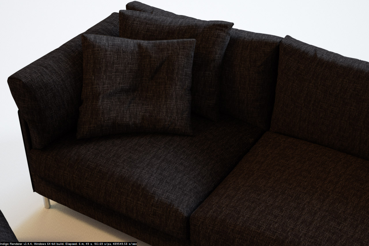

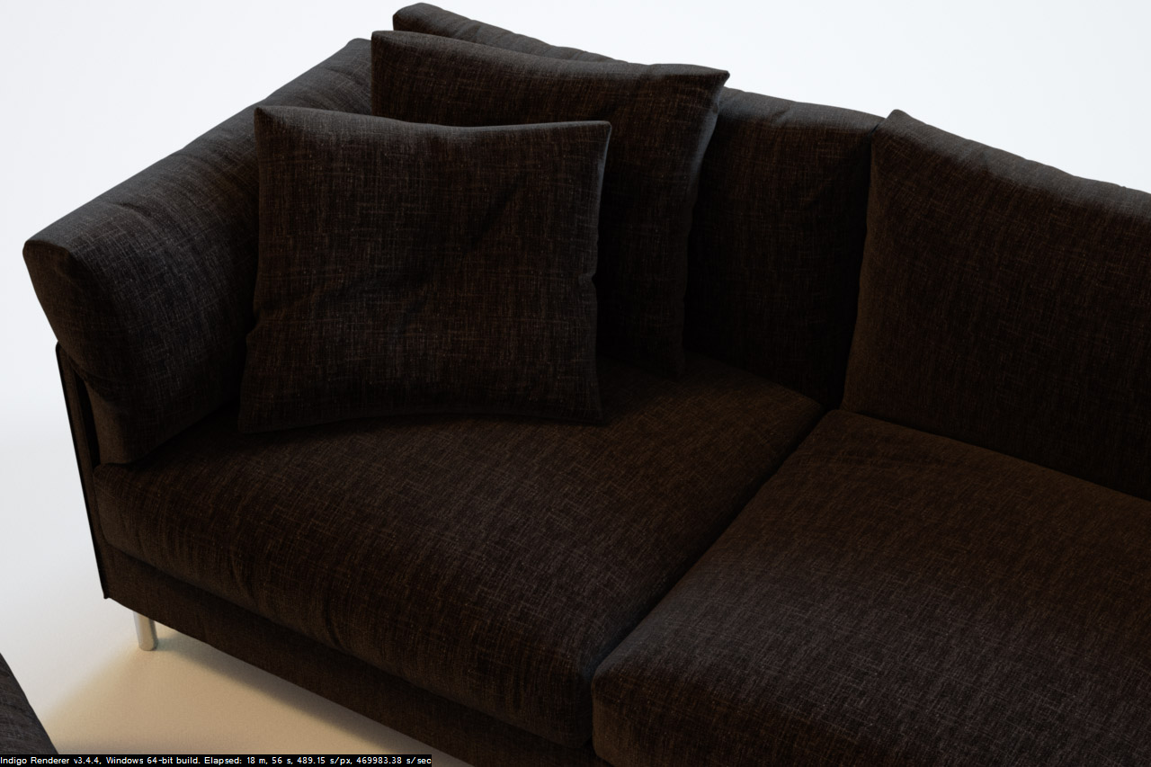

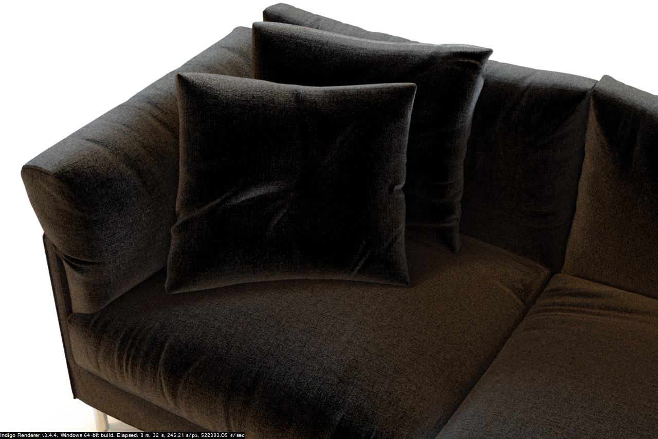

I'm also still testing with my "maxCosTheta()" function, here some example:
pure diffuse:
diffuse + maxCosTheta() material (50/50): The Key here was to set some Bump / Normal Mapping on the material so the transition of the maxCosTheta material get smoothed out nicly

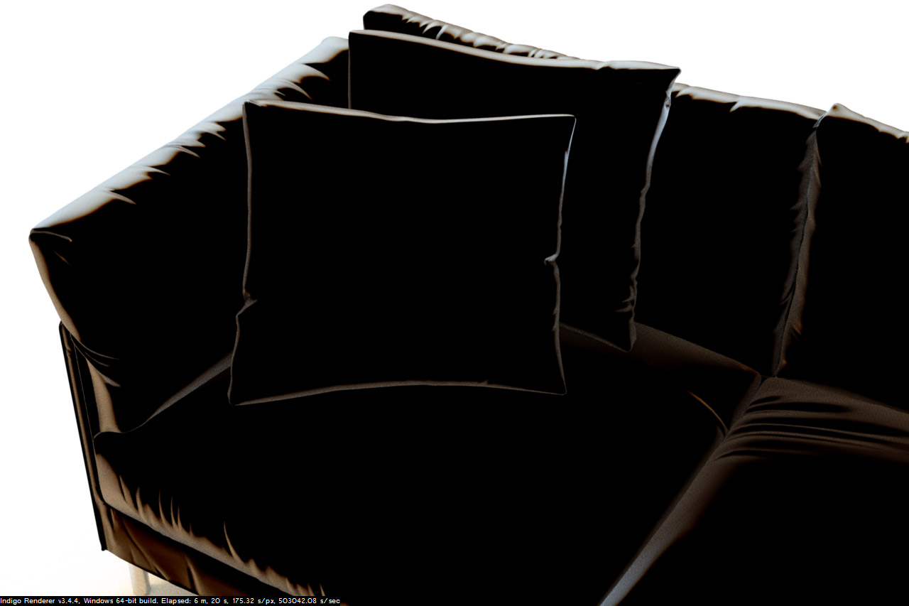

pure diffuse:

Very nice Zom-B, it's great that you are fiddling with ISL !
Besides using bump/normal maps, wich is quite mandatory anyways for this kind material, you can also add the "maxCosTheta()" function to a somewhat normalized, dimmed fbm.

Re: Material with custom falloff
looks great Ono, as usual
Any reason why these renderings are so slow compared to the one before?

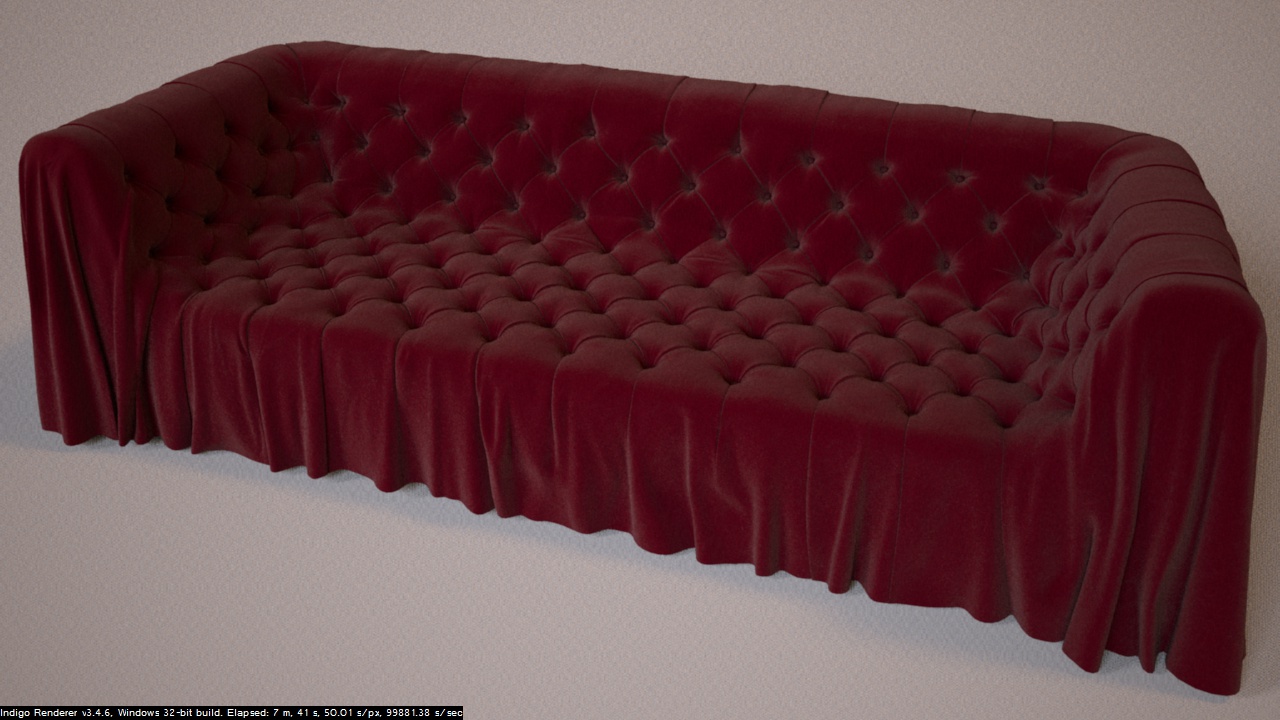

Red velvet material is GREAT! Complete new shader or modding of existing one?

OnoSendai wrote:Yup, it's a new material type.

Hi Pibuz,Pibuz wrote:@ Ono
It's kind of a modification of Phong, although it's almost a complete new material.

Lighting is the same, here are some example of the function with bumpmap and without:Pibuz wrote:No doubts that cosThetaMAT is way better than previous simple diffuse mat.
Seems like you sort of modified a little the lighting, or is it just a material response effect?
As you see I only introduced some bumpiness trough the bump channel of the material, I have no clue how to include some noise function in the code for the color itself -.-Pibuz wrote:Zom-B: fbm is the caveman's mace ! The idea is to introduce different maxCosTheta responses for equivalent surface orientations. That would simulate bumpiness or better said, clumpiness.
thanks a lot for the explanation and code CTZn, I'll dive deeper into it next week
Just had a first test done with 8 octaves and a 0.65 strength of the noise.
Seems it needs more testing ^^
