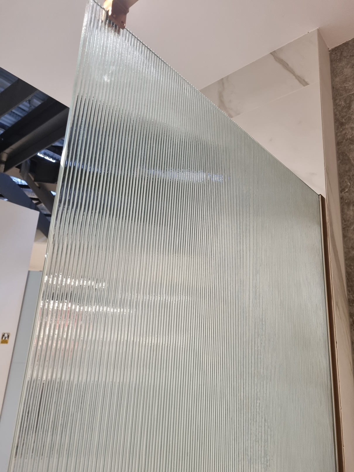

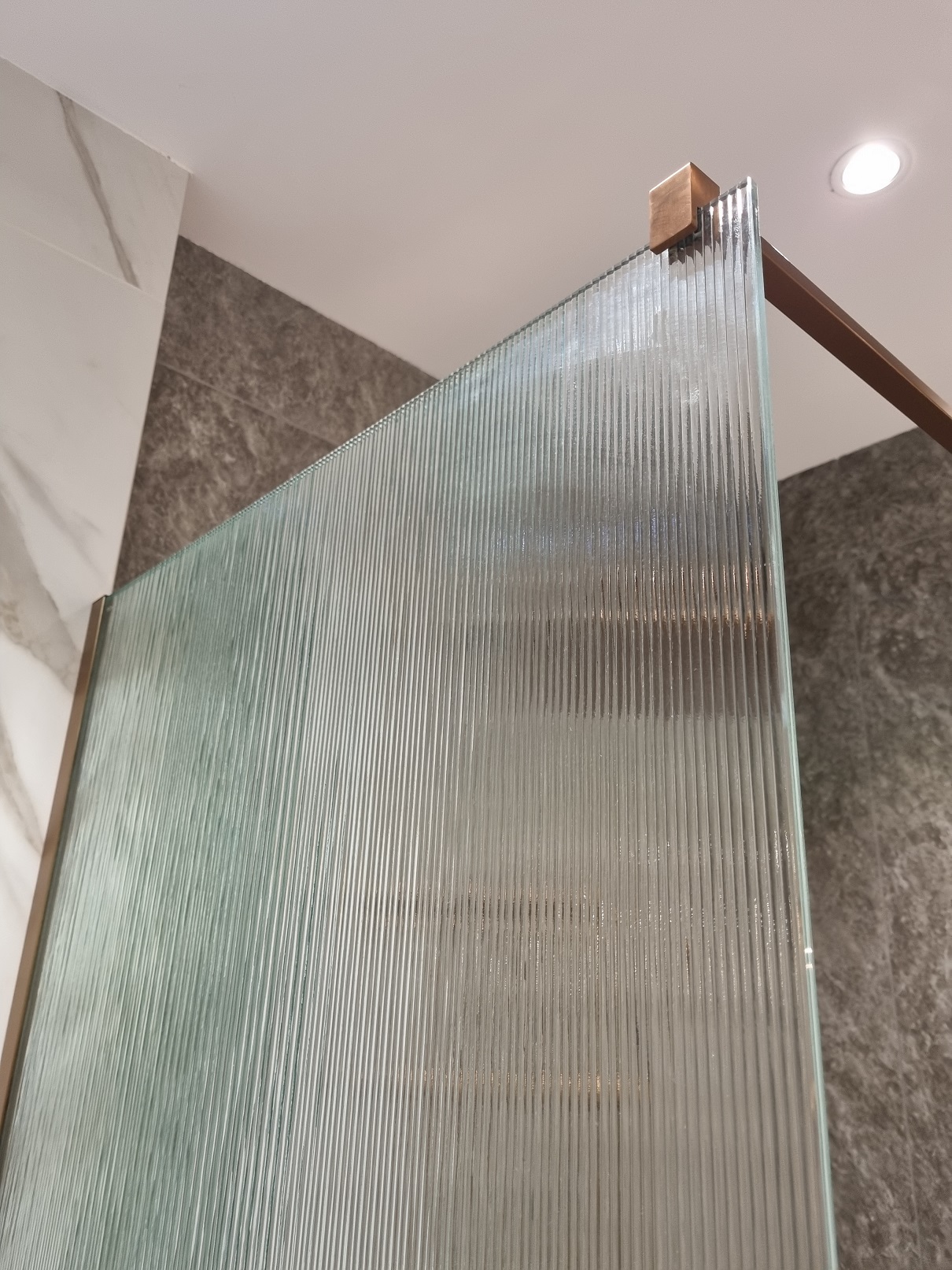

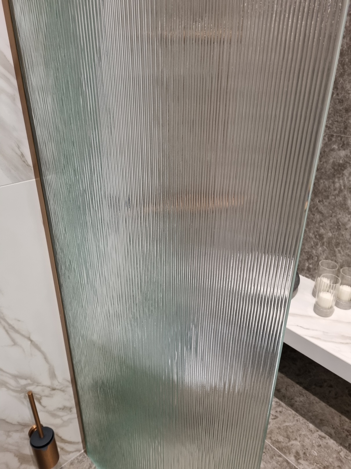

Hello
I'm a hobbyist with this render, I use it in conjunction with SketchUp 2017
As in the subject, please provide instructions on how to make such glass.
Colorless, not completely transparent.
Smooth on one side, visible groove on the other (photos attached)
I really want this similar glass.
Best regards

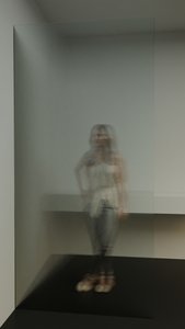

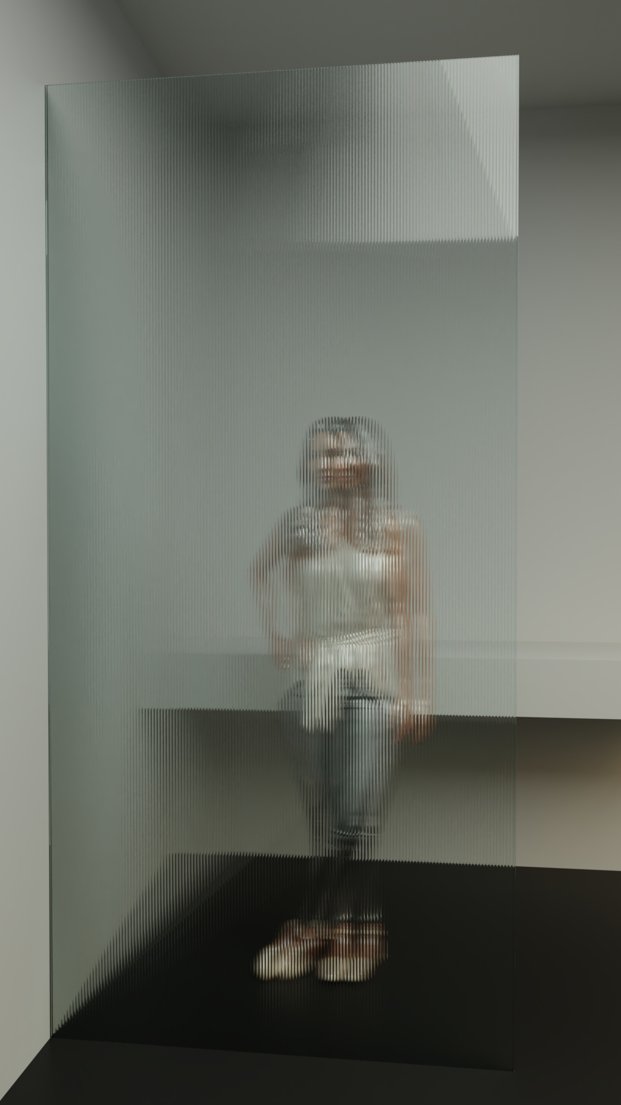

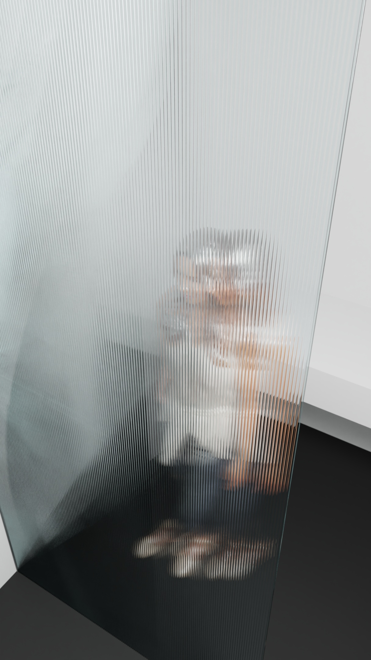

Re: Visiosun Classic glass / flutes glass
Post by pixie » Fri Mar 28, 2025 11:44 pm
bidir test
vs
path tracing on gpu diffuse depth 12

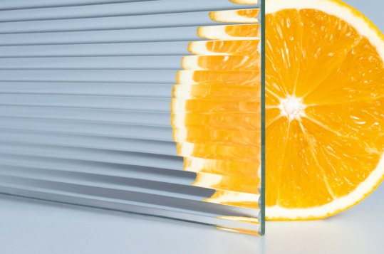

Aha... I thought you could get this effect using a texture?
For testing, I'd like a model measuring 817x2017mm and 8mm thick.
Post by pixie » Sun May 04, 2025 11:47 pm
Indigo is the renderer, I used Cinema4D for modelling. I tried texture, but modelling gave me not only a better result, but smaller memory usage in the end. Once I got the desired effect on 3D, one might create a displacement texture out of it.

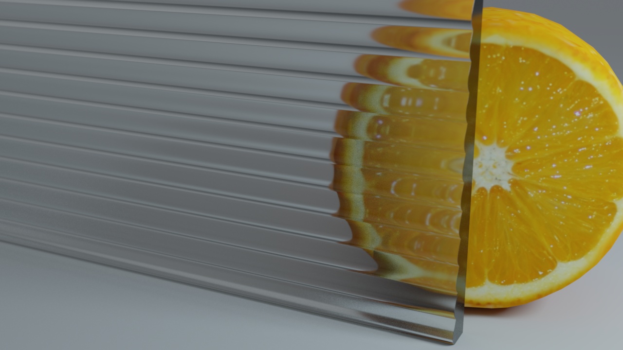

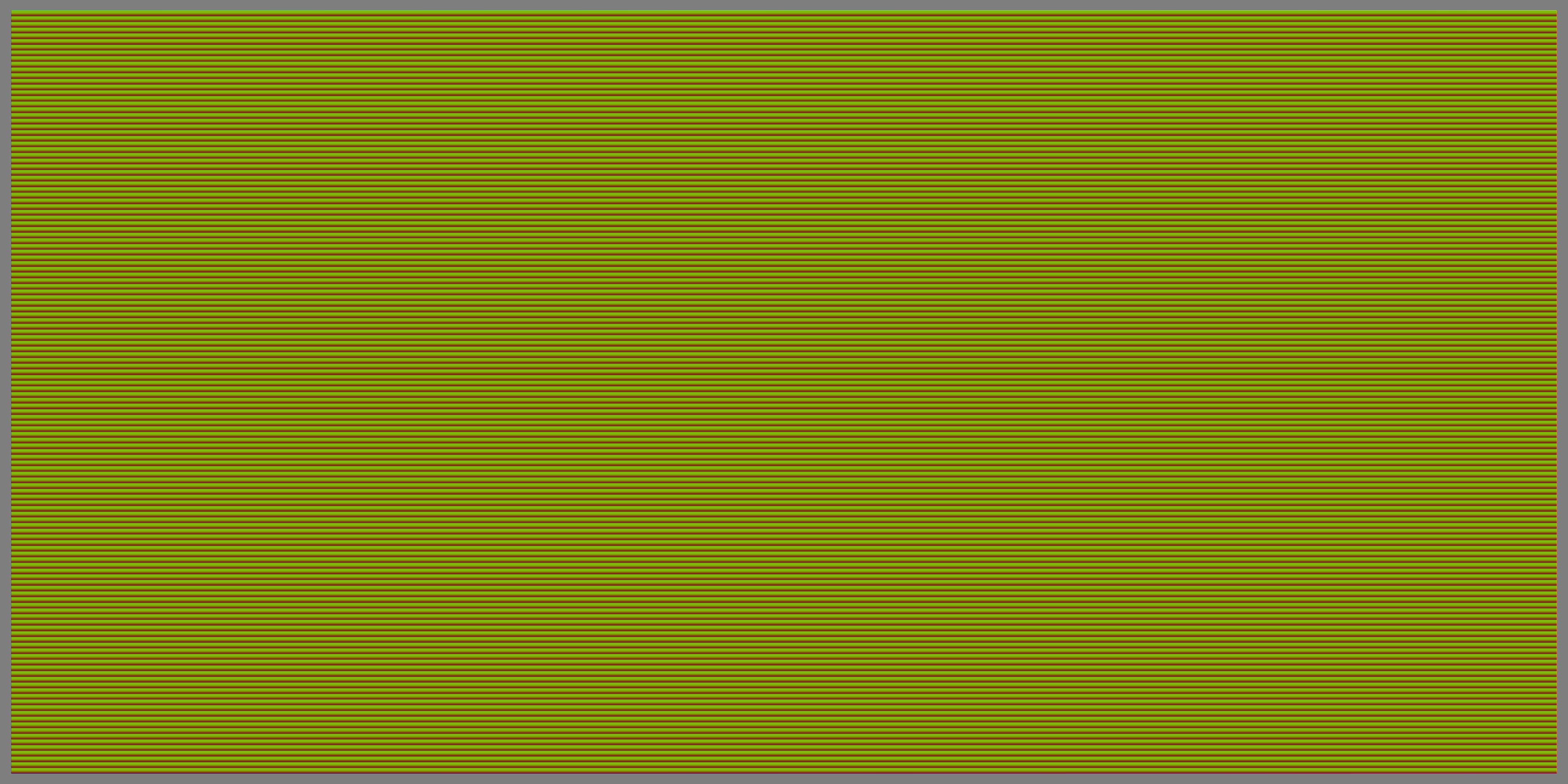

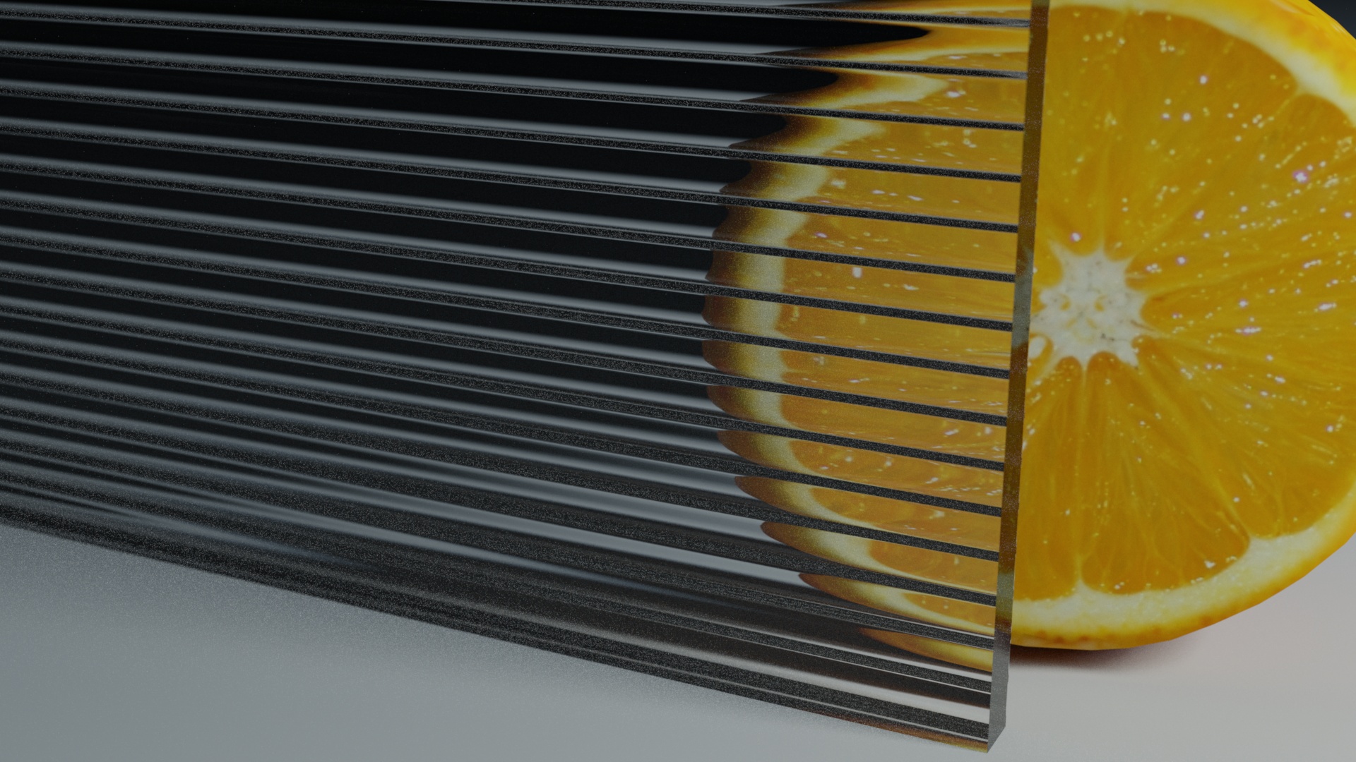

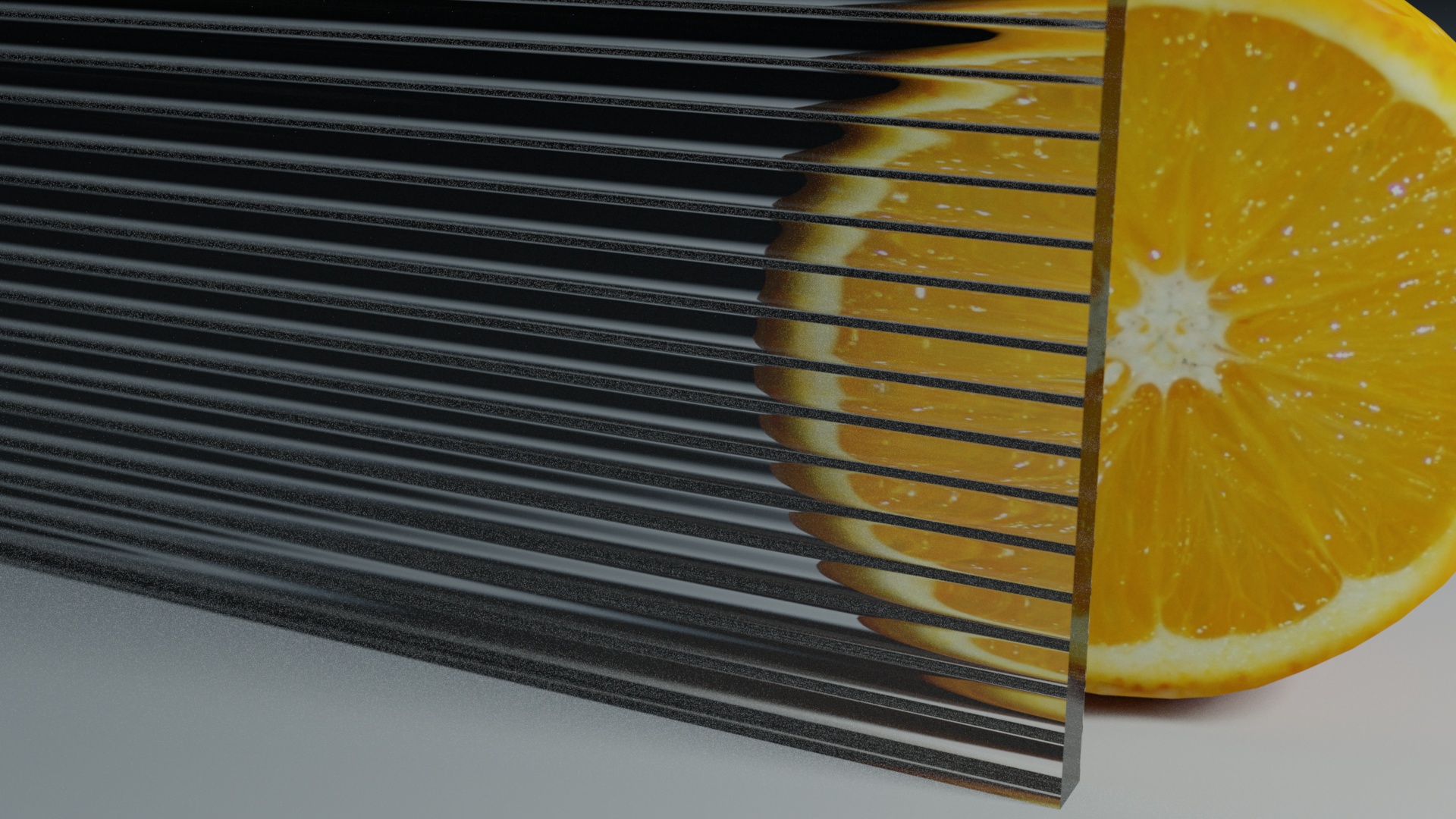

Post by pixie » Tue May 06, 2025 8:29 am
This time I baked the geometry into a normal map, what you see is just a normal map applied to a box. It might be all that you want.
