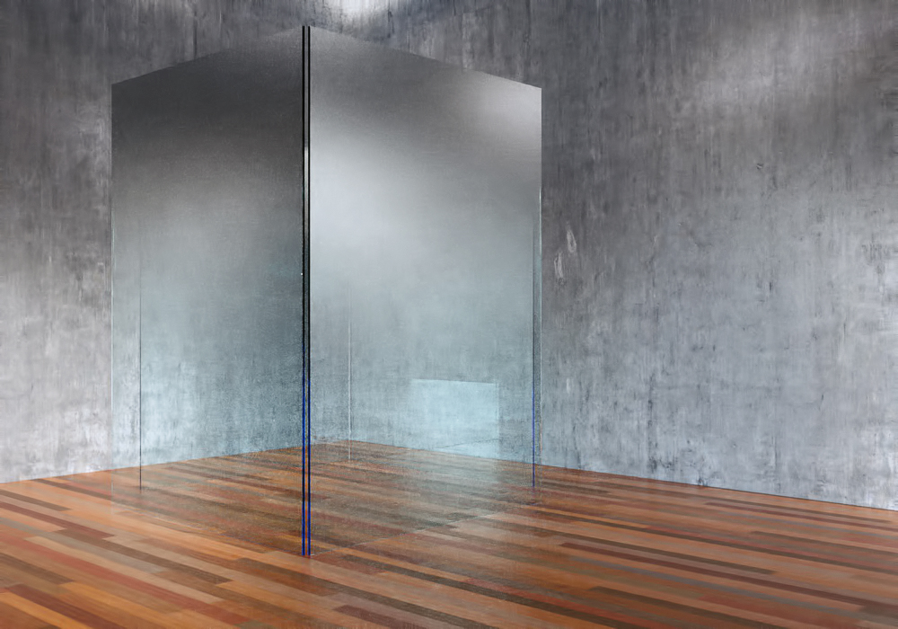

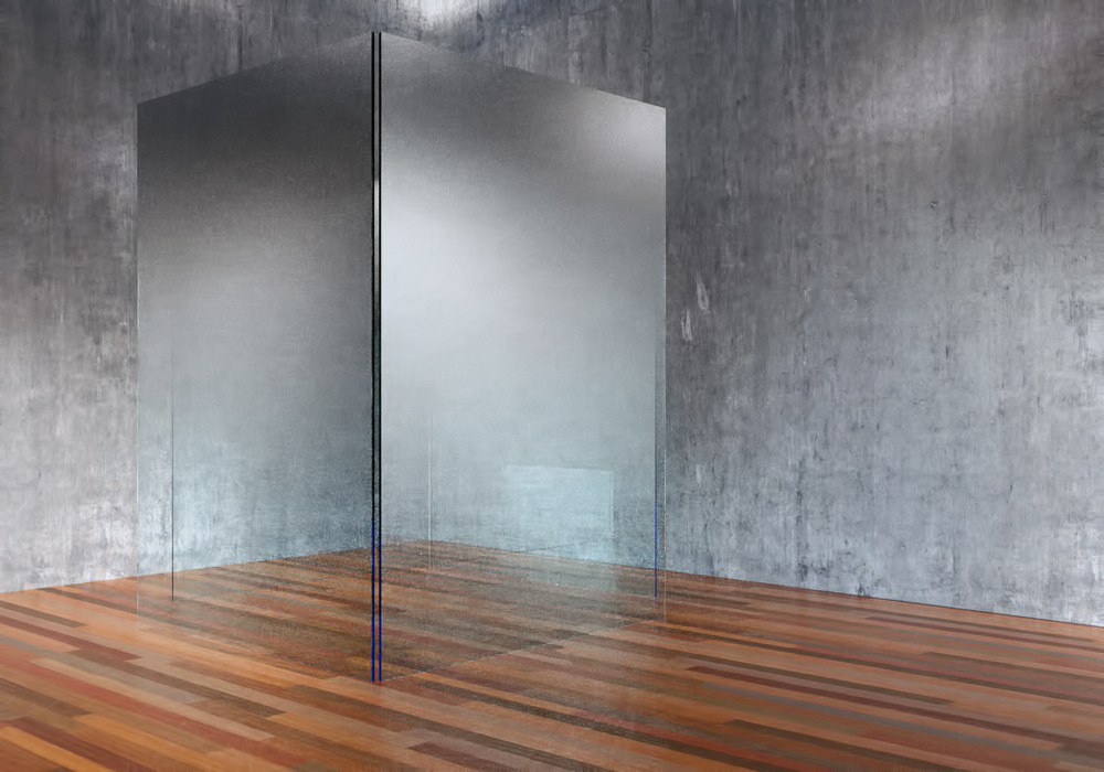

HA! I just did the same. There is only a small difference, it's hard to see, but if you flick between these 2 you can see that the image with gamma 1.0 has more chrome material... but the point of transition seems to be centred, which it probably should be with this map.
If you check the 'smooth' however, the gamma change seems to make no difference
Either way, I think the material is pretty close to the reference image!

In fact, gamma=1.0 gives the exact same amount of chrome and glass. But since reflectance of chrome is high, and of glass is low, the chrome "eats" the visual impression.bubs wrote:HA! I just did the same. There is only a small difference, it's hard to see, but if you flick between these 2 you can see that the image with gamma 1.0 has more chrome material... but the point of transition seems to be centred, which it probably should be with this map.

That's actually what I meant... I was trying to say that the gamma 1.0 had more chrome than the 2.2 version, not more chrome than glass. Sorry that wasn't very clear.galinette wrote:In fact, gamma=1.0 gives the exact same amount of chrome and glass. But since reflectance of chrome is high, and of glass is low, the chrome "eats" the visual impression.

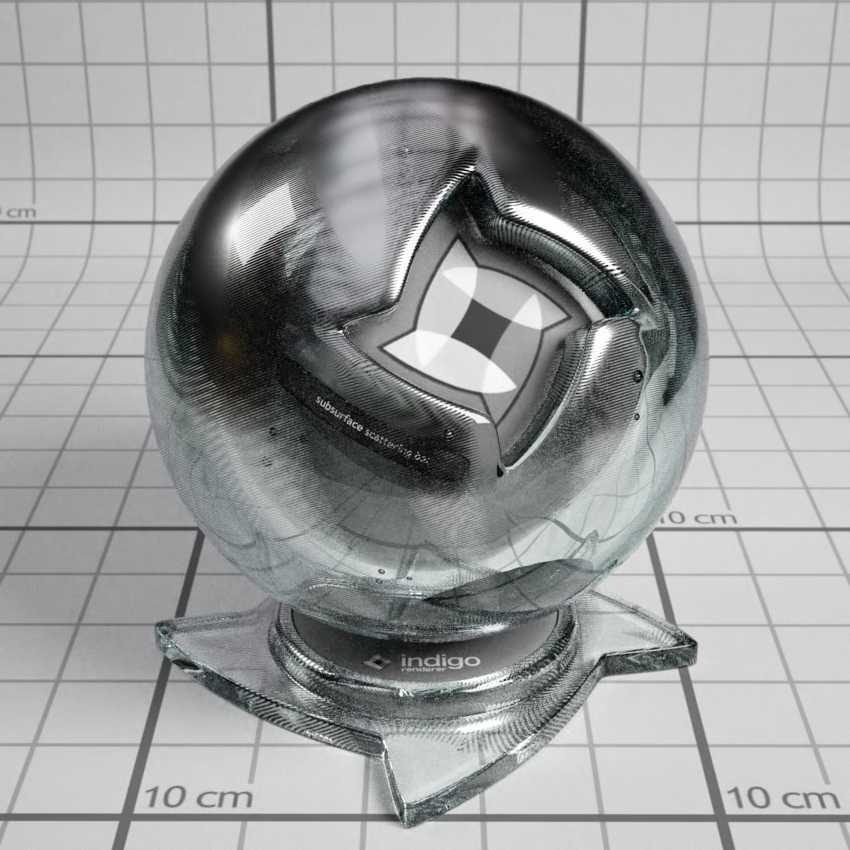

Great! this looks fantastic! You get that wonderful distortion of the light due to the dots.galinette wrote:This one should be OK for you
I have to find some excuse to use this material now!
