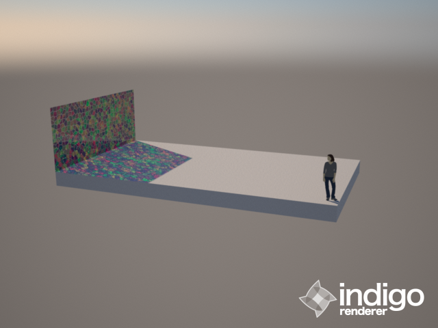

Re: I can't get the Stained Glass material to work properly
This worked with your scene. Apparently, you did not set UV mapping, which is required by the shader. For this, you need to set a placeholder texture image in sketchup material properties (sketchup, not skindigo). Any texture will work, as it will not be displayed in the render, just in sketchup for doing the UV mapping (the texture scaling and position). Sketchup is quite limited regarding UV mapping, and will generate it only if you set a texture image in its material properties.
By the way, there should be a FAQ about how to use linked IGM with UV mapping! This is a frequently asked question!
Here are the steps I did:
- I went to the Plugins>Skindigo>Material Editor. Choosed "Stained Glass" from the material list. Clicked on "UI" to enable the material type and choose "Linked IGM". It was not set as linked IGM when I opened your file, but apparently you tried it already.
- Then, I select the igm (or pigm) file link. Skindigo asks me if I want to set a texture (the placeholder texture) and I say yes. You could also do this manually later in the sketchup material editor dialog, but here we click on Yes. I choose a square texture image, any will do the work.
- In order to scale the stained glass cells, I go the sketchup material editor, in the "edit" pane. My texture was scaled to ten inches by default, I enter "2m" instead, for 2 meters. You can try different scalings.
- Plugins>Skindigo>Render scene
Et voila:
Et voila:
