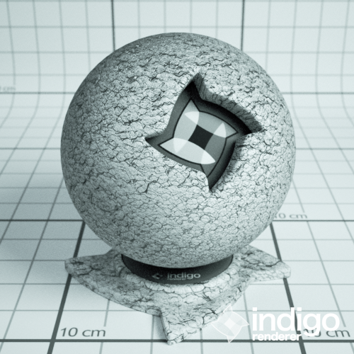

Hi all !
I've trying to render some styrofoam pieces, and I can't make up a decent styrofoam material.
#1 - from scratch
As I understand it, SF is merely a textured and somewhat translucent plastic, so I would go for a textured-bumped (or displaced) phong mat (IOR = 1.59 according to wikipedia) and I would add some translucency or SSS...
... but all my attempts don't come even close ! Does anyone see where I'm wrong ?
#2 - converting a Vray material
I've found a pretty good looking Vray material, and I wonder if there is a way to convert it into indigo material...
I've seen some converting scripts that run into 3dMax to convert 3dmax materials <--> Vray materials, but I can't find anything similar for indigo... It must be doable since Maxigo can load Vray materials !
Anyone has reached a solution to this issue ?
My best attempt... Not convinced.

Use a constant (RGB) albedo to start with, the shades on the material are not realistic. The right bump value would be an extremely subtle one.

The 1.59 IOR is for plain dense polystyren
But as a foam this makes things somewhat more complex.
I would try much lower effective IOR as a start, with low exponent, and a very subtle bump (around 1E-4 scale)

I did a simple one here:
http://www.indigorenderer.com/materials/materials/1113
Not easy to do with SSS, as this the surface is very diffuse.

galinette wrote:I did a simple one here:
That pretty well nails it! I was going to suggest: it looks like it's all in the bump. No obvious SSS in the Vray shader, not to my eye, anyway. The color stays consistent unless you want to accent it with a few slight imperfections. The subtle bump mapping seems to be what makes the texture come alive.
:shock: That's pretty impressive ! It looks like Oren-Nayar and phong are working well provided a finely tuned bump... Again, sorry for my obsession with SSS (I did it on the ceramic material already), the magic can happen with precisely crafted "standard" materials !
Merci beaucoup Etienne ! :D

Your material renders have a very purple tint to them though. Can you please use the default material preview scene, with all its settings?

Post by galinette » Fri Oct 26, 2012 4:38 am
Hi Ono,
Actually I used the default scene in Indigo, but I had to switch to linear TM and lower the gain, otherwise you could not see any texture details, the default scene being too bright for white materials.
This resulted in a greenish tint on my screen, I changed the WB to D55 which was more neutral. But my monitor being old and yellowish, it's clearly blue on a calibrated one.
The scene definitely needs some real corresponding emitter/WB definition.. This way you will have pure grays (ie R=G=B) and any tint complaint will be due to monitors only...
