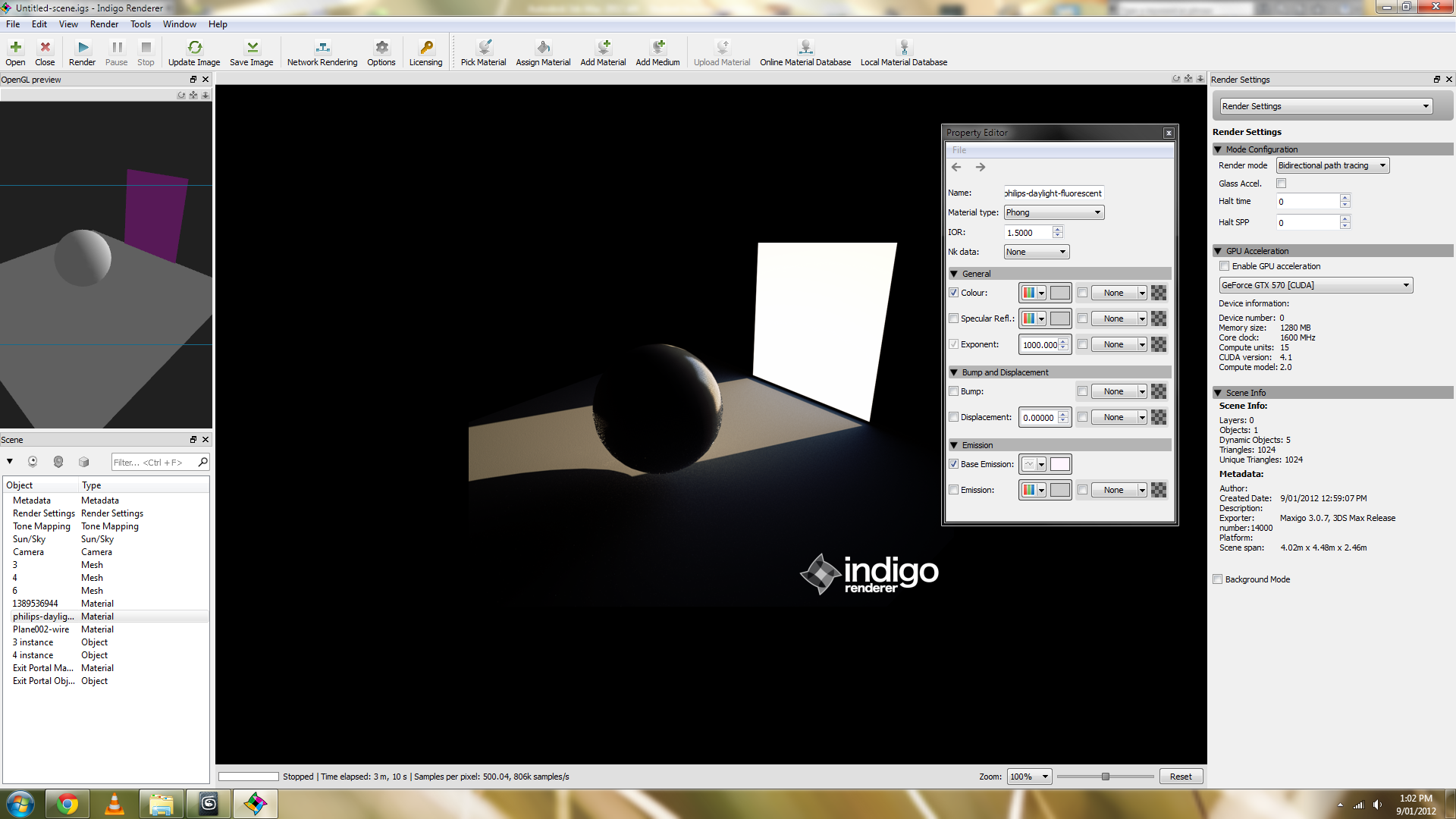

Anyway the file now opens without the weird error, the only issue is it doesnt seem to be emitting any light.
I figured maybe the demo scene was too bright to see the effect, so I made a quick dark scene and tested the material again.
And this is what i got.

Post by CTZn » Tue Jan 10, 2012 2:10 am
The mesh plane you are using as emitter is in fact an exit portal. We can see the sky reflecting on the sphere. A geometry with the exit portal tag will ignore any material applied. An exit portal is a "conductor" for the environment used. That is, an exclusive door for the env light, ignoring all obstacles between.
In the other hand it is common for emitting materials to be too weak by default under a sunlight situation, in wich case their base emission (ideally, the emission scale wich should be available from the exporter) must be increased until a satisfying result is produced.
Please state the applications versions that you are using (3d host application, exporter), eventually you will get more specific answers from users for the next points.
