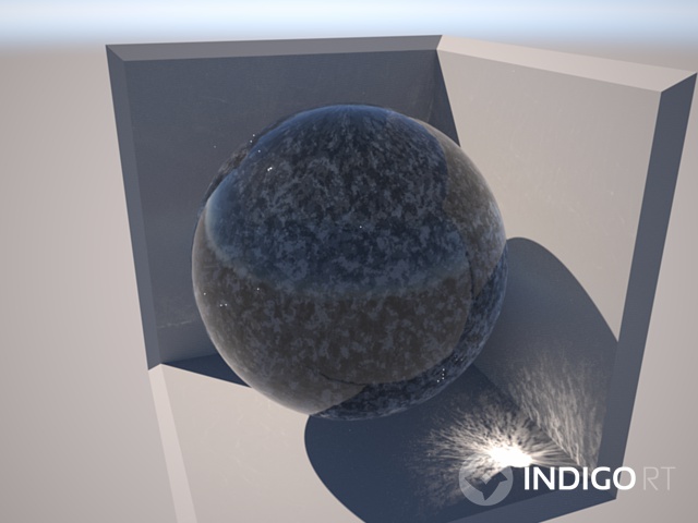

For some time unsuccesfully I've been trying to create realistic grass material for my scenes. I mean realistic in terms of enviroment reflections. Every IOR value in normal range (1-2.5) I've been been setting for the material was resulting mostly in lack of reflections from enviroment, so I've started using higher IOR (6-12) values to match my reference photos.
I couldn't figure out why is that happening because simple materials like wood with just Phong shader, texture and bump were looking good without tuning IOR too much.
Just yesterday I've decided to spend some time to check how simple material reflection will match blended and double blended material reflection - It didn't lol ;)
So I suppose blending materials together results in reduction of reflectiveness by the factor of blending and to achieve same strength of reflection with blended materials we should adjust IOR value accordingly.
After couple minutes I've figured those adjustments with random easy to calculate values.
Blended_Material_IOR = Desired_IOR_Value / Blending_factor
So like on the attached picture we need to set 2.64/0.33 = IOR 8 for our blended material to match simple phong material with IOR 2.64 in terms of reflection strength.
Is it correct to use similar calculations to adjust Phong IOR in double blended material? Does it makes sense? How is actually material blending solved in indigo?
I've tested IOR values calculated this way on a double blended grass material and it looks quite close to reference photos I had so it seems like such adjustment might be actually correct. Is it?

I have only a simplistic answer for you, I'm hoping that someone else will be more specific regarding your questions:
The amount of light that is transmitted is not taking part to the reflections. It is expected that those transmitted rays will weaken the overall reflections because by definition they are not contributing to them.
Did you try with a somewhat higher exponent to compensate (x2 or so)? The amount of light reflected will be the same for a constant IOR, but the grass blades will be shinier (less glossy). My personal feeling is that the highlights are spreading too wide and therefore are dimming the impression from reflections.

CTZn wrote:The amount of light that is transmitted is not taking part to the reflections. It is expected that those transmitted rays will weaken the overall reflections because by definition they are not contributing to them.Did you try with a somewhat higher exponent to compensate (x2 or so)? The amount of light reflected will be the same for a constant IOR, but the grass blades will be shinier (less glossy). My personal feeling is that the highlights are spreading too wide and therefore are dimming the impression from reflections.
Hi and thanks for reply!
I've been trying to fiddle with exponent at the beginning but it doesn't compensate for the loss of reflection with blended material that well. I mean when using small value for index of refraction (1.2-1.6) on actual grass material increased exponent value causes change of the amount of those really shiny reflections. Lower exp value was giving slightly higher number (like a soft reflection but spread to the particular strands) of "blinks" on the grass and higher values were decreasing number (and size slightly) of those blinks on a particular grass surface. Anyways it didn't behave realistically, although it looked like it sometimes and under certain camera/sun angles.
I'm looking to figure out approximately accurate grass material which behaves good under most commonly used lighting condition, I don't mind increased rendering time at the moment just realistic behavior matters for me.

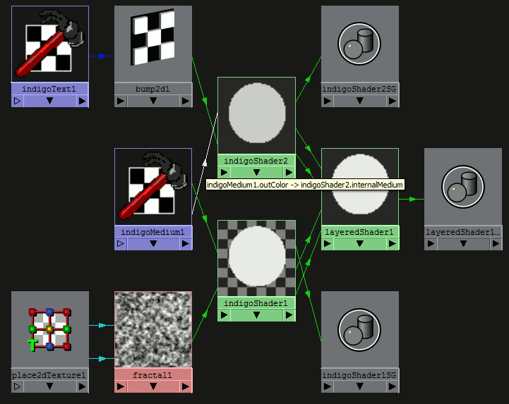

Post by Zom-B » Thu Dec 15, 2011 6:44 pm
lycium wrote:Currently in Indigo you can't blend between two specular materials; this condition may be relaxed in the future when both materials use the same medium.
Isn't blending of two specular mats with same medium (not similar, but same?!) possible since quite some time already???
Only issue here is that the exporters create a own medium for each material and you need to edit the igs by hand...

Post by CTZn » Sat Dec 17, 2011 12:30 am
Thanks for the heads up Zom-B:
- specular sharing the same medium can be blended indeed.
- there was a bug in MtI's blend code (3.2.2.2).
mti allows multiple materials to use a single medium !
To clarify the images below: one specular has a constant absorbtion layer, the other has no absorbtion layer.
The blend parameter is 'fractal1'
