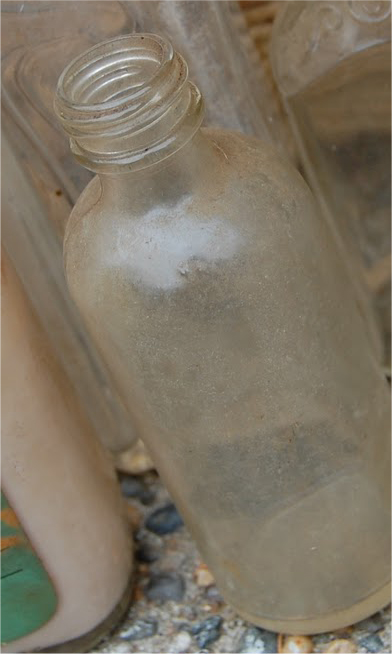

ok i did it the glass become almost disappear.But here is what i want actually.For example u buy a new glass with 1.7 IOR and then after some days glass become old now the IOR is same 1.7 but specular highlights become low means its less shiny with same IOR.Thats what i want.

Example:

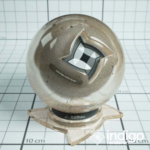

Here is a first try

galinette wrote:Here is a first try
Cool dude :D
But still look quite new:)
I will upload my tries also

This material is looking good but not as old as in real pic. Anyway thanks for that :D

Effect in the real pic clearly comes from the fact that the brown rusty color in on the inner side of the bottle. Outer surface is neater, only slightly bumpy. So to reach the effect, you need to combine two materials sharing the same medium.

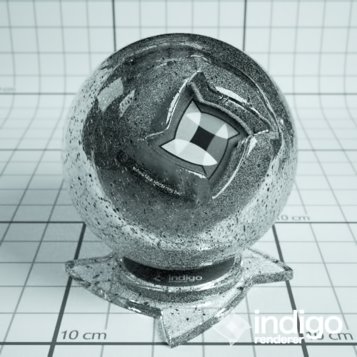

galinette wrote:Effect in the real pic clearly comes from the fact that the brown rusty color in on the inner side of the bottle. Outer surface is neater, only slightly bumpy. So to reach the effect, you need to combine two materials sharing the same medium.
Here is my try which i was working on more then 5 days:
