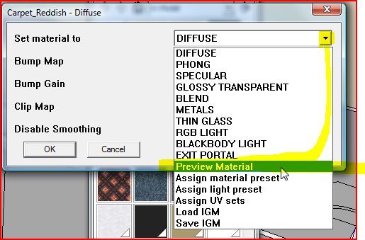

heres where you'll find preview (see image)i had a hard time finding it too.
btw i can't get sss on the milk to work any ideas?
don't worry it dosn't change your material settings.
