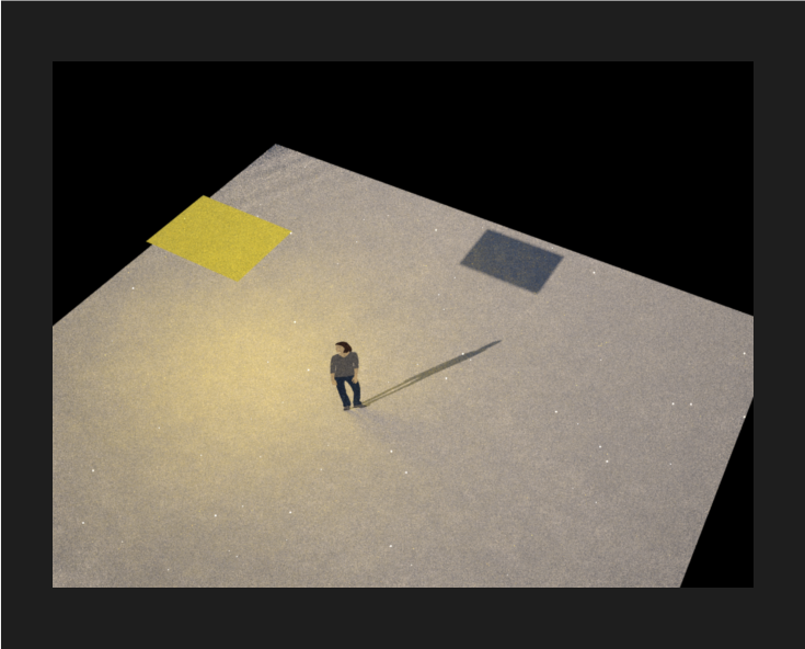

I want to use a illuminating box to imitate directional light. However, when I render the scene, the box is rendered along with its shadow.
Can I make the box and its shadow missing in the rendered result while the lighting from it remains?

If it is just an object within the scene, use 'Pick Object' then check the 'Invisible to Camera' box in the 'Property Editor'

I think what he wants is a light catcher ;)

Please check out the attached image. The yellow quad is used for lighting, however, you may see its shadow casting to the floor. How can I remove the shadow while keep the quad emitting light?
Thank you so much.
p.s. I am using the Indigo RT instead of Indigo Renderer. So please tell me to use the feature that I have. Thank you so much. ^_^

Please view the attached image. I want to make the shadow of the yellow square gone. How do I do that?? (I am using Indigo RT)
