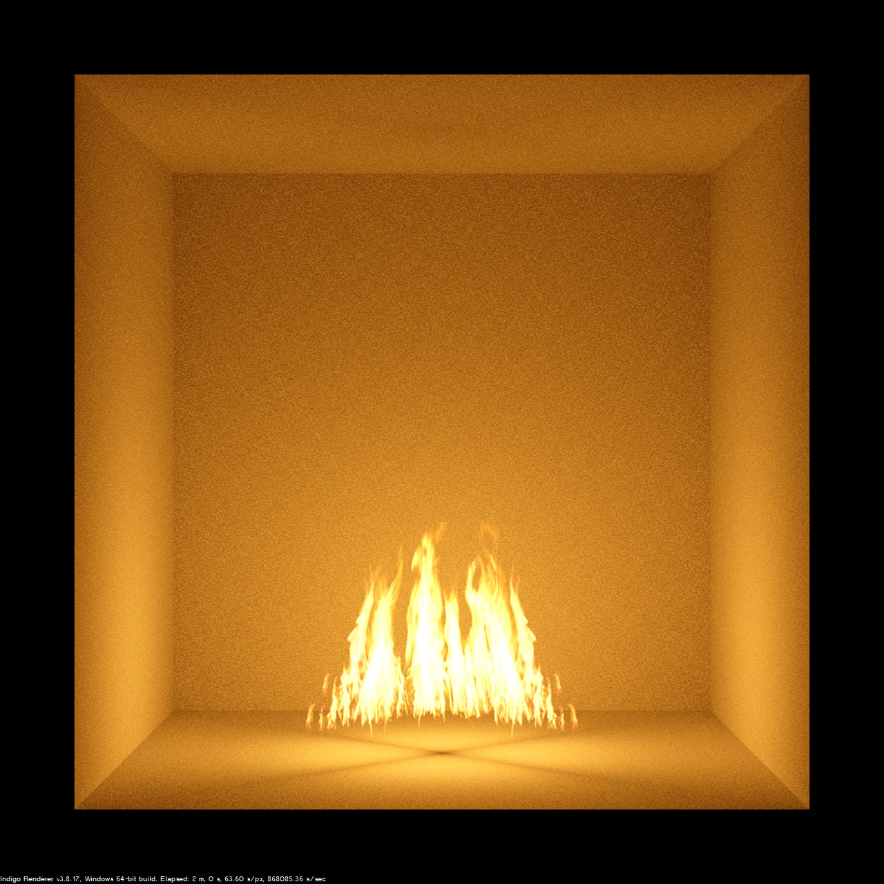

Pibuz wrote:Some tests.
The scene is exactly the same: same objects, same materials (null emitter), same light settings, same resolution. Only thing changing is the subdivision of the flames' mesh, as indicated in the images.
Beware of Indigos SubDiv, since it has some pixel and angle threshold, that can Kick in here very nicely with your straight plane mesh! Use manual SubDiv instead!
Pibuz wrote:The best s/pixels and s/seconds rates are gained in the SUBD.10 test, although I think we get the cleanest result for subd.16.. what do you think?
the s/sec can be ignored absolutely as you can see in my first renderings (I told you to check out the info overlay :P ). without subdiv I get higher s/sec, but way more noise!!
Also render longer (+2min) since the noise clears super slow for none subdived emitter, so the difference is better to see if rendered a little longer!

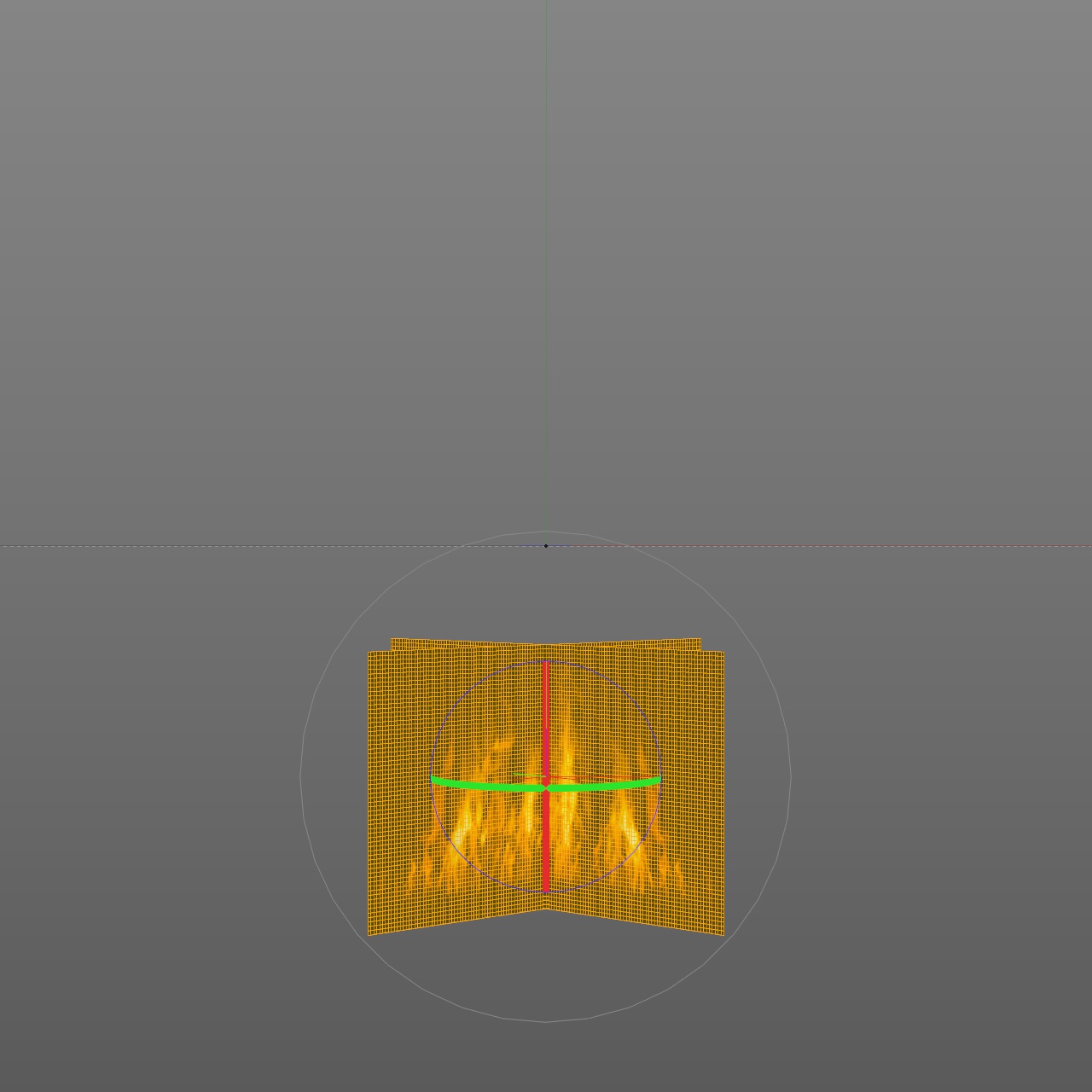

Here you see my subdiv of the mesh:

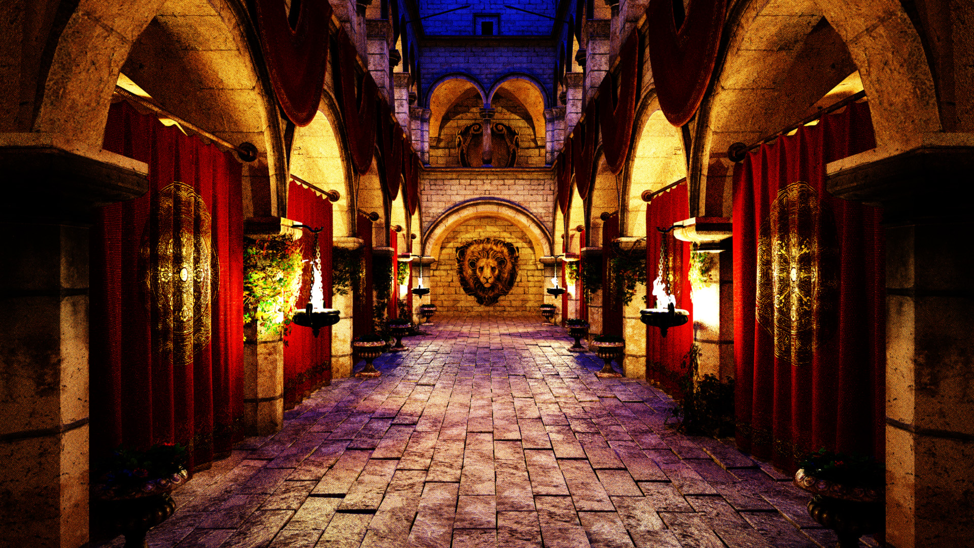

Here an example of a animation frame where such optimizations are game changer, because the most light is from such torches:
