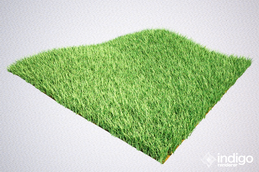

Hey hey,
Not much time now, but I'll explain later. Here is the BLEND file and a rendering of what the result looks like. Very simple, I made this in 2 seconds from scratch. No textures or nothing, just a very simple grass bunch object that I made with curves and a subdivided ground plane that I made wavy to show that it can be applied to any type of terrain. Materials are a simple brown diffuse material for the ground and a simple green Phong material for the grass. Extend this to forests, gravel, rocks, etc. etc. etc.
Feel free to ask for clarification. Hope this helps someone out... It's actually very light, I just did about 6 scenes each with several thousand trees and fields of grass and the packed Indigo files I made for rendering on my quad are all under 60 Mb with all the textures and everything. Not bad! Makes it very easy to swap around on a USB shtick.
Have at it!
Have at it!

- Posts: 1828
Re: Le Grass
H'ok.
- Objects must be rotated 90 degrees in the Y axis for them to stand up straight on your grass. (RotY = 90)
- Over in the Extras panel you can set the size (1.00 means it is whatever size the actual instanced object is, you can play with that, though)
- Right below that is the field for changing the size randomly (very useful, I keep it between 0.3 and 0.6)
- In the Physics panel: Rotation is set to Normal, Randomize Phase is set to 1.0 (right next to Phase, NOT where it says Random right below Dynamic). This randomizes the rotation of the grass. It is this and the random rotation and placement that make it possible to make fields of grass that doesn't tile from a simple grass bunch model.
- Velocities are all at 0, don't need them.
- Make sure to enable the Emitter button so that it renders the ground plane, unless you're using a duplicated ground plane to control your particles, which may or may not be good practice.
Questions/comments?
Questions/comments?

- Posts: 1828
Re: Le Grass
Ah yes, forgot about that: Size and Density painting works fairly well, though it is useful to increase the resolution of your mesh so that you can get smoother gradients of change.

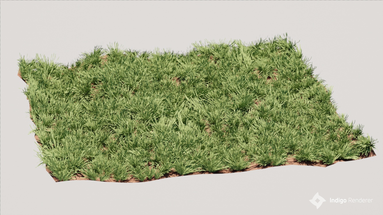

Re: Le Grass
This is Now. Just render.
(500 objects w/ 80 childs)
Blender 2.93.3 LTS, Blendigo Exporter 4.3.3., Indigo Renderer 4.6

Re: Le Grass
As mentioned, with Blender & Blendigo exporter. Scene file is attached.
About 3DS Max, I wouldn't know, but you're free to check and report your findings.
