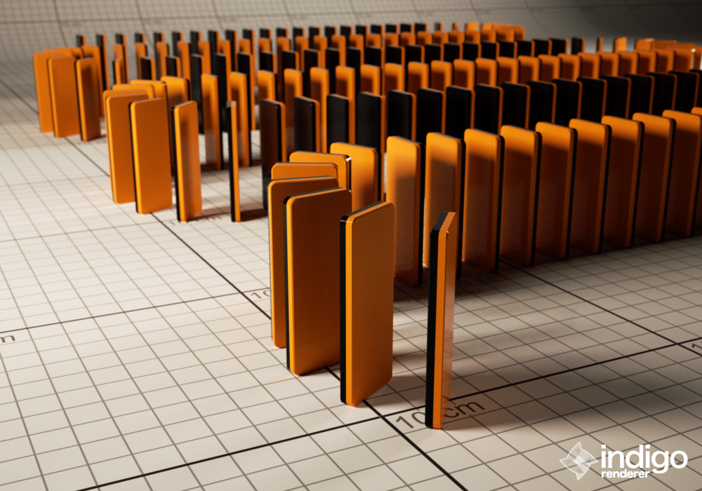

cotty
Posts: 314
Re: How to Export SketchyPhysics Animation
Post by cotty » Wed Mar 09, 2011 8:41 pm
Example of an animation with Sketchup-Indigo-Sketchyphysics:
idea: 1 minute
modelling: 15 minutes
rendering: 119.000 spp :shock:
http://www.youtube.com/watch?v=cZ3TKfDPxVw
Cotty
(Added a picture from the animated setup)

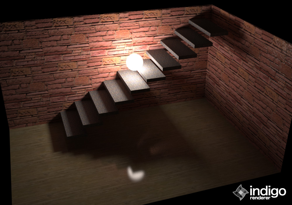

cotty
Posts: 314
Post by cotty » Fri Mar 11, 2011 7:40 pm
Whaat wrote:That is so cool! I wish there were more users who did these sort of animations! Nice and clean, too!
Thanks Whaat, and here is the next one (351.000 spp, days are gone...)
http://www.youtube.com/watch?v=SZ6v7IxWt_Y
ENSLAVER
Posts: 399
Post by ENSLAVER » Fri Mar 11, 2011 8:48 pm
Nice cotty, you should upload the original movie somewhere, youtube + compression kills some of the awesome shadows.
