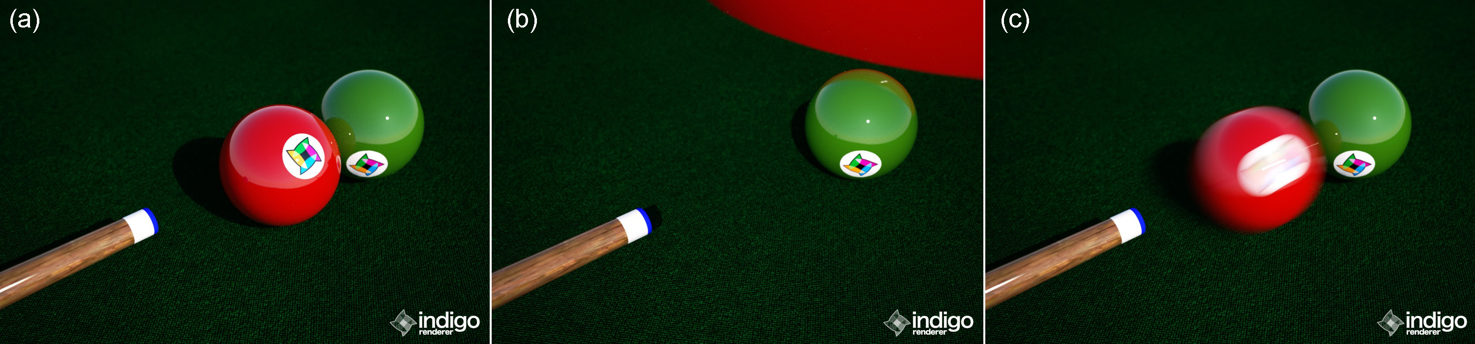

Little test with motion blur. I discovered an error (?) and would like to know if someone had noticed any comparable.
(a) without motion blur
(b) enable instancing -> move to first position -> set keyframe 0.0 -> move to end position -> set keyframe 1.0 -> ERROR?
(c) move to first position -> enable instancing -> set keyframe 0.0 -> move to end position -> set keyframe 1.0

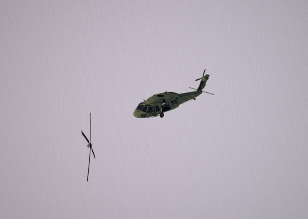

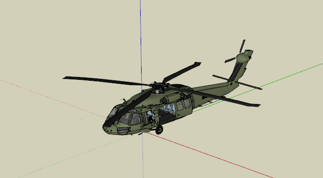

Found my first use for this today. Whaat, you're awesome. It worked great for a small thing but then I tried a few other things and it stopped. The object that should be moving is rendering away from the correct location even though it hasn't moved in the model.
edit: Attached some images. The first is the Sketchup model. Followed your instructions and only rotated the rotors 15 degrees or so. Then when I render...well, you can see what happens. :p

cotty wrote:Little test with motion blur. I discovered an error (?) and would like to know if someone had noticed any comparable.
Cotty
hmmm...possible bug. Thanks for the report!
