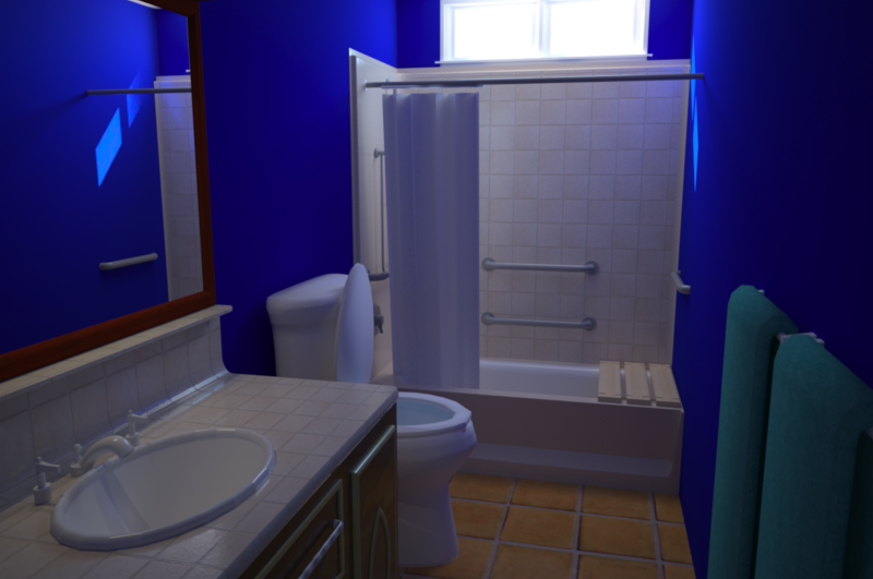

I know there are threads out there and tutorials about exit portals but none of which really explain how to get the results you want. Or they are in a different Language. So please will anyone tell me what I have to do in sketch up to apply one correctly? and how to apply it in different ways to change the results? So far every time I have tried The window turns completely white. While The scene looks amazing, the white from the glass is distracting and yes I have gone in to violet and adjusted it but its still to much. Please, if you have a 40-60 post count don't come in here and tell me that there are other threads on this subject I understand that and have searched the forums tons of times and have read tutorials. My work place does not have 3DMax or anything of that nature. I do at home but what I do there is on my own time. Thanks in advance. Here are some scenes to show you what I'm talking about.

Bathroom scene

NOTE* the last scene rendered for only a few hours hence the noise.

Sorry for those who will be offended by the spam.... but I have been struggling with this for so long If anyone could help in anyway, I could even upload the model space for you to work with and anything helps.
I have worked with all of these images in Violet already.
