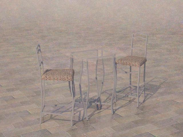

xrok1
Posts: 287
Post by xrok1 » Sat Jan 12, 2008 10:50 am
what about the fog checkbox in SK. it does render fog in Indigo, how about attaching some settings to it in Skindigo Whaat?

xrok1
Posts: 287
Post by xrok1 » Sat Jan 12, 2008 12:55 pm
here's SK fog. sorry Whaat i found the settings.
With fog 1 hr. render MLT
Without fog 1 hr. render MLT

Post by pxl666 » Sat Jan 12, 2008 8:22 pm
but is this a scene put into a "box of fog" or is it a scene rendered with fog switch ON? im a blendigo user and i didnt find any fog switch - is there any way to turn it ON in blendigo?
Post by Kram1032 » Sun Jan 13, 2008 2:21 am
@pxl666
That switch simply auto-generates a huge fog box ;)
So, you can do it yourself :P
