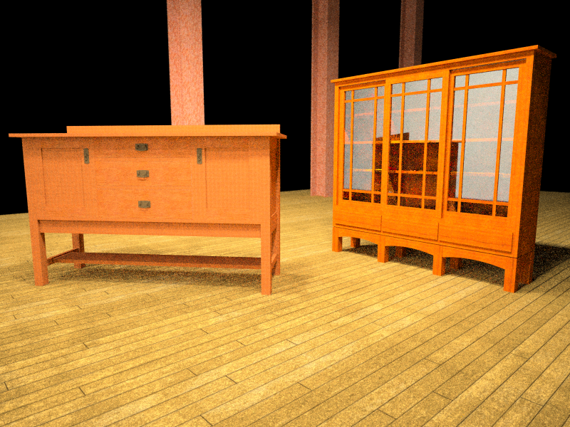

I got to poking around and discovered I had no "render's" directory. I made one and tried again. It seemed to work correctly then.
I got this after 10 minutes or so. Not perfect but I'm getting something.
