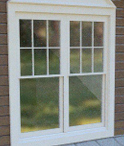

You can clearly see nice reflections and also inside the room (diagonal line)
Thin Glass Close.jpg (32.71 KiB) Viewed 19634 times
All windows are one-sided glass (Thin Glass)
Thin Glass Test.jpg (107.01 KiB) Viewed 19633 times
Thin Glass on the left, 1/4" thick Specular material glass (IOR 1.52) on the right.
Thin Glass Compare.JPG (186.54 KiB) Viewed 19634 times
Post by OnoSendai » Fri May 18, 2007 2:46 am
The problem is is that it doesn't follow Frensel's equations - higher reflectivity at grazing angles.
Post by Kram1032 » Fri May 18, 2007 3:02 am
not bad... but a "black-to-transparent" would be even better...
All the darkening would change to transparency.
Then, you'd get "glass" without "caustics".
--> basically JUST an invisible thing, that has few reflections, to get visible...
I could simulate that, I guess... let's see..
also the things behind the glass wall wont look different, by IoR.
I'll make a quick test, mom
Whaat
Posts: 1827
Location: Canada
Post by Whaat » Fri May 18, 2007 3:47 am
OnoSendai wrote:The problem is is that it doesn't follow Frensel's equations - higher reflectivity at grazing angles.
That's true, it doesn't account for Fresnel effects. However, you can work around this just by changing the blend factor. For example, if your scene has a group of windows that are being viewed at near grazing angle, you could change the blend factor to 0.6 (Sketchup opacity to 60) or even higher to give higher reflection (more Phong, less Null). For windows that are being viewed normal to the plane you could use a different Thin Glass material with a blend factor of 0.1 or 0.2.
Like I said, this material would only be useful for plane glass windows. It might help fill the void of a true Architectural glass material for the time being.... :) :)

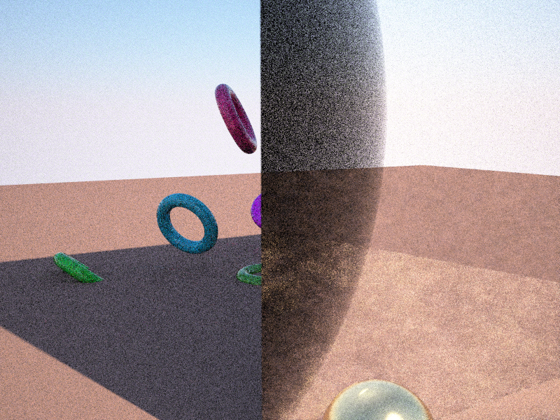

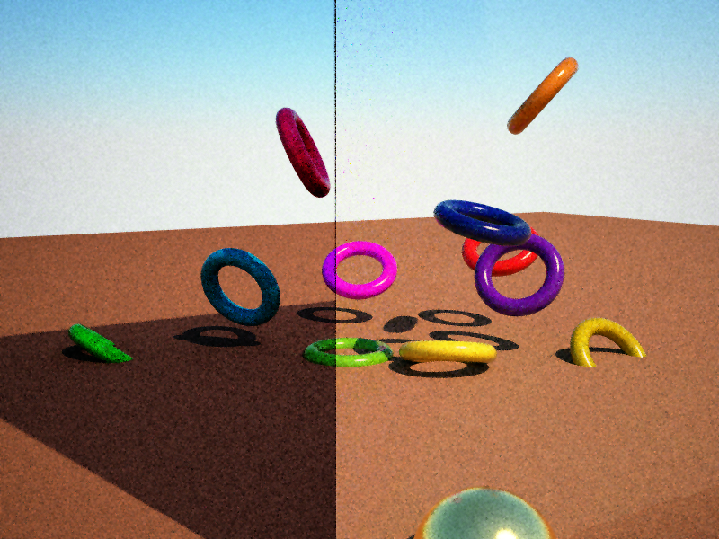

ok... I did a test now, but it has three problems:
1) It's postprocess and I really can't use the lasso tool.
2) It's post process, so I wasn't able to find the right way to blend it.
2a) You can't really see the reflection part :S
3) It's post process, so the shadows on the other side of the mirror don't show up. They should come through the transparent part.
That's why I also put in the two original renders and the modified version of the first render (that one with mirror)
GIMPed
Whaat
Posts: 1827
Location: Canada
Post by Whaat » Fri May 18, 2007 4:27 am
Sorry, Kram, but I don't know what you are trying to show. I don't see anything that resembles a realistic glass material (which is the main topic of discussion) :?
Post by Kram1032 » Fri May 18, 2007 4:39 am
I know...
My problem is, that my skills in both PS and GIMP aren't too good, otherwise, I could show much better, what I mean.
Ok... I'll try, to tell you, how it's supposed to be:
pic 1 (from top to bottom) is the pure render without the mirror.
pic 3 is the pure render WITh mirror.
pic 2 is the same pic as 3, but the mirror part has removed blacks (which has two issues: a) I had to use the lasso in Gimp, b) as it's not a pre process, but a post process, it removed ALL the dark parts, even where it would have been required)
pic 4 is the very bad result of not knowing, how to blend correct. :?
But if you look carefully, you can see, that there is a brightness difference in the mirror part...
Ok, I found a way, to at least DESCRIPE, what I want:
look at the thinglassphere: it's partly milky. If there was a way, to filter the colour of the specular, to be "clear", two things would fall away: the milky appearance and the alpha blend.

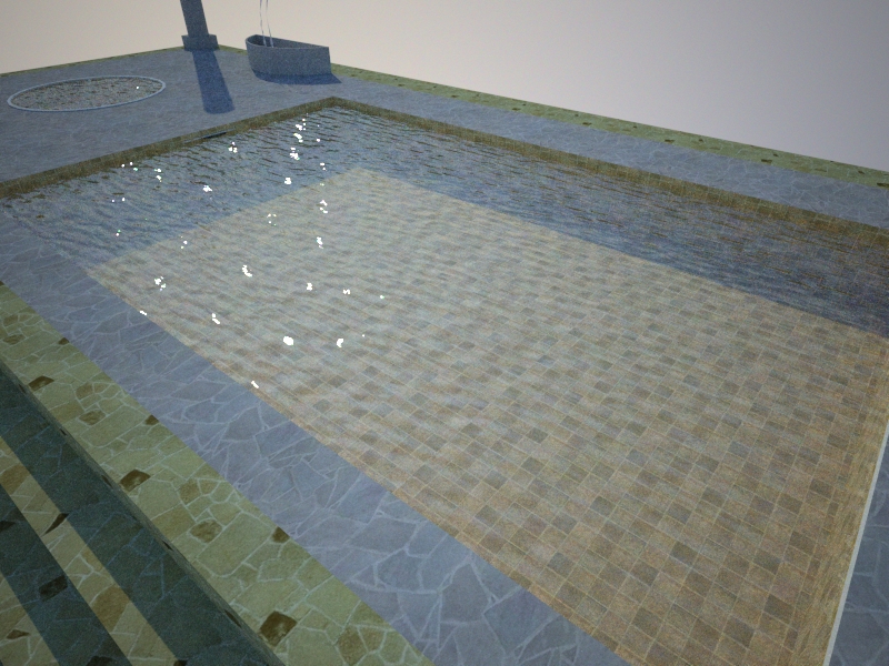

Here is another test. The first image is using the Thin Glass material with a bump map. Only the top surface of the water has been modeled. The white spots are specular reflections of the sun. The second image is of a Specular material with the same bump map settings (IOR=1.33, no absorption). The water is modeled as a volume. The bump map is applied to all six sides of the 'water box' so that may have contributed to the results. Render time for both images was 30 minutes.
Whaat
Specular water
Specular Water.JPG (498.77 KiB) Viewed 19568 times
Thin Glass Water
Thin Glass Water.JPG (413.39 KiB) Viewed 19569 times
