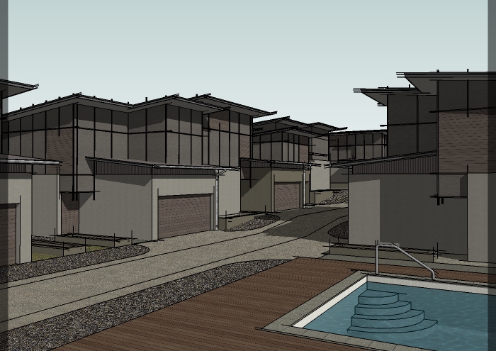

I could obviously be dumb, but!
1. I cant for the life of me now get away from grey surfaced glass no matter what I now do. Seems to give reflection if I don't select glass from the drop down but soon as I do with thickness or not it goes grey!
I tried a glass surface on the pool to replicate water.
2. I cant find any where in the exporter to change the camera shutter speed to adjust exposure of the scene.
3. The sun angle from SU export seems to be way out.
4. Is there anyway to blend materials so I can add aging and varience to apply textures?

Re: Questions 0.7.1 exporter
I am 99% certain you have reversed faces in your water. Check and reverse them with monochrome mode.Richard wrote: 1. I cant for the life of me now get away from grey surfaced glass no matter what I now do. Seems to give reflection if I don't select glass from the drop down but soon as I do with thickness or not it goes grey!

@Richard:
I appreciate your interest in SkIndigo but you will have to do a bit of research and learning on your own. I have spent a lot of time creating a tutorial and explaining the features of SkIndigo in the About SkIndigo menu item. It seems clear that you haven't read the Indigo manual or gone through the tutorial. If you did, you would know that "Glass" is a material preset and "Specular" is an Indigo material type. I know you probably have limited time, but you will have to play around with SkIndigo and read the forums if you want to take full advantage of the software. I try to explain the features as best I can and make the UI as intuitive and efficient as possible. The rest is up to you
re: Violet - Spend some time using it and you will appreciate the advantages.
re: Layered materials - Your brick material is possible to create in SkIndigo but a little hard to explain. If you post the textures, I will show you how to create it the best I can.
re: Loading and Saving materials - I thought you were using SkIndigo 0.7.1 beta (as is the title of your first post...) You can load and save your Indigo materials with this version.

You're probably right there, I opened the manual but mate not one thing made any sense, I'm blonde and a bit dumb for sure!
I haven't read your tutorial and shall undertake that.
Must say though that I'm one of those who installs an application, has a quick play and if I cant get it to do something in the first ten minutes or so I uninstall it and deem it to be a waste of time as intuitive it is not!
I have never read a manual and my first time was with indigo so I must say I gave it a go but seriously I kid you not almost nothing made sense! Lots of techno speak in latin!
The first time I installed Indigo I got a result. Now though it seems the learing curve has much further to go, though the lack of any plain english interpretation for those who have limited render experience will likely make it hard. And again the lack of any known parameters to work between means a LOT of likely trial and error!
I do understand what you are saying I'm lazy, but yep also busy. Apps like maxwell allow for almost out of the box start up and intuitive work flow so as much as I'm looking for an alternative render I probably understand Indigo isn't likely for me!
By the way the plugin I'm using says SKIndigo 0.7.1 (pre-beta release) I cant find any reference to saving out materials! (I promise I'll read the manual and see if there is reference there!). PS (edited) had a look at your tutorial and couldn't find any information on saving out Indigo Materials???
I have to back up Kwisten's comments about the material editor staying up! I would also love to see the first dialogue box extended to incorporate the material settings and those applicable to your Indigo material choice open and the others greyed out. The other beauty and the one that keeps hammering me is that it would be great if the material editor jumped automatically to the current material selection. I keep changing the last selected material from the drop down menu as intuitive thinking and then notice my glass has a brick bump??? dam!
Mate trust me that I'm not trying to be harsh at all just finding the workflow from Indigo so very reminiscent of the maxwell beta days though obviously much more advanced and well underway!
By the way mate what is an exponent map as referred to in your tutorial I saw the option in the plugin?
So mate keep up the good work!

Richard,
I agree that the Indigo manual is not easy reading for most people. It is actually a manual explaining the XML format. However, it does answer a lot of your previous questions. It explains what "Exponent" and "Exponent Maps" are. It also gives the acceptable range of values. It explains the other terminology as well and gives the acceptable range of values. An exponent map varies the roughness (glossiness) across the surface.
Open the material editor and click on the preset dropdown list. There should be two items at the bottom that say "Load IGM" and "Save IGM". This is a new feature and I haven't had the chance to update my tutorial yet. Sorry about that.
I recommend using the context menus for material editing. Just right-click on any object that has a material to edit it. Also, if you have an object selected, open the material editor (setup a shortcut key to open the editor), and the selected object's material will be chosen in the material editor.
I know the UI in SkIndigo could use a lot of work. It is not possible to keep the material editor open without completing rewriting the UI using HTML. I would love to do this someday but it would literally take me weeks or even months to do it alone. I'd probably have to quit my job
