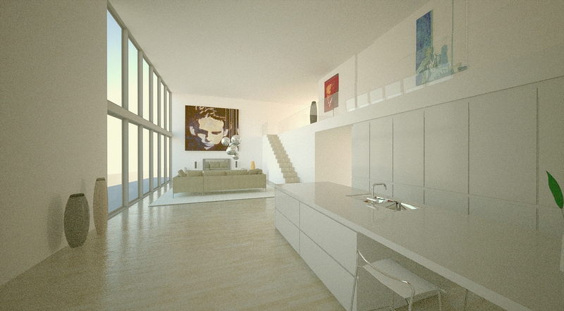

here is a rendering i did with indigo where you can see the trouble i have to get that floor right. I tried brightening the texture in SU but still colour is off and texture is washed out:
render time 12 hours.
Bipt. turned 'off'.
Consec. reys. set to 50 to speed things up.
sofaroom indigo 12 hours klein.jpg (264.68 KiB) Viewed 7135 times
Last edited by kwistenbiebel on Fri Mar 09, 2007 8:04 pm, edited 2 times in total.

As a reference a rendering with 'unbiased' Podium render (3 hours).
The wooden floor looks very different:

@kwistenbiebel: if you want a floor like your podium render don't use a bumpmap, lower the specularity and raise the exponent to 100000. (but i think the floor in the indigo one looks muuuch better and more real)

Bump maps aren't supported in Podium yet. When next release is out (will have bump) i will rerender the scene.
The Podium scene was to demonstrate the floor texture that is used (the colour is close to the colour in sketchup) and to show the amount of detail the texture has (and is lost in the indigo rendering).
i think the details will come when the noise goes :lol:
