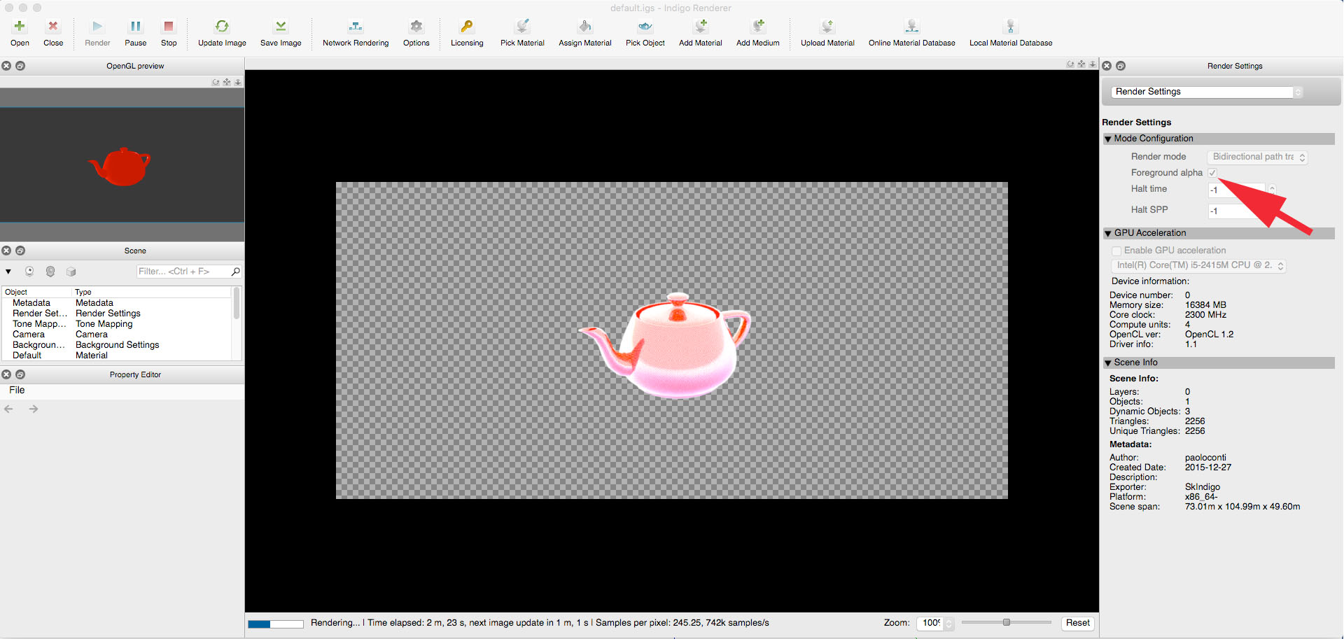

In Skindigo, Render setting, Advanced, checkbox Foreground Alpha, APPLY.
In Indigo gui appear in the image with the bottom squared.

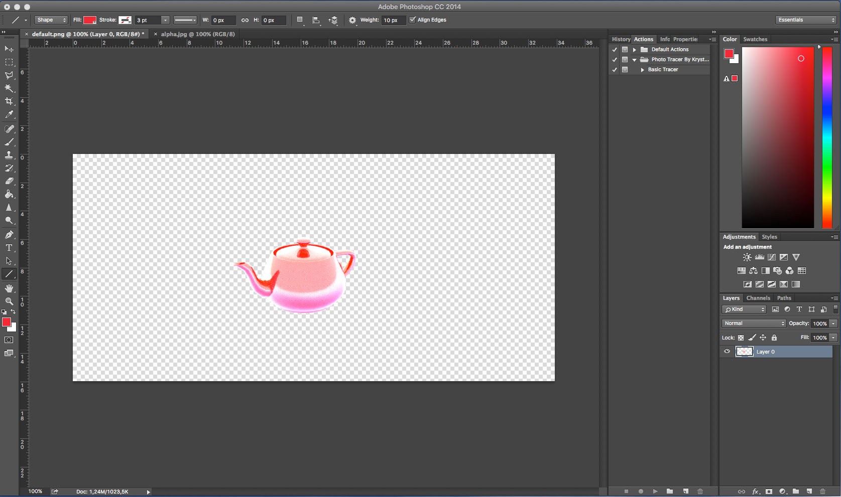

Soooo, just fill that layer inside photoshop over a black background, and create your own. The main thing is that you have your backgroundless image, so you can create whatever you want. And you don't even have to wait for it to sample it to some higher number, since you'll be filling your layer with solid white/black.

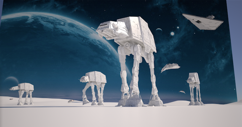

I am attaching an image of my shot as suggested by Oscar J

This is the .png from my renders with the foreground alpha selected. I am trying to get an alpha channel for the walkers only. As you can see, it renders the whole scene. I've tried selecting only the walkers. I've tried deleting the background image entirely. It still renders the entire scene, even when everything but the walkers is deleted! You can see the Sketchup blue sky to the left and right of background. At the very least, that should be a checkerboard.

OK, it would seem to me there's more than one issue here. Firstly the alpha of the walkers will never work with an image behind it within sketchup, because that image is applied to actual geometry, and so will render as an object... The only things indigo will ignore are true background items, ie sketchup sun and sky or an environment map background.
Your second problem is the one of indigo still rendering things you have deleted (trying to solve the original problem). This is a bit more perplexing... Do you by any chance have everything grouped or as a component? There are ongoing issues within skindigo of changes made to grouped or component items' textures not applying if they.have been previously exported to indigo (I suspect something wrong with the quick export that was implemented but have never had this confirmed). Although I have to say I do not recall it happening with anything other than textures... Anyway, if you DO have everything grouped or as a component, try exploding and (if necessary) regrouping, this is the only work around I have found to sort the texture issue and something similar might be at play here... Best of luck!
